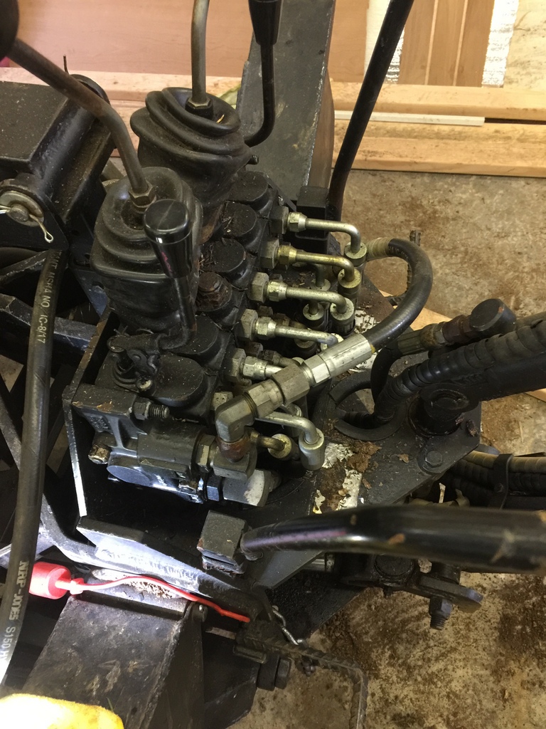

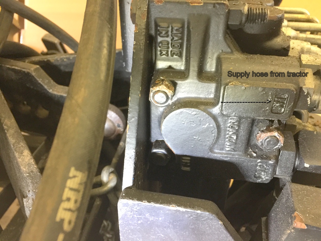

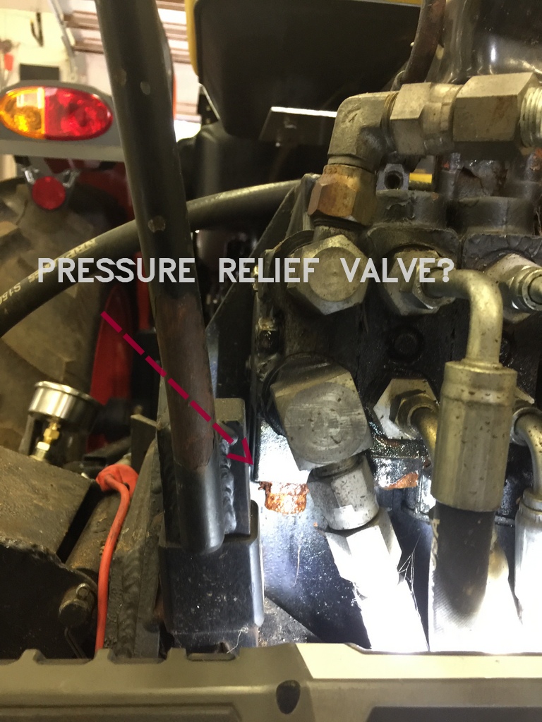

2. The manual for the backhoe states the pressure relief valve is adjusted by 'Removing the acorn nut and using a screwdriver' which is how my last tractor was setup. I do not see such a
device, so am asking if the device sticking down under the 'end block' is the pressure relief adjustment? If it is, does this look like a shim style or screw adjustable type?

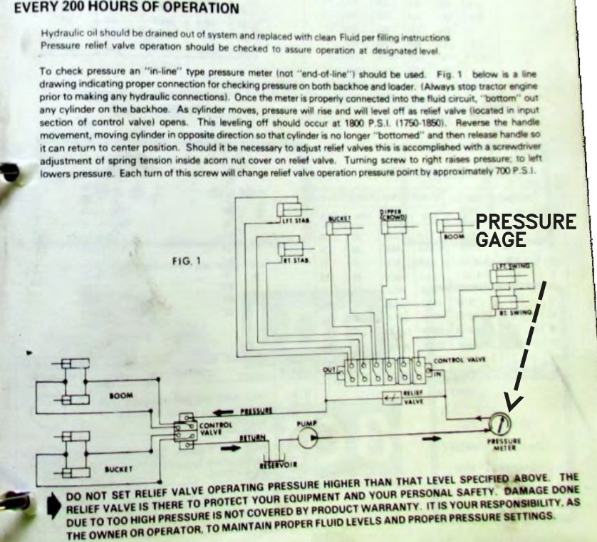

3. I hooked up a pressure gauge as shown in the schematic, but am confused by the results. Detent valve off, I have zero pressure. Detent valve engaged, but no implement operation- I
have 300 PSI. Operate backhoe to initiate pressure relief and I have 2000 PSI.
a. I am confused by the 300 PSI reading, as I thought a deadhead condition was being created with the valve engaged, but no operation of the attached implement- thus the rise in fluid
temperature. Does this number look right? What am I missing?
b. The 2000 PSI value exceeds the manual spec of 1850 PSI, but I intend to leave it alone unless others disagree. Do you see any issues with leaving it at 2000 PSI (8% high)?

Do you have the detent valve feeding the backhoe? If there is something connected to the detent valve's out and in ports then the detent valve can't deadhead. The thing that's connected to it could though. Or you can bottom out a cylinder like the directions state.
The 300 psi you're seeing with all the BH valves in neutral would be from the resistance of pumping through the BH's valve stack and the associated hoses. Seems high but I've not seen a number for that before.
