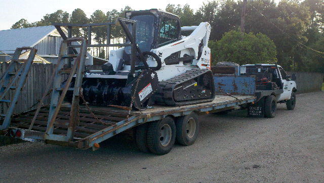

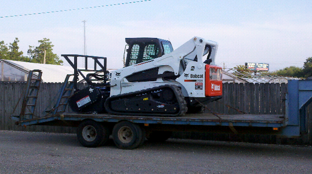

My local bobcat dealer wants me to demo a t870 before I decide on a machine. I know one thing I love bout it already is the cab nice size have leg room an most important have plenty of room for my nuts. Wished they would have widened the cab on the cat 299d. Ill fill y'all in tomorrow on the performance.

Well got to spend little over 8 hrs in the seat of the 870. An it don't feel like it, after 8 hrs in the 297c I just bout need crutches. Plenty of room in the cab to stretch out, an the ac never had it blowing over it lowest setting an it was 90+ down here today and dry very impressed with the ac. As far as engine and hyd temp goes the engine stayed in check the hyd temp ran fine til the screen above the coolers had bout 4-6 inches of debris piled on it. But it still never over heated was border line but never did. Once I cleaned the screen off did fine did that twice during the demo but I was in some thick thick stuff. The hyd performance was bout wat I expected was better than the 297 thou. The bobcat/fecon head was impressive it never wrap anything round the rotor and never lodged anything inbetween the rotor an housing to stall it out. I cut serval pines 10-14 inches in diameter no problem the two speed motor really helps and the large diameter rotor to. I got a rough measurement on the rotor looks to be 21 in., the fae rotor in the Rayco 140 is 18in. Diameter. Had to go over the material serval times to get a finer mulch but the head didn't have a hood/ trap door I think with the hood on there it would do great. The dealer didn't have time to put the whole Forestry package on, but even without the vinyl boot that goes around the hyd cylinders that seal off the engine bay it was still clean few leaves, once the boots gets installed the engine bay will be tighter than a frogs butt. The roller suspension really makes a difference rides just as good or better than the 297c. All an all great machine and would defently recommend it for mulching.

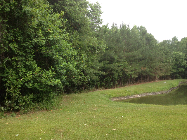

Here is a before and after shot of one area I mulched on the back side of pond dam.
