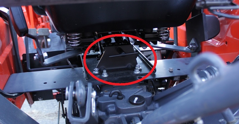

We recently acquired a B2650 which comes with the "Deluxe Suspension Seat" which is also used on several other models. I'm reasonably heavy and found that the suspension in the seat almost bottomed out with me on the seat. So I looked in the owner's manual. Nothing there about adjusting the suspension. Just the fore-aft adjustment and armrest adjustment. So I looked under the seat and found a T-handle knob under the center rear of the set. Turned it and the stiffness adjusted.
Adjustment knob is in the read oval of the photo below.

Our L3400 has the same set-up. I remember reading here that the mechanism often sticks on them, so a little lube and some bouncing can free them up if you don't think they're working right...
