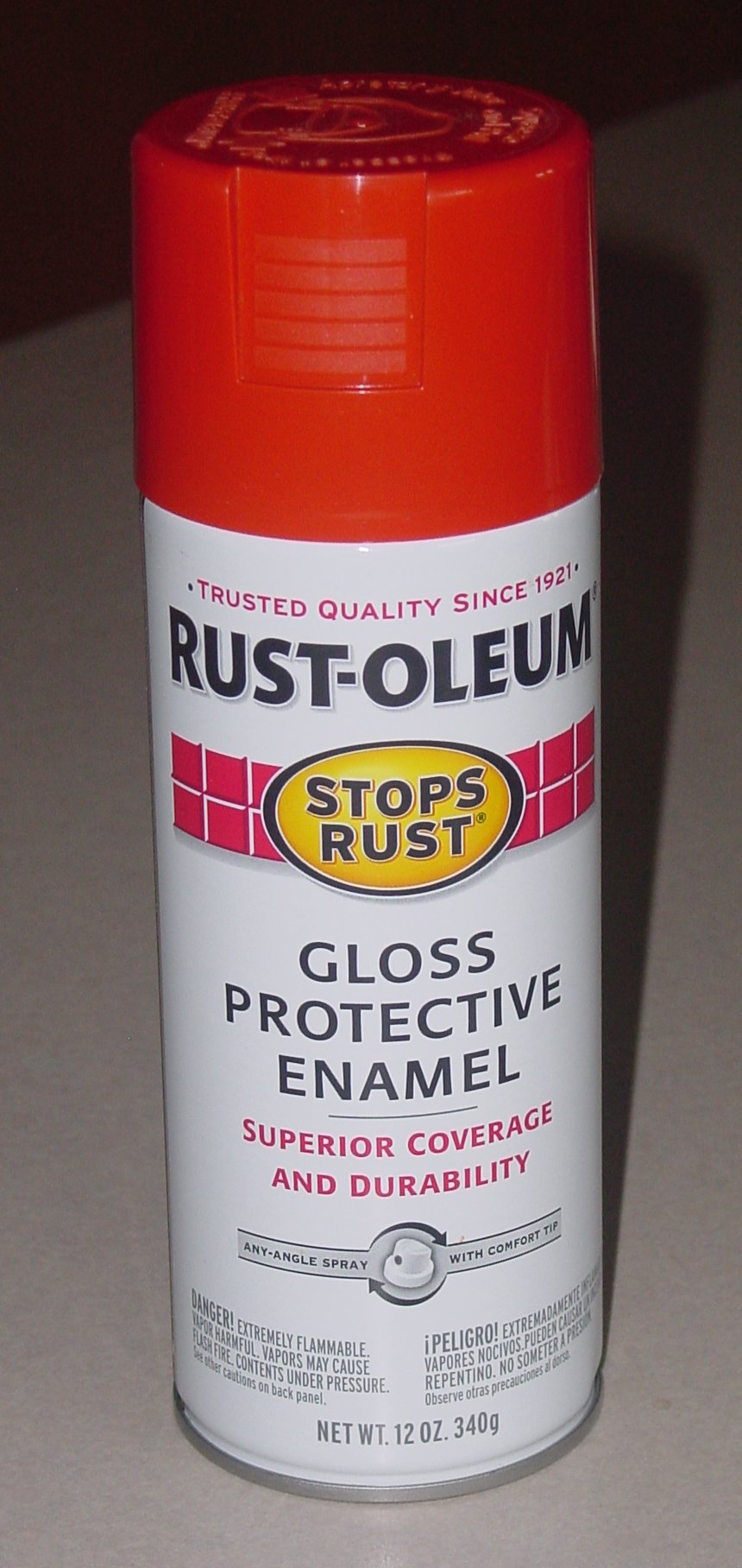

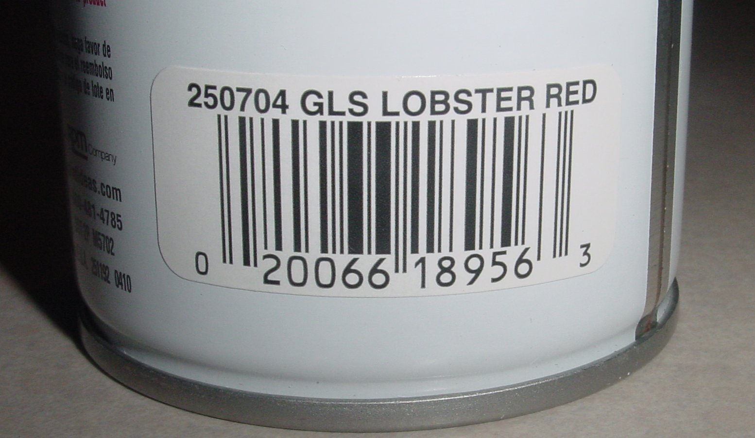

FYI: I found the PERFECT budget Kubota Orange paint.
Its Rustoleum "Lobster Red" - $3.77/can at Walmart.
It is absolutely identical to the 'new' Kubota orange. I painted a test panel on my BX2750 snowblower yesterday, and it is indistinguishable from the original factory paint. It is also old-fashioned oil-based good quality paint (2-4 hour dry-to-touch time). I wouldn't be surprised if this is the same paint that is in the $13 Kubota spray cans.

Take a look at this. This is a piece of metal off of a 2010 Kubota L3400hst so it is Kubota II also known as "new Kubota orange". First photo is the original painted metal.. It is dirty, so take that into account.
The second photo is one half freshly sprayed with the Rustoleum Lobster Red paint bought today from Wally World. .. still wet. It looks like a really good match to me, about as good as I have seen. It looks better in person than this photo!

I bought a can yesterday and hope to try it out this weekend.
To my eyes, the color of the plastic cap seems to have a little too much red in it to match my 2007/2008 factory paint.
To those that have already tried this color, if you still have the cap how close is the color of the cap to the finished/dried object that you painted?

There is a demo above using a 2010 kubota L3400hst - apparently is dead nuts. I thought my BX was a little more orange than the blower, but maybe not. In any case, it's pretty dang close - as close as Kubota paint, I'll bet.
