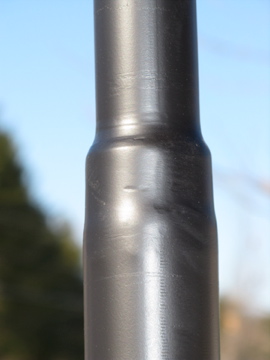

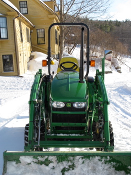

When I installed the vert exhaust kit, I found that I was getting exhaust in my face while underway. Perhaps this was due to the fact that the new pipe is much larger than the original down pipe, or maybe because thew new pipe was too short. My modification was to cut off the curved tip of the new pipe and cut out a section of the original down pipe and join the two pieces such that the new pipe is six inches longer and the tip is of a smaller diameter thus faster exhaust speed. A good custom muffler shop can help with the assembly. Mine charges $15. I have tried out this mod and it seems to do the trick.

That's a nice looking job! :)
I like a vertical exhaust on a tractor!

Nice, I like that mod a lot, I've been thinking about doing the same thing because I'd always thought the stack was too short. How much taller would you say it made the stack? 1'? How's the stability of the stack now? Just wondering because I'd be worried what effect that taller stack is going to have on the integrity of the exhaust elbow under the hood that it mounts to, and whether or not it could crack or damage it from the extra stress of more pipe rocking around on it.
