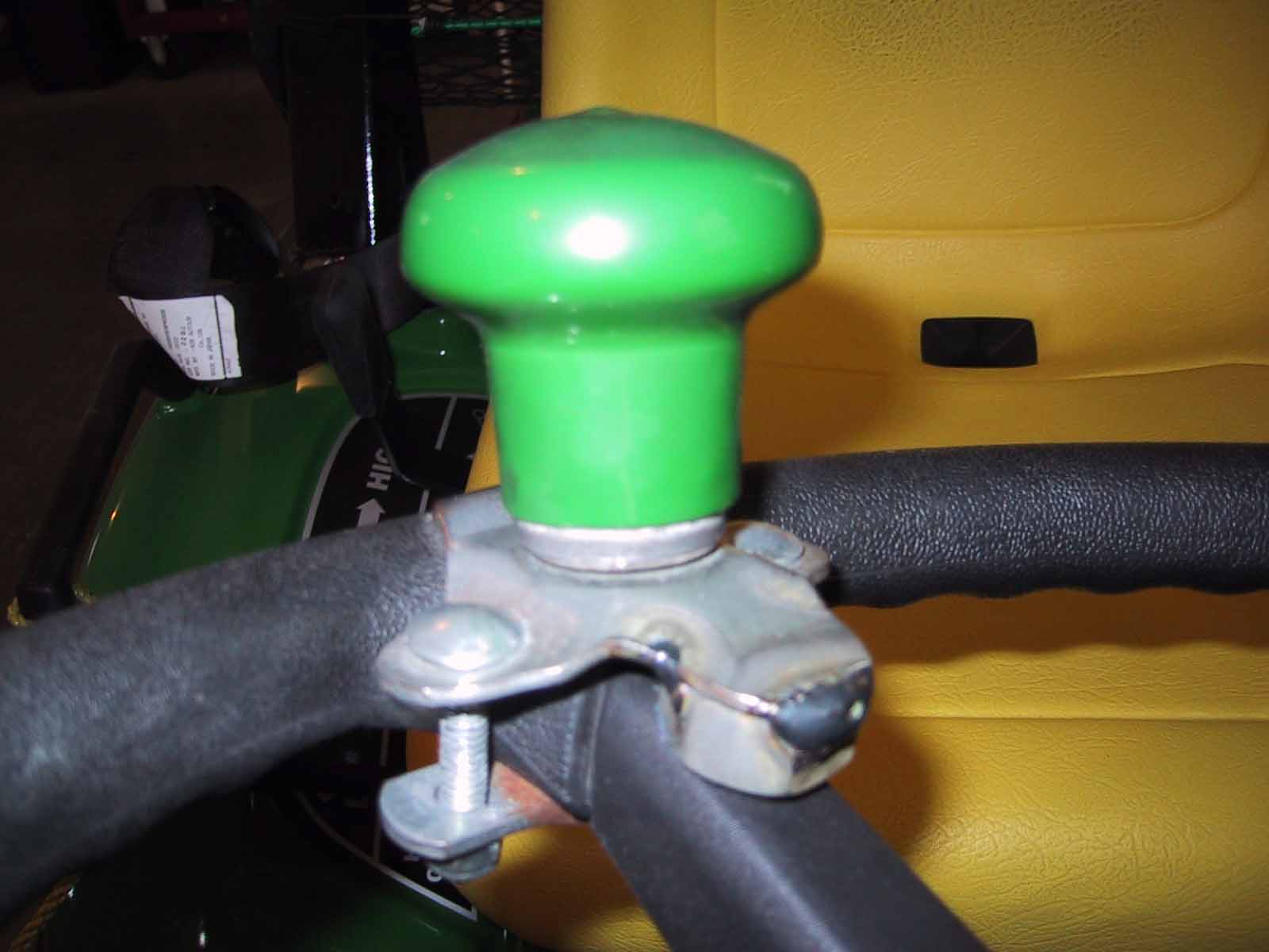

Attach it to the spoke. Support the side that touches the spoke (with a nut for example) to keep the spinner square to the wheel face. See attached pic.

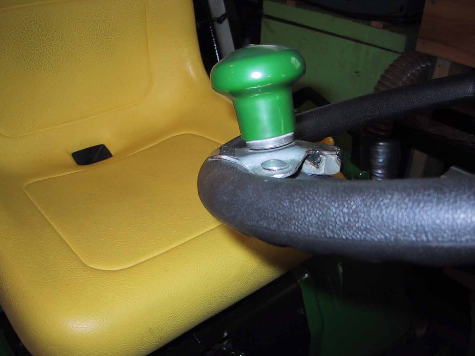

Another angle.

I've been looking for an excuse to buy a welder. /forums/images/graemlins/grin.gif /forums/images/graemlins/grin.gif
Thanks for the B-I-I-I-G pics, and the clever spacer. Maybe (after I get the welder) I will get mine mounted (after several years). /forums/images/graemlins/wink.gif

<font color="blue"> 'Support the side that touches the spoke (with a nut for example) to keep the spinner square to the wheel face." </font>
Now I know why I spent the extra six dollars. I didn't have to acquire and weld on a spacer. Mine came with a piece of rubber/plastic that slipped over that end to level the spinner on my wheel. The slot for the metal piece was offset so I could get two different adjustment levels from it
