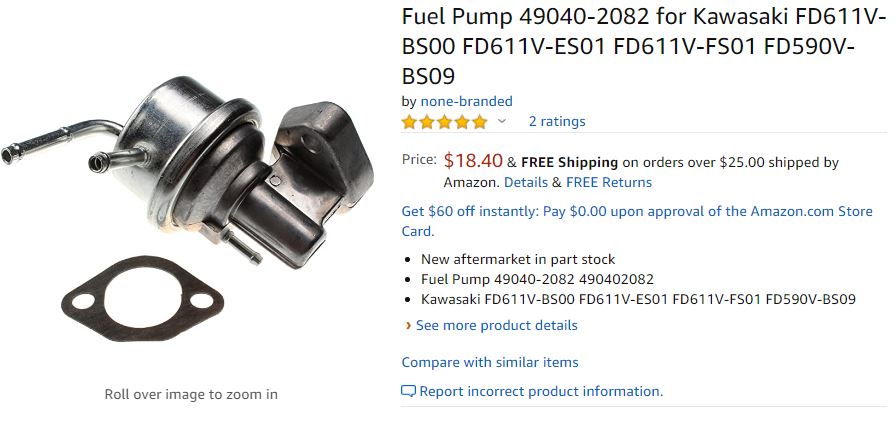

Fuel pump from Jacks Small engine;
Kawasaki FD59V-DS9 4 Stroke Engine FD59V Parts Diagram for FUEL-TANK/FUEL-VALVE
Fuel pump from Amazon:
Amazon.com: Fuel Pump 49:mad:-282 for Kawasaki FD611V-BS FD611V-ES1 FD611V-FS1 FD59V-BS9: Automotive
It's a fuel pump, just go with the least expensive.
