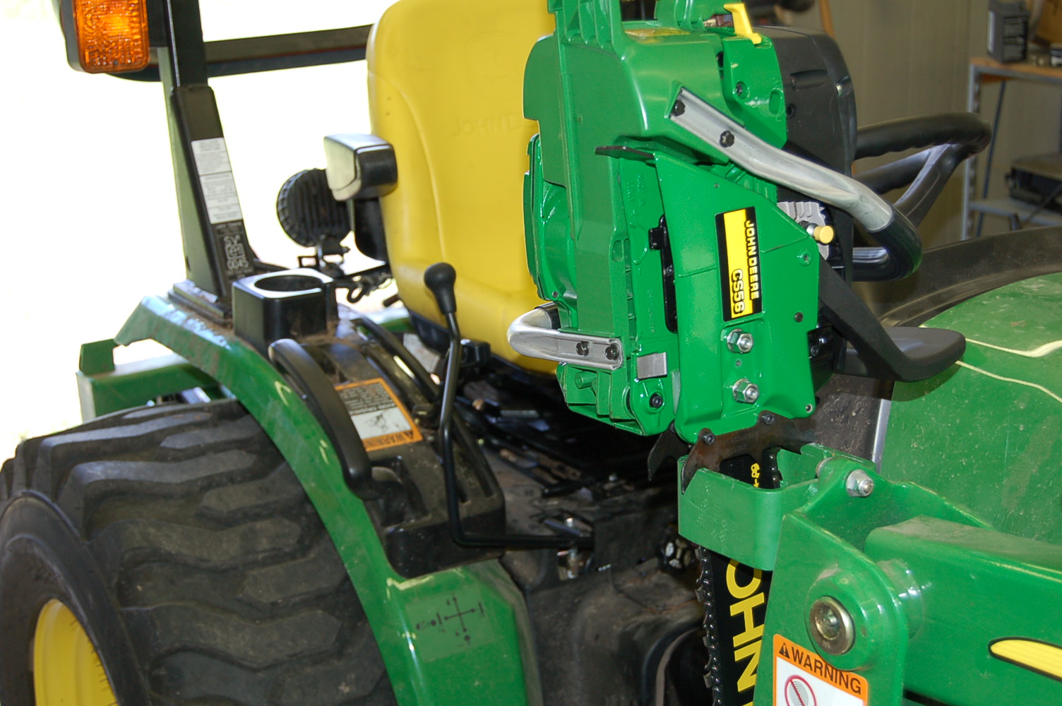

i use a saw regularly when using fel so i made a simple bracket to carry the saw.i cut a piece of 4x4" square tubing and mounted it to the loader. simple and works fine.......

i have had many saws. presently i have a dolmar ps3410th arborist saw, a stihl ms260 pro and just got the deere. deadman, it's made by efco (same as a 956). so far it's great. lotsa power for the weight. i mainly bought it because it was a good deal ( 285.00 including frt, new, on ebay) and orange clashes with green.

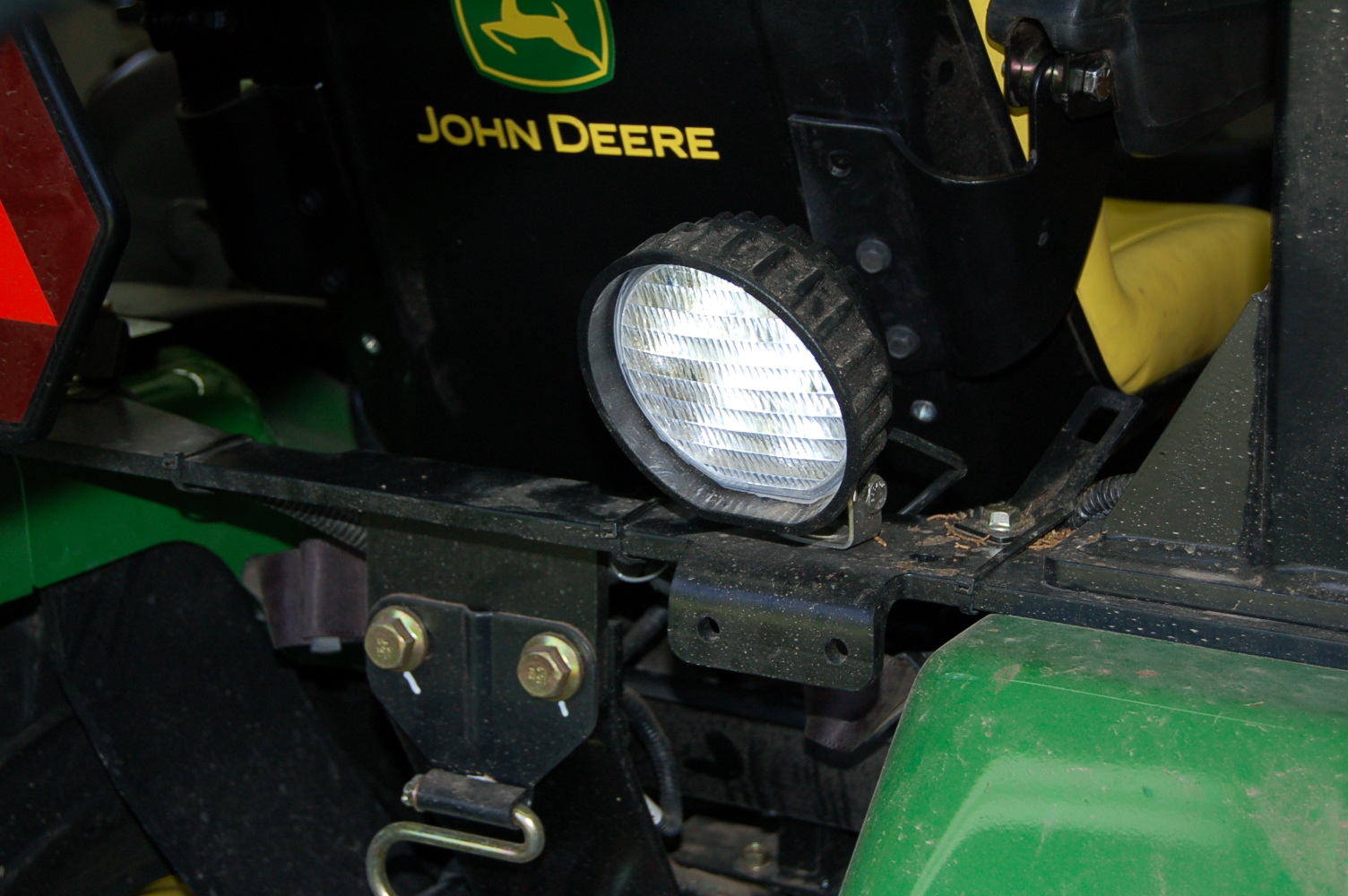

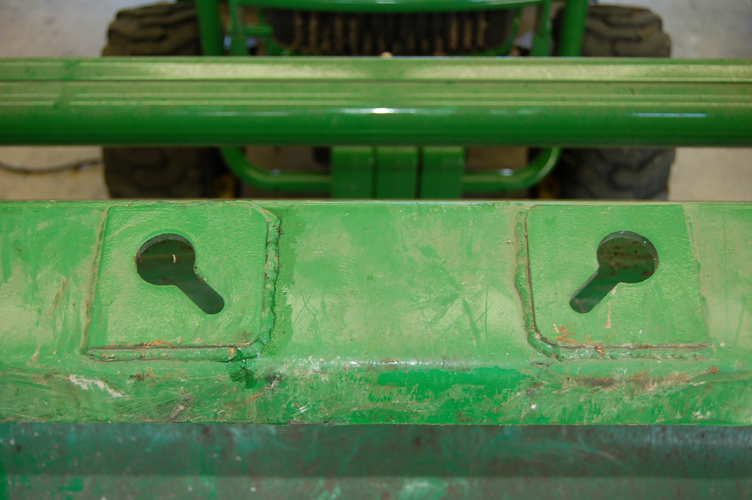

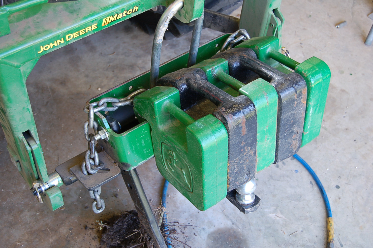

a few more deere 2520 farkles. i made rear weight mount out of deere 990 frt weight mount and a drawbar. the dealer gave me the 990 mount. apparently they all have a mound as 790 and 990 comes with bracket and has to be removed if a loader is used. i put a ball mount on the bottom and chain hooks. in photo, i have 1 weight removed and bolted a ripper to it to dig a trench to bury a 1000 ft of wire for a underground electric fence. the rear worklight is an LED and is more than adaquate for my limited night work. the wire was already run by deere and is switched by master light switch. i tried something different on the bucket hooks this time. i always seemed to catch something on the chain hooks on previous rig. these are 5/16 and chain access can be from top or bottom.

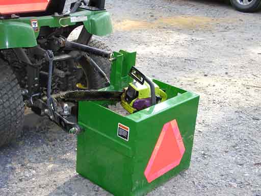

It's an 18" Poulan. Small, light duty, and slow to cut, but it consistantly starts on pull #5 and just keeps running. No sense in replacing it until it stops running. Especially since I no longer need to cut up firewood...
