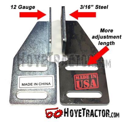

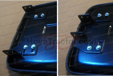

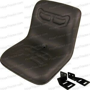

Knowing the JD770 compact is actually a Yanmar, it's not welded. It's a flip forward seat. There are 2 brackets, a left and right that bolts to under the seat.
And because dad's are older, get him the high back seat. He would really love you for it.
The seats today are more universal to fit several flip forward models. Looking at the under side, you see this
And Hoye Tractor has the OE Yanmar/JD mounting brackets, too.
BUT, those are generally weak and are not beefy. So, they also carry the HD set that I personally would only recommend to everyone.
Seat Bracket Set - USA Made - Improved Design (Pair)
And the price for under $20 is amazing vs. the OE Yanmar/JD prices for the thinner brackets !
SEAT ASSEMBLY (With Brackets)
Works with ANY Yanmar or John Deere seat arrangement for flip forward setup.
If the seat needs the Big Bumpers, they got them too. Just follow the links I gave.
