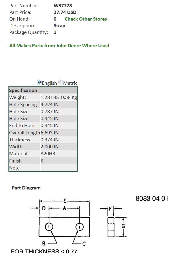

Putting my dads Deere 606 bush hog back together. Had new supports made (discontinued by Deere) and now putting it back together. I have lost the top flex link (W10261 discontinued) where the top link attaches to the bush hog. Anyone have a 606 that can measure this piece? It is shaped like a "U". I am looking of the length and width and thickness of metal.

Here's the spec's on the straps for 3 pt center link attaching point on a JD 613 which should be similar in dimensions between attaching holes. After all one just needs enough slack for the hinge affect.
