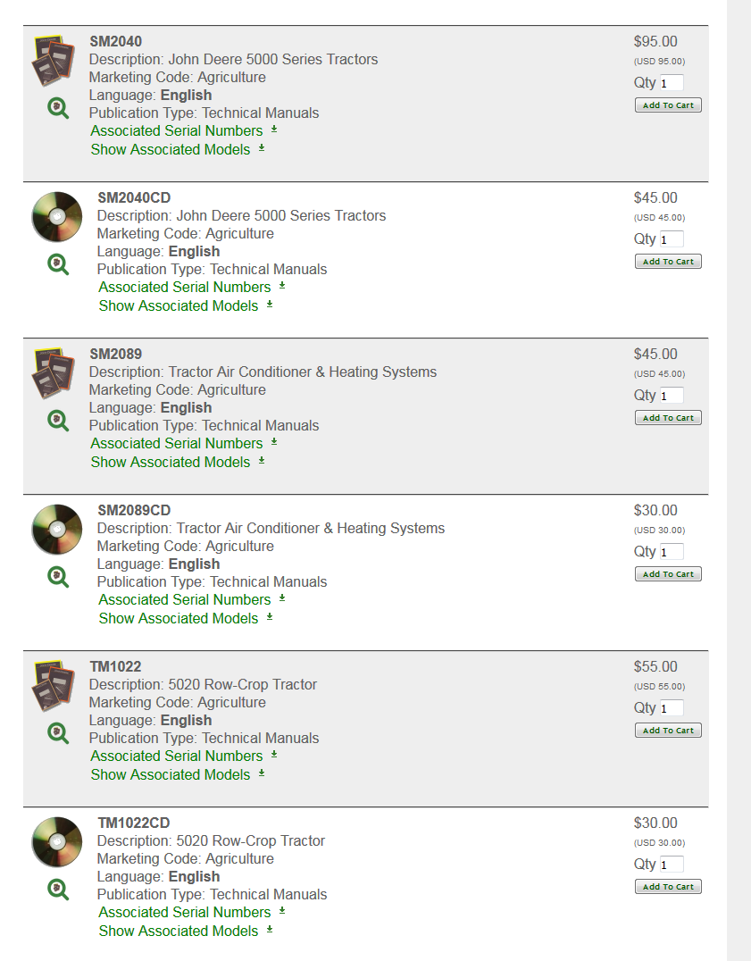

I called today re the technical manual and they asked me if I wanted the technical manual (242 pages) or the service manual (450 pages). They do not know what the difference is, can you tell me? Thanks again, Marcin.
   / deere 5020 rockshaft arms not working well #8
I think you will need the tech manual TM1022 or TM1022CD as it states 5020 rowcrop.
