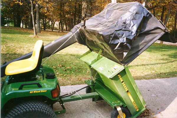

Now, if you want the cat's pajamas too, add the hydraulic ram to the MC519 cart, and enjoy the "look ma, no hands" when emptying the load. I just put mine on for the fall, and had a ball yesterday picking up grass and leaves. /forums/images/graemlins/wink.gif

My dealer carries a kit that they have made up, but it is not a Deere part (or kit). I have several friends who have added them on either their 400 series or the X series, because there are two hyd controls and two pair of remotes. They rave about them. I rave about mine too. Pic attached
Not sure why Deere doesn't offer the hyd. lift, but there are a lot of things I don't understand. /forums/images/graemlins/wink.gif

That is a nice setup to dump the cart. What does you dealer ask for that setup? Thanks for the picture. I might try and put something together myself.

Appears to be a cylinder, brackets, hoses, flow control valves and hyd. fittings. Pretty straight forward.

I was looking at my MC519 cart and the picture you posted of your assist lift. The cart does come with a manual lift assist cylinder. It appears in the photo that your kit replaces that with the one in the kit the dealer put together.
Are there any names or numbers on the cylinder that would help me in sizing a cylinder? I have used the cart enough this past week for me to want to add such a feature.

/ Deere 455 #12
That is where the cylinder is at. No numbers on it that I can see, but will look closer. May have to scrape some paint off and see if they are there.
It's a GREAT addition.
