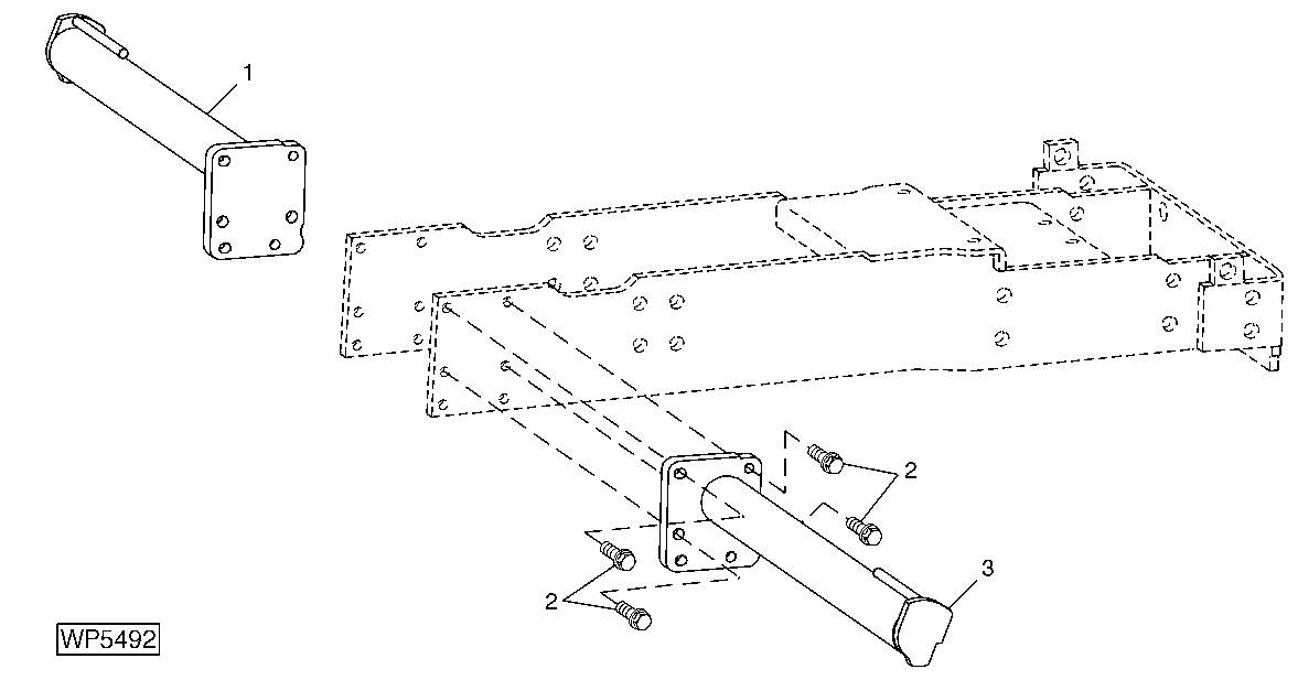

Hi All,
Great forum, and glad to be a new member. Just a little about myself. I'm a general hobbyist, and enjoy making just about anything. I have 40 acres in southern Ontario that I have just started installing a small vegetable garden on and 30 tree fruit orchard.
I currently have a 2001 John Deere 4500 tractor. No cab, 4WD.
I want to put a loader on it, but since it is older I cant justify spending the money to get a new one. I have a chance to get a John deere 400x. I know any loader can be made to fit any tractor, but I am wondering if anyone knows if my tractor and that loader would be compatible.
Any opinion would be realty appreciated.

The 400x is compatible with your 4500, in fact you can still get the mounts through JD:
MOUNTING FRAMES 41,4320,4500,10,20,4600,10,4700,10,20
MOUNTING FRAMES
Cart key PART NO. PART NAME 400X 400CX REMARKS
1 AW32461 Frame 1 LH
2 19M7793 Screw 8 M16 X 40
3 AW32460 Frame 1 RH
FYI you can register (free) at JDParts: Unsigned Landing Page to look things like this up for yourself.

The 4500 was originally sold with a 460 loader, IIRC...so, there's another option.
Does your 4500 have the hydraulics required...joy stick, control valve and hydraulic tubing/QD's?
