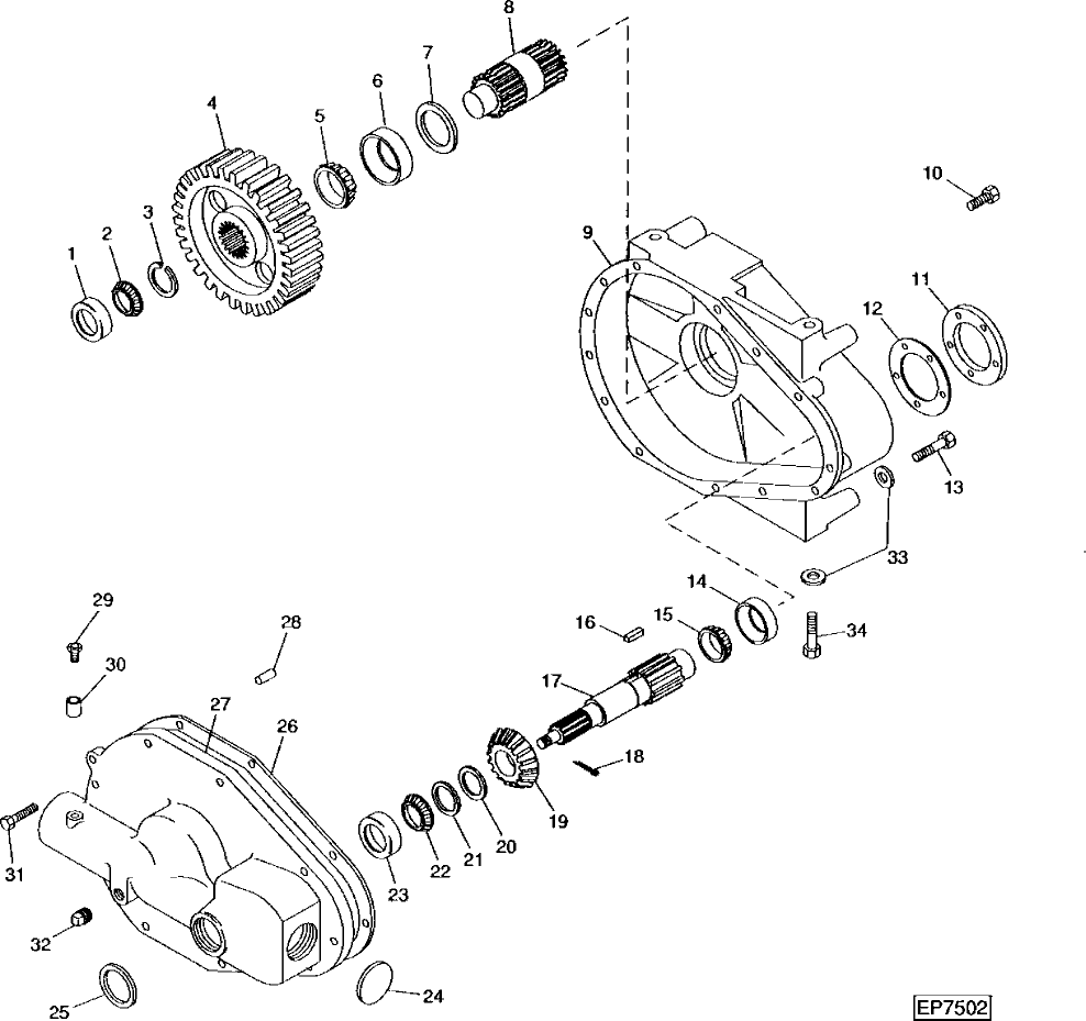

I picked up a dandy of a 336 baler today. I went through and cleaned everything and I was wondering about the gearbox on these things. I assume it has a fill cap somewhere up high and an overfill cap somewhere lower. Can these be accessed pretty easy?
I wanted to ask here before I went and took off sheet metal unnecessarily.

Pipe plug(parts key #32) accessible behind flywheel.

so #32 is my fill and overfill. I'm guessing I will have to remove the flywheel to check and fill

I think you can remove breather(parts key #29) to fill and #32 to check oil level without removing FW.

Awesome. Thank you Jim. One last question. Does it require anything special in there? Can I use standard gear oil? or hy-gard?
