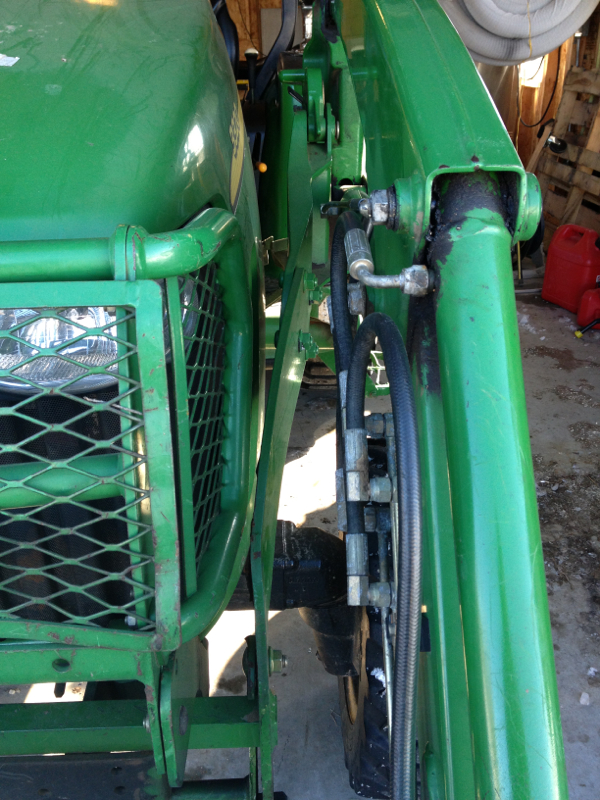

I have a Deere 3320 with a 300CX loader. Everything was fine until one day last week when the left loader arm disconnected itself at the quick disconnect mount on the tractor. I saw what looked like excessive wearing on the mount itself on one side. Ever since then if I pick up a heavy load 600lbs or more and hit a few bumps along the way that arm will drop out of the mount and it's obviously a safety issue at that point. To get it back on I just follow the quick disconnect procedure by lifting the rotating levers, lowering the tractor and "pop" it goes back in, then I put the levers back down. When the left mount is on there is a larger gap than the right one and as load is added it appears the loader lifts slightly off the mount creating almost a 1/4 inch gap between the mount and the actual loader arm that attaches to it.
Is this a simple matter of replacing the loader mounts on the tractor? Or is it possible to bend those loader arms from an impact or too much use? Hoping someone has seen this before as I have a lot of loader work to do in the next few weeks.

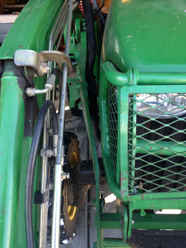

Everything is secure and it's a 7 year old tractor with about 1200 hours on it. The springs and latches are good even so to the point that I had to bring the bolt for that left side in prior being able to move it up and detach the loader. From what I'm seeing so far it appears the mounts are bent. The left side more than the other which is the one with the issue. Is this a common side effect if those are bent? It's part AW32469 from the illustrated parts list for the mountings. Has anyone else had to replace these?
   / Deere 3320 w/ 300CX loader that falls off
Do these look bet/ out of spec ?

Your loader mounts sound like they're on the wrong sides. Take a pic with the loader off the mounts. I had this happen when my machine was new. I had a load of dirt and the air and hit a bump. The loader frame on the left side bounced off the mount. And low and behold, the mounts were on the wrong side.

That's excatly what happened to me. The mount arms were on the wrong side. It took about a week before mine popped off then it became a regular occurance everytime I had a load in the bucket. I checked the manual, corrected the problem and its been smooth sailing ever since.

Yep, my loader was installed by the dealer and I had the same issues. Took the loader off and after looking at the manual determined the masts were on the wrong sides. Amazing to me, the masts are not labeled right or left! After switching them I have not been able to replicate the problem since. Easy switch, just takes a big impact to get the bolts out.
Great, thanks guys. That was the issue! Wouldn't have guess that they could have been mounted incorrectly but works like it should now.
