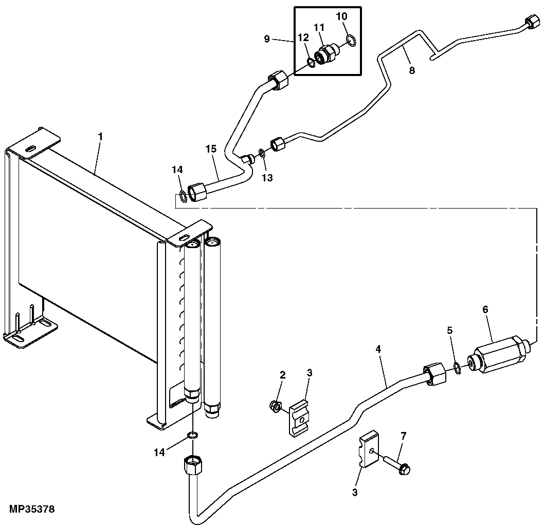

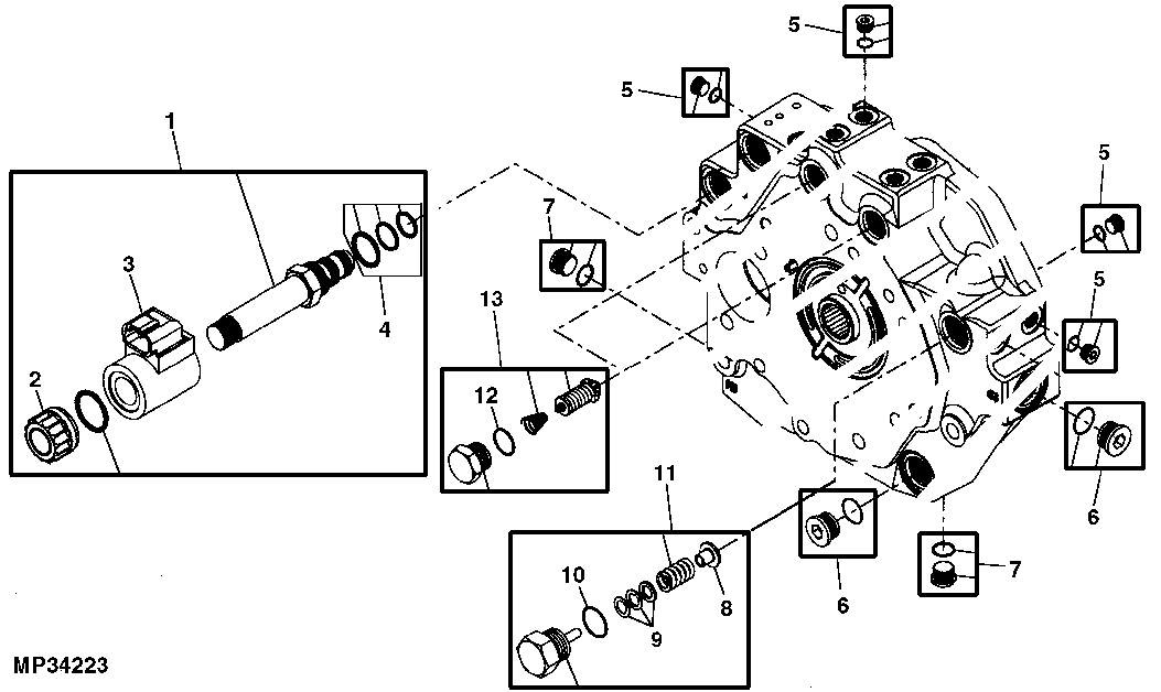

According to the JD 3x20 technical reference, a loss of charge pressure will cause poor transmission performance. The charge pressure is supplied through the power steering hydraulic pump. There is an inline filter before the transmission, check that (it is on the left side near the engine) Item 6 in left picture. There is also a charge pressure relief valve that may be stuck open or have that missing piece of filter in it. Item 11 in right picture.

Cocre, on the second pic with the relief valves where is that located on the tractor. I will check the inline filter tommorrow. Thanks for the helpful reply.
Matt
Follow the charge pressure line back from the inline filter to the hydrostatic transmission. It is in that area. The book says to disconnect the line before removing the valve. I would think the inline filter would catch any debris before it made it to the relief valve. Unless it got trashed also.
Also, check the big suction filter too.
