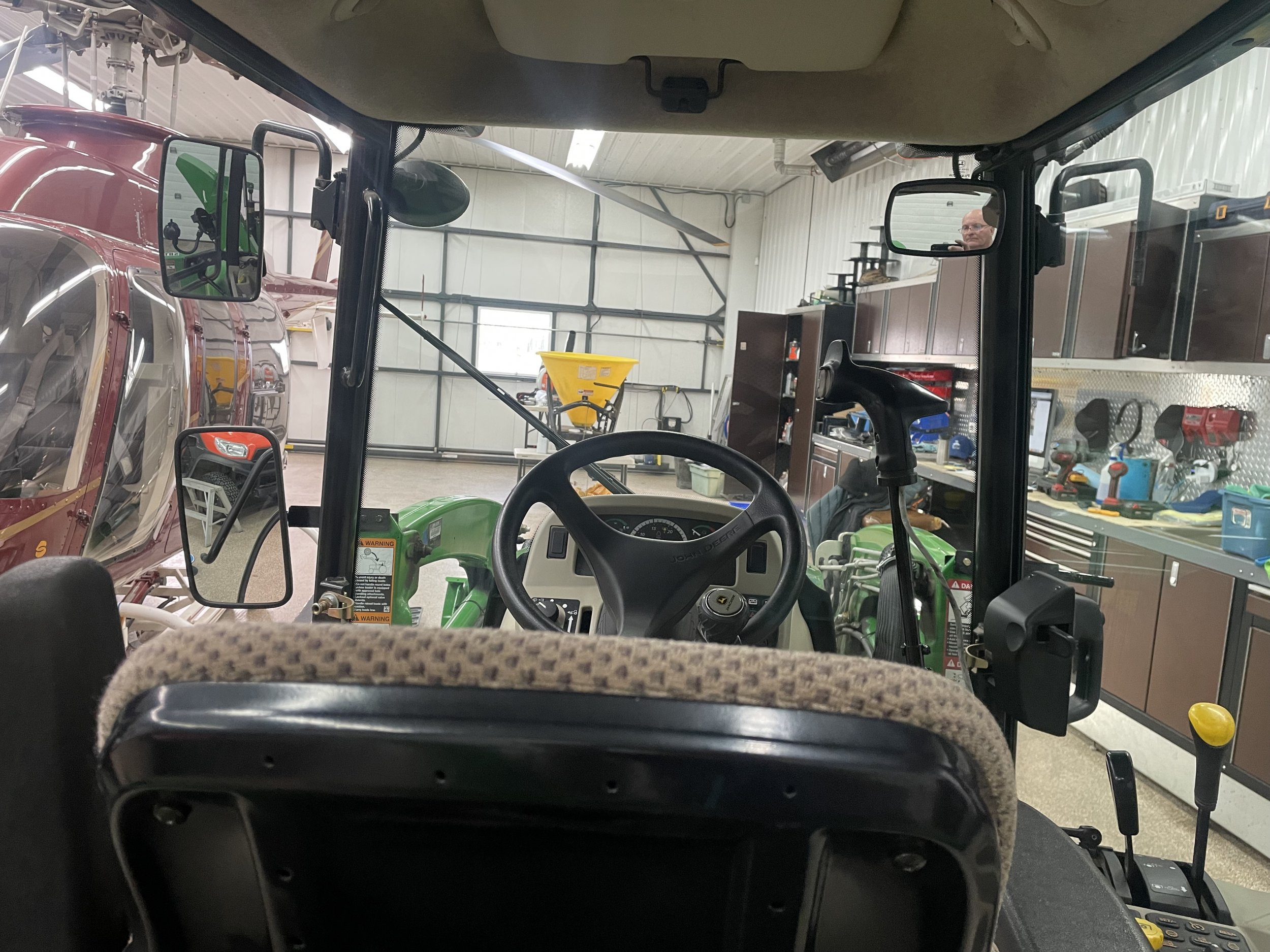

I'm kind of a newbie here, and I have searched many a forum for answers. After coming up empty handed, I decided to do something about the stiff loader controls on my 3039R.
This has been a problem that was bugging me for some time. I had broken my arm 11 years ago, and it's never been the same. I have limited strength in my arm in the "dump" direction so I went on a mission this weekend to lengthen the lever. I had previously tried to lubricate the cables, but the fact remained that the lever was too short. I added about 9" to the lever. It looks a bit quirky (kinda like a modified shifter in some 18 wheelers I've seen), but the ease of operation has improved substantially. I can't say I was ever able to rest my forearm on the armrest when operating this before (too much force was always needed), but I am now able to feather the controls in all directions. I own a lot of construction equipment where pilot controls and shorter strokes are the norm, but for my purposes with this tractor, it was a welcome modification. I'll tie wrap the cable to the control after one more coat of paint. ren1pa, I would be curious to hear what they did to make your controls move more freely.
   / Deere 3039R with Factory Cab with FEL TILT FUNCTION too stiff to comfortably use. #8
Nice! I just got a 3039r cab tractor and hate the cable operated loader control. I was just thinking of extending my joystick but also back towards the arm rest also. Thanks for the confirmation of giving it some finesse and better control, I will be tackling this new project.
   / Deere 3039R with Factory Cab with FEL TILT FUNCTION too stiff to comfortably use. #9
If something is tight and starting to seize up you may eventually snap something with the extra 9 inches of leverage. Nice job on the fab work. the cables probably need to be lubed or replaced.
   / Deere 3039R with Factory Cab with FEL TILT FUNCTION too stiff to comfortably use. #10
To clarify, the controls (in my opinion) were too stiff from the factory and I did have them looked at and lubed. It's frankly a bad system in my view and compound it with the limited strength I have in my arm, the added leverage helps me in my case and I do not have any fear of snapping anything. The ability to fine tune with the added leverage is something I never had when the controls were shorter. Judging by some of the responses I saw, I'm not the only one experiencing stiff Deere controls from what I am seeing. I do agree with you though; in some cases, bigger isn't always better ;-)
