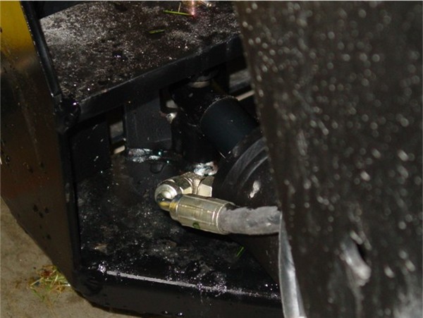

Who here has been plowing snow with their John Deere front blade and Front Quick Hitch?
I was plowing our road and driveway during the 1st big storm this year (yeah, I know it is March).
Wouldn't you know it but the hydraulic fitting on the "angle cylinder" snapped in two. /forums/images/graemlins/shocked.gif
Why? Well, it appears to be a big design flaw, for those of us who don't park in a heated garage. When I back drag snow, the snow builds up in the Quick Hitch (right where the Angle Cylinder fits in the Quick Hitch) and when angled to the left it packs it in real hard. As time goes on the snow is packed into a real hard ice, which broke the fitting. /forums/images/graemlins/mad.gif It also gets in there when the snow falls over the blade (when ramming a snow bank) and backing out.
Now that I bumped my wife's car outside of the garage, the tractor is warm and the snow does not build up there for long. We all know that you can't make your wife park outside while the tractors in the garage. /forums/images/graemlins/blush.gif /forums/images/graemlins/grin.gif /forums/images/graemlins/tongue.gif
I do have to get off and clean out the spot often. It gets so hard... a pick and a hammer have a hard time breaking out the ice. I attached a photo of the location and fitting.
I just wanted to see if anyone else has seen this, if not... be on the lookout!

Not having that problem with my 54" blade, and I think it is pretty much the same as yours. Maybe there is a way to cover the area to stop the snow from sticking there. If it gets in unfrozen and then freezes in place, seems to be a matter of time - over which it could be cleaned out rather than left to freeze. Not sure if I could duplicate the problem, but will have it in mind as I don't want the broken fitting.
Maybe you can come up with a better design?
   / Deere 2210 up thru 4115, Front Blade for Plowing
Even now that I know to watch it, it has still loaded up during plowing. /forums/images/graemlins/blush.gif I do get off an clean it out. Angling the blade to the left really packs it in there HARD and fast. There is no way to turn the cylinder and get the hose fittings in a different spot, that I can see. If I were to cut out the steel in front of the cylinder (steel bracing in the Quick Hitch frame), the snow would just fall out the front. There would never again be an issue after cutting that out BUT how much strength would be lost? You can see in the picture attached where the cylinder mounts. Just to the left is the brace that holds the snow in. /forums/images/graemlins/smirk.gif /forums/images/graemlins/crazy.gif /forums/images/graemlins/frown.gif
I have to get it back into the garage and look at it.
Maybe the 54" blade does not put too much force there.

I have a 4115. I ordered the 54" blade and quick hitch so I could plow snow. When I installed it on my tractor, it looked way to small. I sold the blade on e-bay and kept the hitch. My friend fabricated a 7' Western blade cut to 60" onto the hitch. I have been plowing for two years with no problems. My tractor is never in a heated building, and to this day no problems with ice buildup.
Dave
#9
60" blade... My good friend was going to build me a Stainless 60" blade. But knowing the company he was working for, was closing, he had to find a new job fast (he has twins due any day). So, my blade is on the back burner this year. Is everything closing? /forums/images/graemlins/shocked.gif
Anyway, with a taller blade, you would not have tons of snow falling over the moldboard. After digging out this last storm... I now think it is caused more buy the tons of snow falling over the plow (when pushing into a snow bank) than back dragging. Also, the 4115 is about 4" taller than the 2210 and that would also help keep snow out of there.
