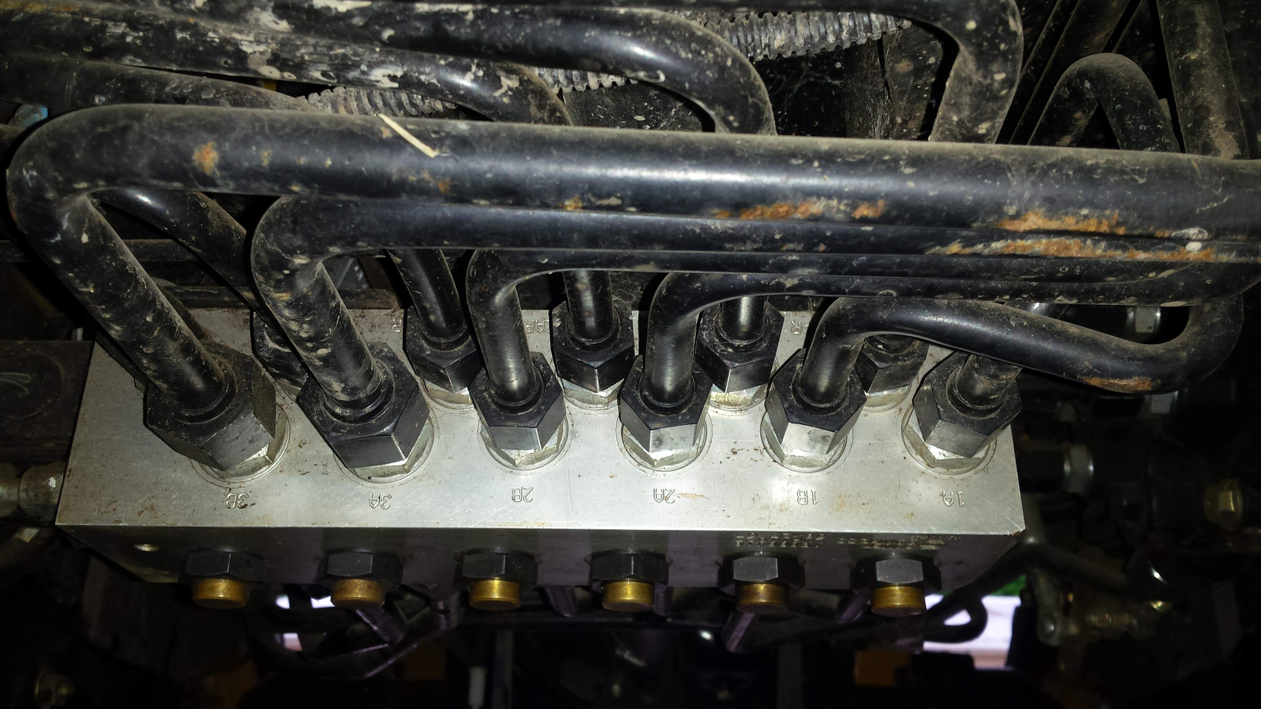

Does anyone have picture's of the underside of a 110 with the aux hydraulic function? I did some maintenance today I can't see why the aux hydraulic option is said to be a factory option. The Deere parts aren't cheap but neither is an aftermarket solution. Thanks in advance.

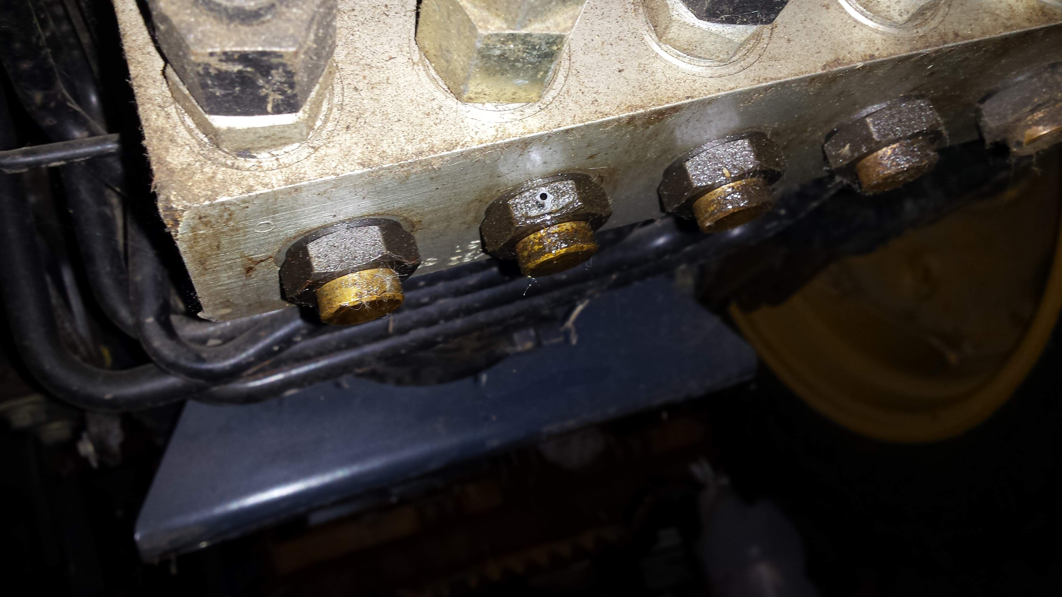

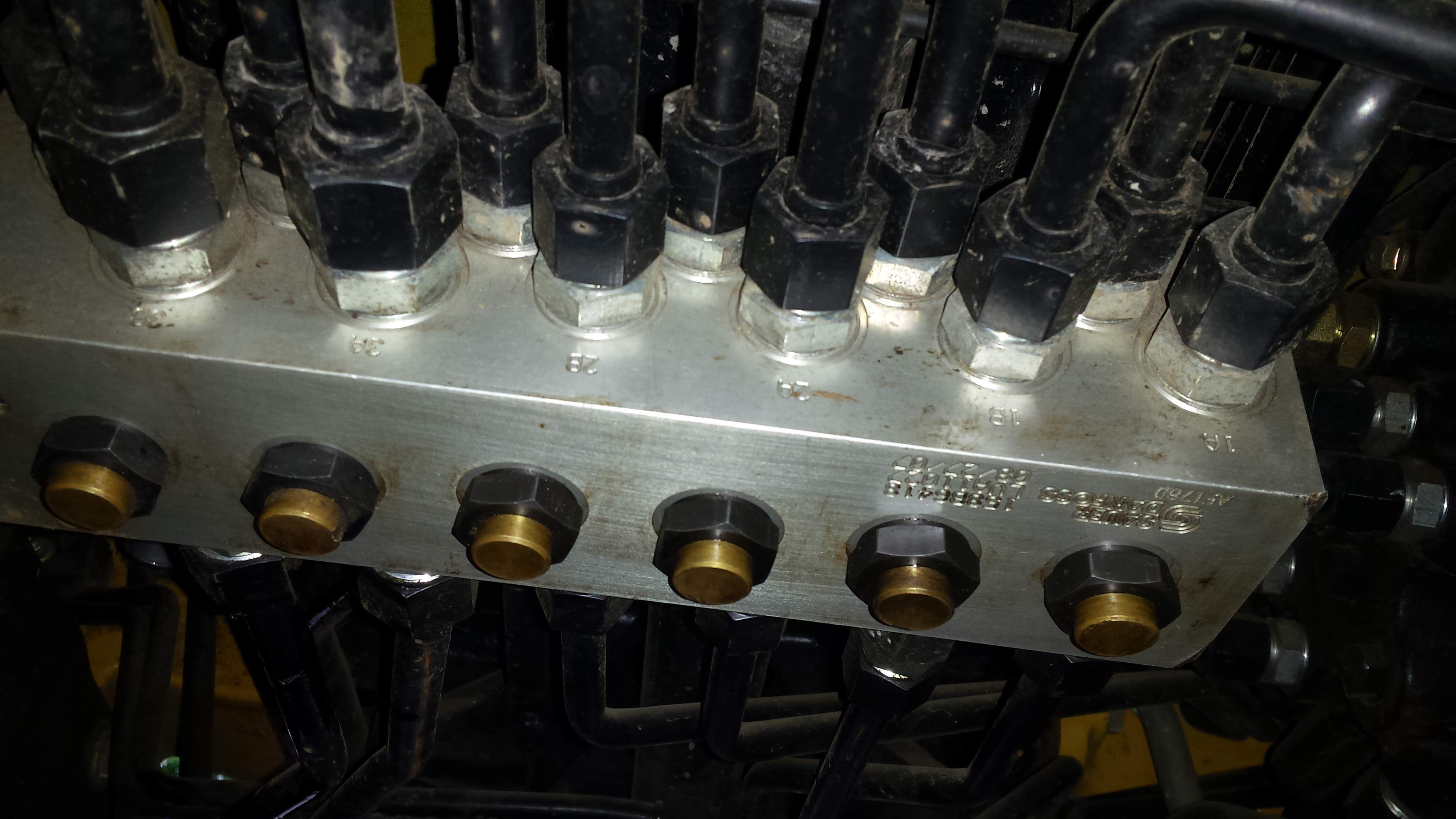

My 110 has a Skid Plate can't see anything. I changed my Hyd oil and filters a few weeks back (I had to remove the skid plate) so took a few pic.(don't ask me why). I hope the pic help.

Wow Doc... great pictures from one Deere 110 owner to another~

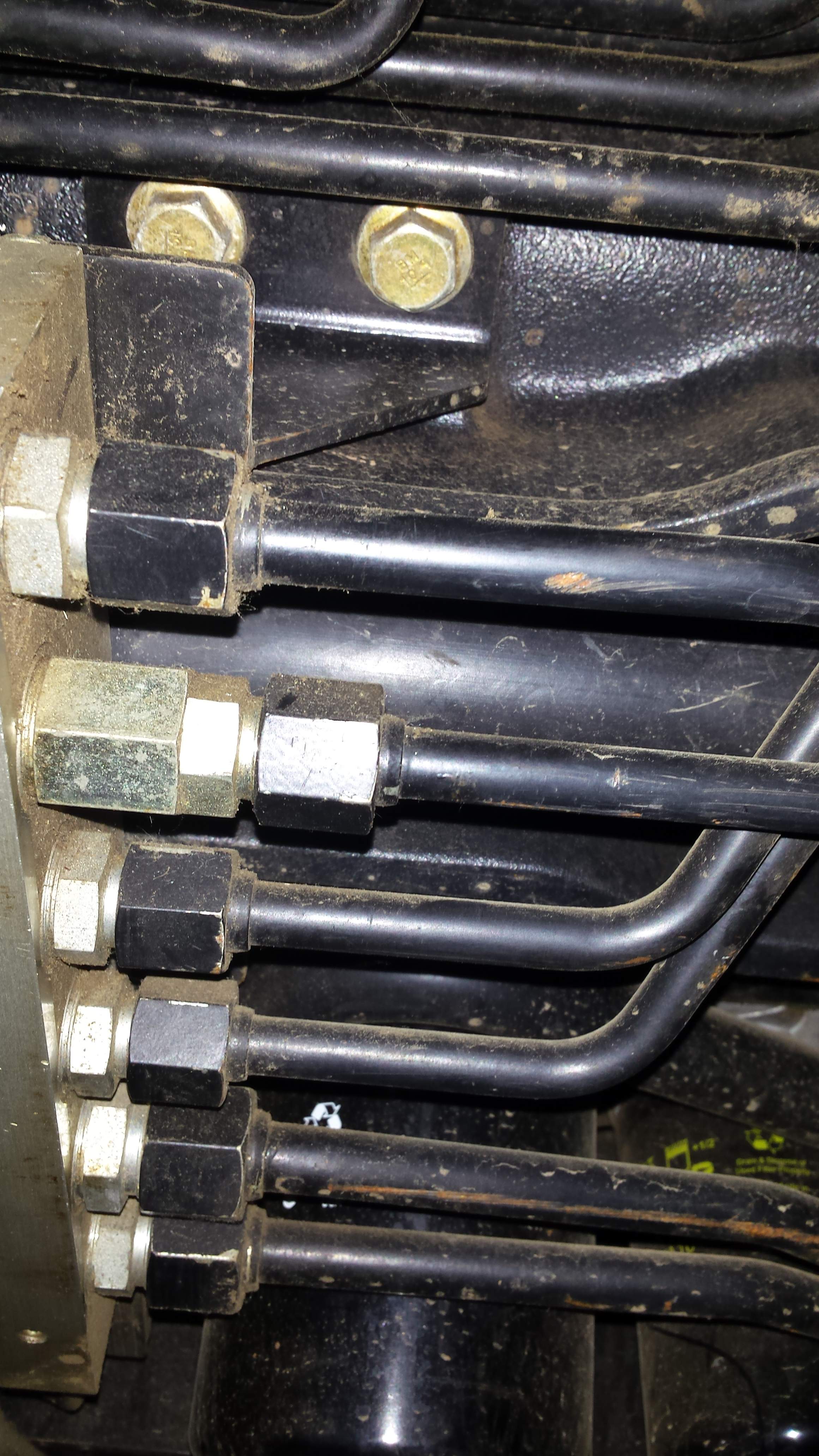

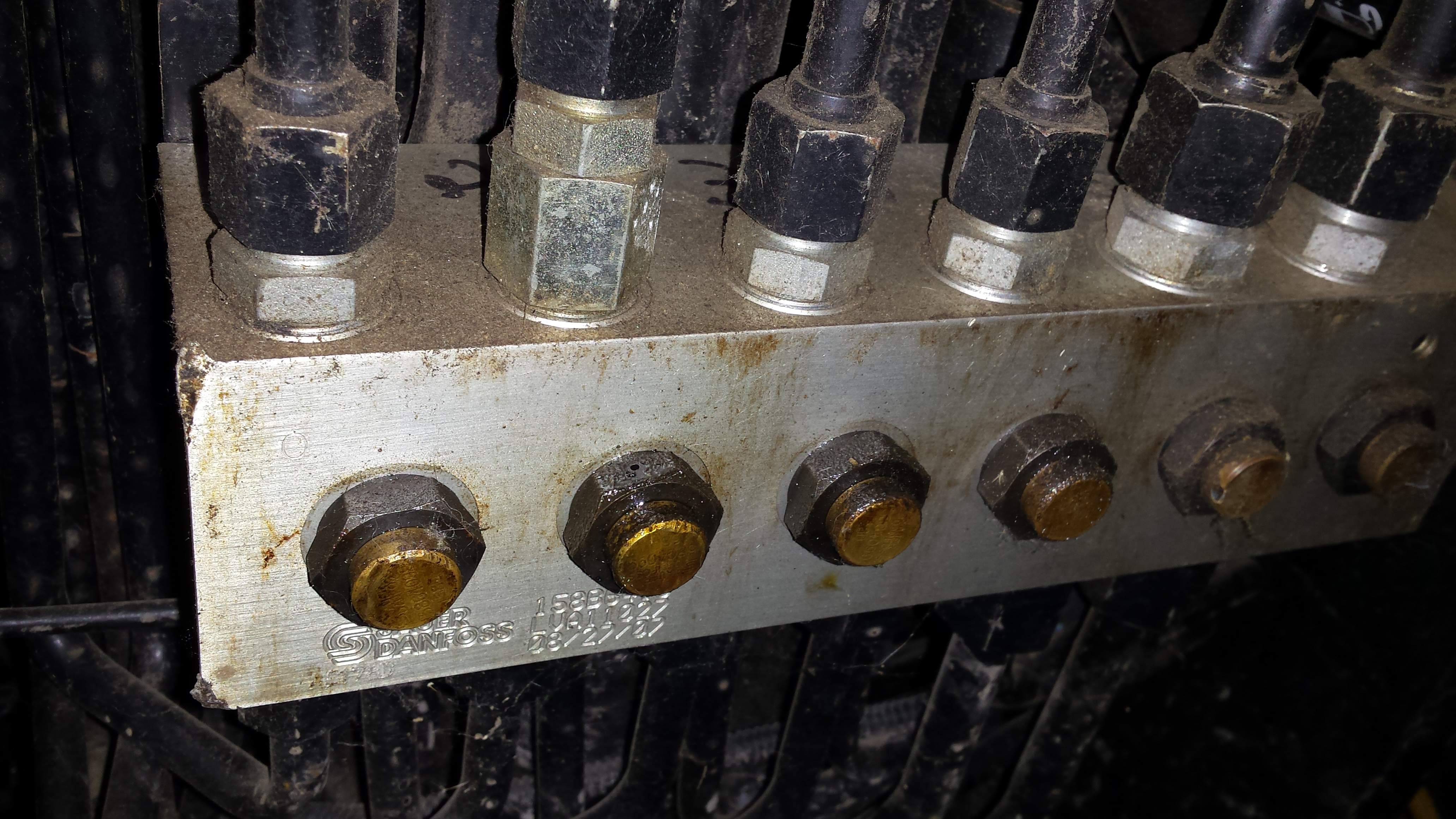

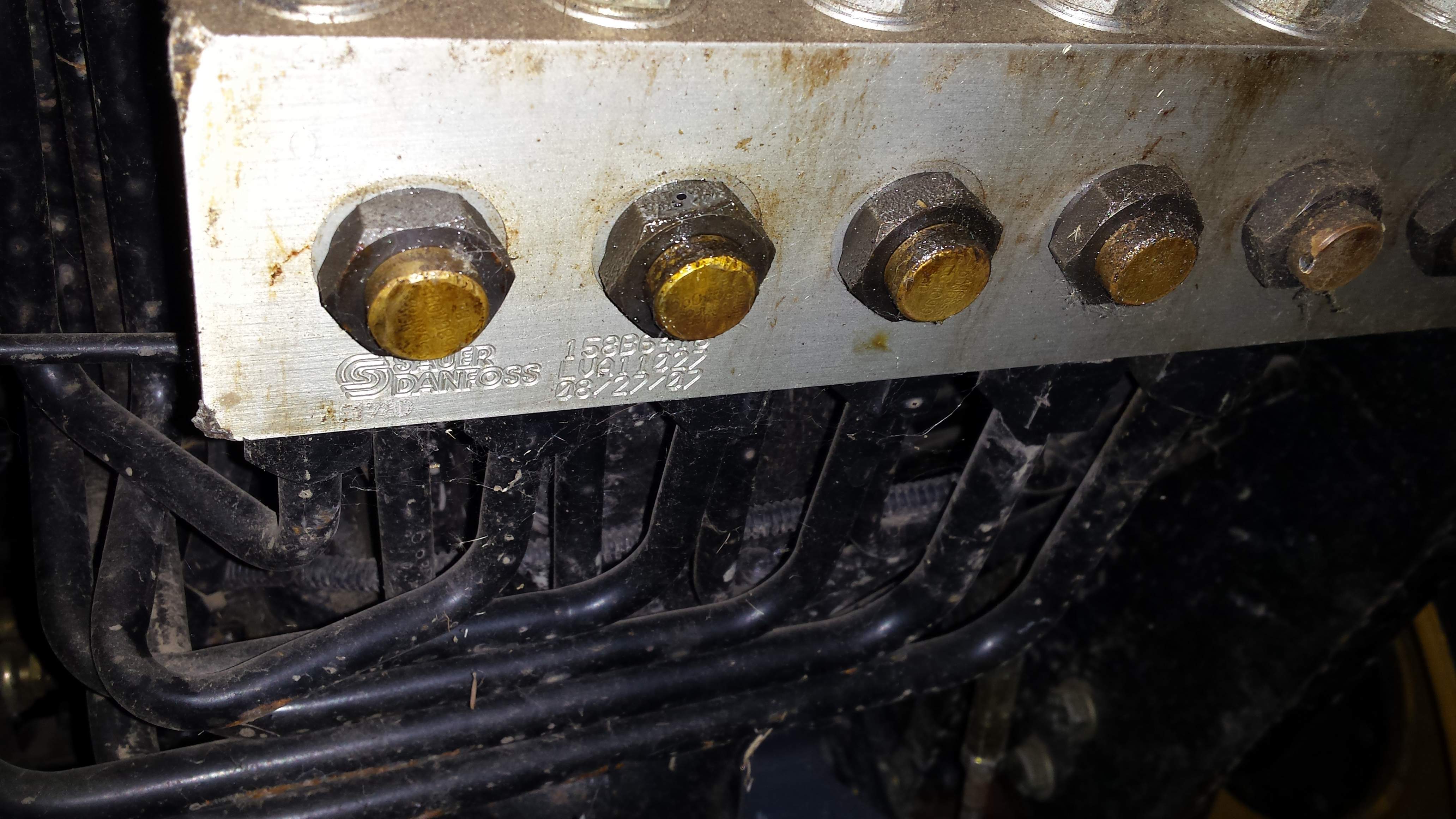

This is the best photos I could get with the skid plate on.
Let me know if you need more.
Photo taken from the rear
Photo taken from the front

Thanks Doc!!! Any idea where the hose that comes out of the diverter block goes? I can't really see any reason this can't be field installed, do you?

Matt,
I'm not sure what hose you are referring to. Can you point it out on the photo?
I'm sure it can be done. The only concern I would have is the cost.
