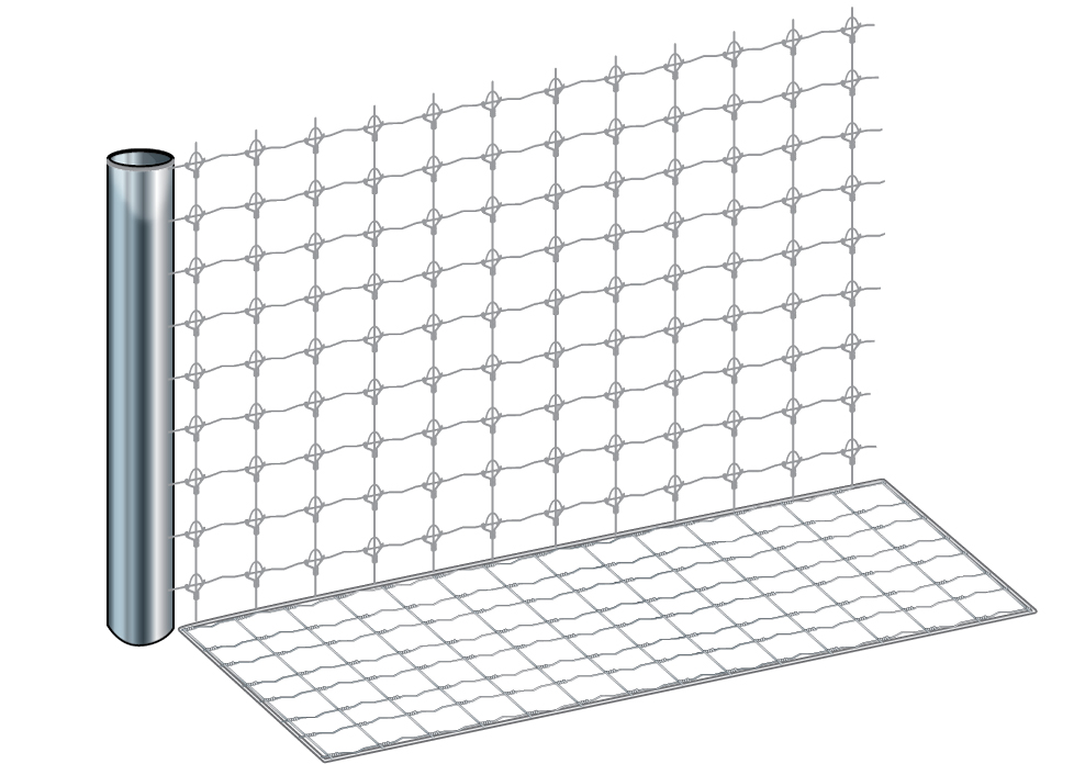

I posted here http://www.tractorbynet.com/forums/rural-living/350330-how-rabbit-proof-large-garden.html?highlight= looking for ideas as I replace the 25+ year-old fence on my 50x50 garden. I am looking putting a 90 degree bend in the bottom section to provide the rabbit proofing. So I will need something I can bend. I'll mount a roll fence on top of the lower fence to bring the height to 8'. That is the height of the current fence and we have never had a deer jump into the garden - they have walked in when the gate was left open.
I'm shopping at the local farm stores and not finding much variety in welded fence types. I would like something that can bend for the bottom, but is heavy enough to last for years. I'm assuming the top section can be light weight, but still would like a long life.
Ideas or suggestions appreciated.

You don't bend the fence, you install two separate fences. The flat one that lays on the ground is stapled in place and then tied to the bottom of the upright fence. The staples are just long pieces of galvanized wire that are probably four inches long, give or take. You just push, hammer them into place to hold the wire flat on the ground until the grass grows up around it. Then the grass will hold it in place. Around here, I'm told to get 32 inch or 36 inch galvanized goat fence to lay on the ground. You want the squares small enough that when the animals try to dig under your fence, they can't get through the wire on the ground.

Thanks Eddie, just what I am looking for. Do you have preferred method for attaching the ground fence to the upright fence? Steel rings or wire?

What I'm told is to use was hog rings. Again, I've never done this, but seen it on the fences I've looked at. It seems to work when done right. I've also seen it done poorly, and it didn't look like it would last to me.

Red Brand makes what you may be looking for, it is called apron fence.
Specialty Application - Apron Fence
If you need something heavier, then the two fence solution is best.
I think this would work, since I'm just worried about rabbits at the moment. Going to see if the big farm store will order some for me.
