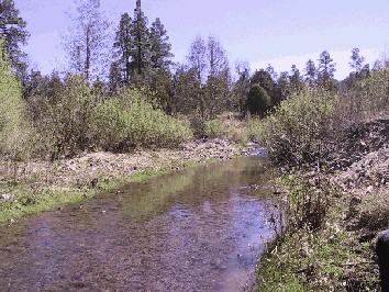

Any idea on how deep of water you can cross without damaging anything? Tractor is a Kubota 3130. My normal river crossing is only about 1 ft., but the beavers have built a dam downstream about 40 yd and the water is now about 2 ft, but no current. Picture shows low water condition. In the mean time I've been driving half mile to use the bridge on the county road. /forums/images/graemlins/confused.gif

I didn't think California left that much water in Arizona. Looks like a nice stream. I would be real careful crossing the first time. I dumped a brand new Toyota Landcruiser in over the hood. Lucky a guy with a winch was on the other side of the swollen creek...
   / Deep Water Crossings #3
AZ -- I've had my L3010 in water that came just to the top of the front tires with no trouble whatsoever. It was an accident! /forums/images/graemlins/shocked.gif But after going over the tractor with a high level of anxiety I could find nothing wrong. The only thing that appeared different was my front axle was really clean!
Gary -- I didn't know there was enough open land left in San Diego for a tractor... /forums/images/graemlins/wink.gif
Pete
   / Deep Water Crossings #4
I'm not sure on the 3130, but assume it has a front axle vent like the B2710 and some others. The vent has the bend on the top of the tube that would help prevent a lot of water from getting into it, but I wouldn't want to get in deep enough to submerge that vent to test it. If I did, I'd probably be changing the oil in the front axle. /forums/images/graemlins/smile.gif
   / Deep Water Crossings #5
<font color="blue">...how deep of water you can cross without damaging anything?...</font>
I cross our creeks all the time, up to the top of the front axle... I haven't tried covering the front tires like Boondox.../forums/images/graemlins/blush.gif Don't think I want to... my front tires are 24"... /forums/images/graemlins/shocked.gif
Obviously, make sure the creek bottom is stable/solid and not muck... and go like a bandit... /forums/images/graemlins/grin.gif

Bird hit the vent thing, but a little more on that: if you have a hot or even good n' warm casting, dunking it in water could make it suck in it's breath, just like you do when you dunk yourself in cold water. /forums/images/graemlins/blush.gif If the vent is under water, it will suck in some water. Diffs on trucks sometimes have extended vent tubes - if you want to dunk your axle regularly, as in not driving 1/2 mile away to cross, it might be well to try to extend the vent with a piece of tubing - stick a little in line lawn mower fuel filter on the ends of the tubing to seal out dust and crud.
