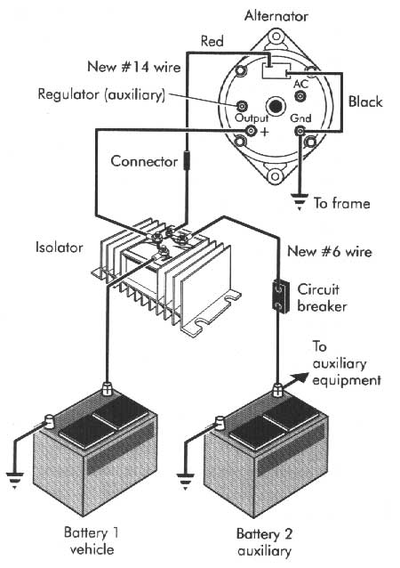

You can do it both ways but remember, 2 batteries equals twice the problems. A $10 set of jumper cables you already probably own is very simple for a limited use winch like you are planning. It can also be uses to start a dead tractor or the truck itself off the winches battery if needed. How will you keep the winch battery charged so they are ready when you need it?
They make battery isolators.
East Penn 2-battery System Battery Isolators - JCWhitney
Northern Industrial Battery Isolator — 120 Amp, Model# B-120A1B2E | Energy Storage Batteries | Northern Tool + Equipment
It will allow it to charge off the trucks electrical system when running but not back feed to the motor for starting. I think they are about $45. Much like charging the battery on a trailer for the electric brakes. Just make sure its relay controlled and only powered when the truck is running or it may drain the trucks starting battery and leave you stranded.
Chris
