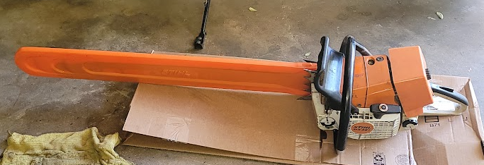

Picked up on a Stihl MS461 a couple months ago. It does not have a decompression valve. It's easy enough to pull the plug. The top cover has the hole for it.
Sawzilla, HL Supply and others have inexpensive aftermarket valves.
Pros/cons for OEM vs aftermarket?

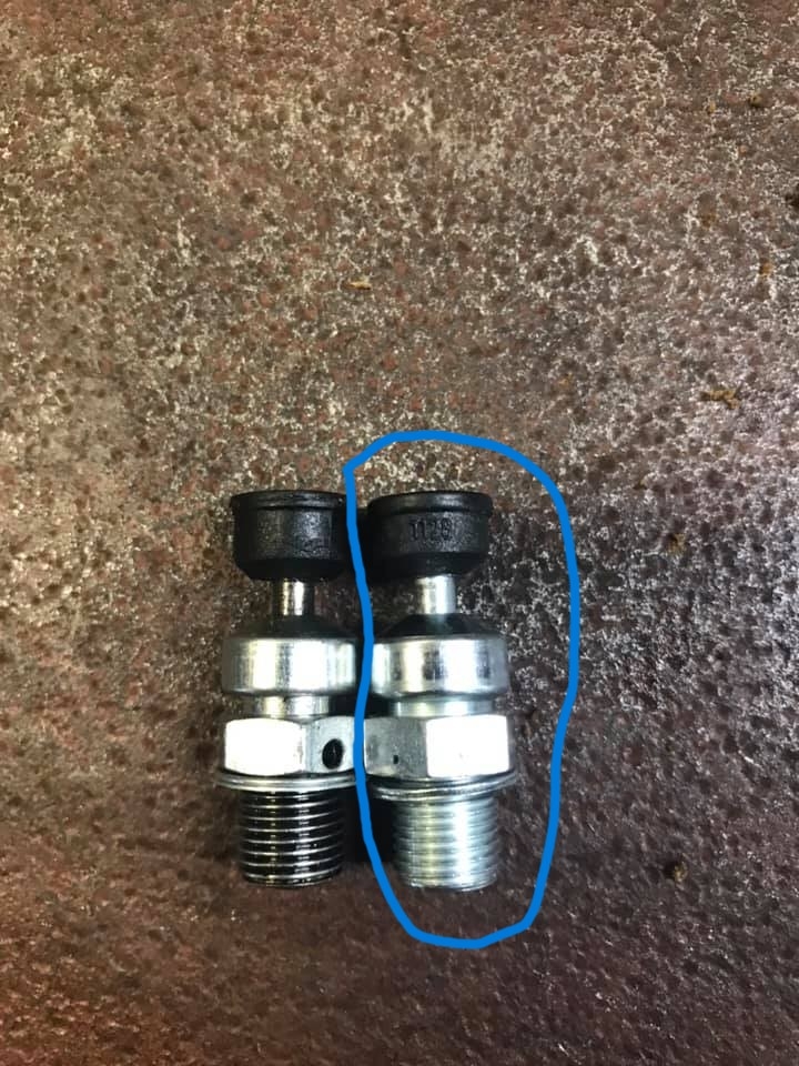

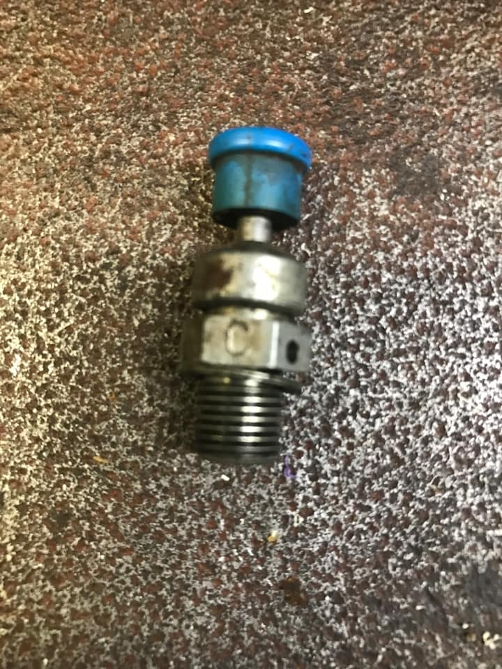

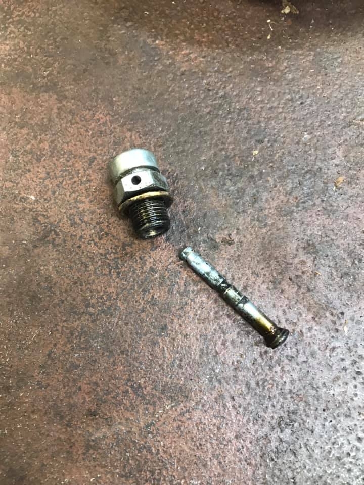

What makes the Husky version better?
Bigger outlet and seen way less failures from husky.
I'll try and show. See holes. Blue husky. Then on right of the black top stihl one compared hole size. The one it is beside is afm one taken out.
Long as OEM stihl use it. But if replaced IMO get husky one.
I plugged them on my 361 and G366 as they were easy to pull over compared to bigger saws. Using decomp plug for 2 bucks.

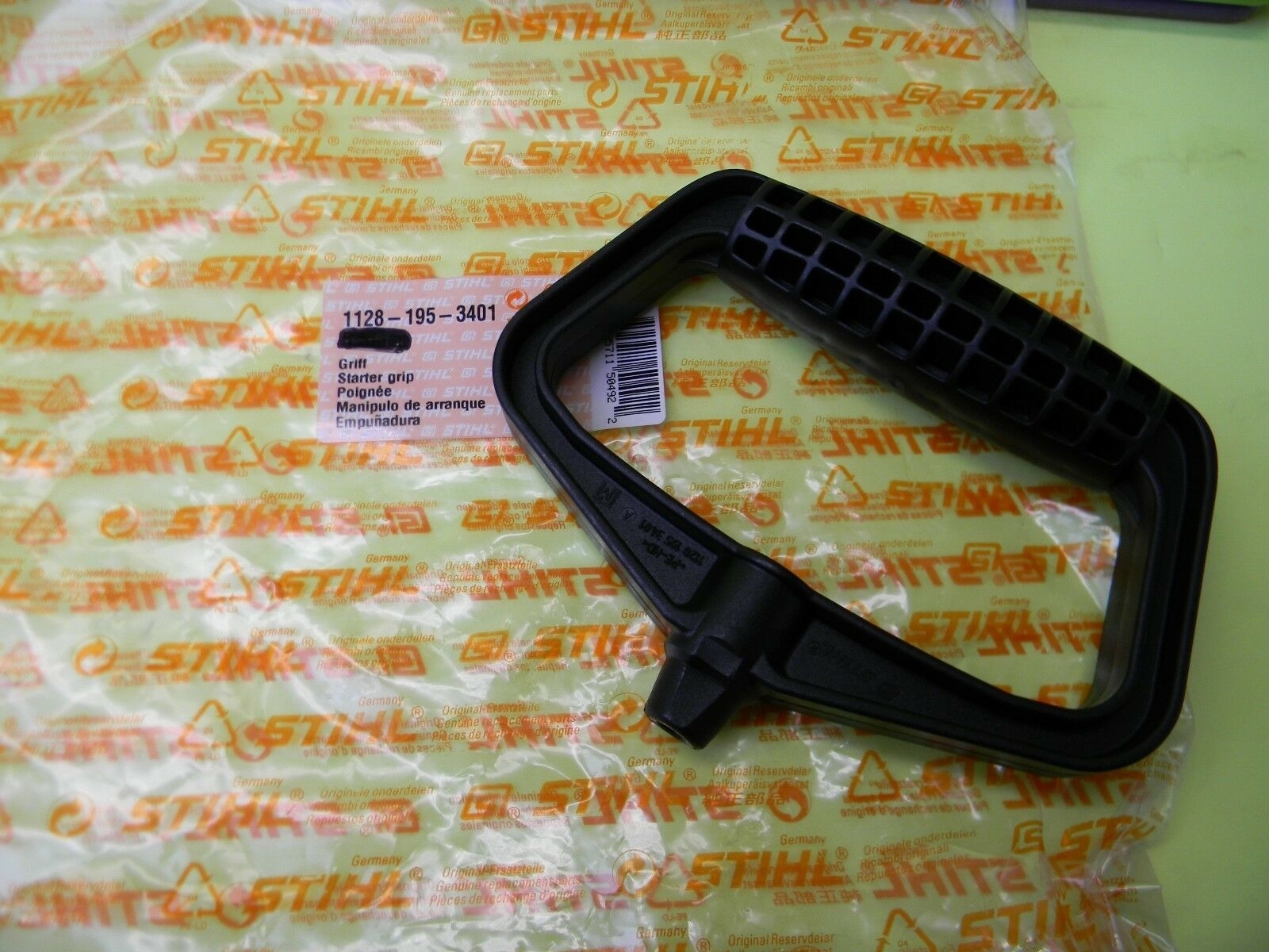

Decomps for small saws good if you have broken ribs or other shoulder hand issues.
I had to put a stihl 460 rescue handle on a few older guys saws. My dad included. Then he no longer could do that. So I gave him a EZ start 180 I got in trade.
