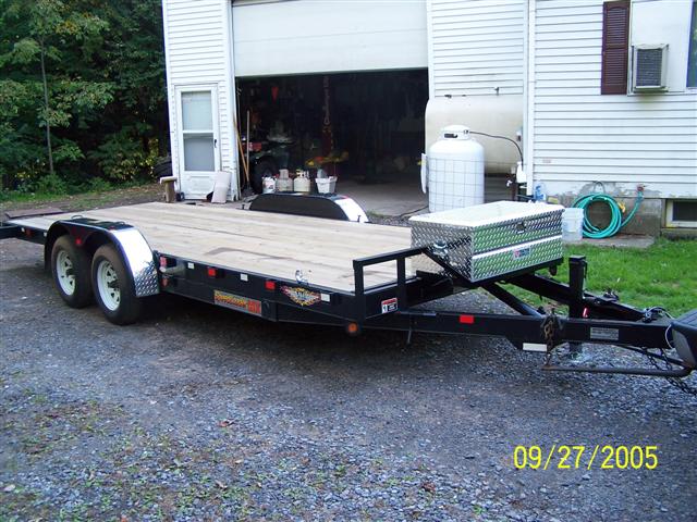

Andy,
I have a trailer made by H&H. Its 8.5 x 20" tilt bed with removable fenders. Its low to the ground, dbl axle w/single wheel, 22" deck height, 6"&5 1/2" Double frame and I Tow it with my 2500HD & Duramax. I only required the 7K size but they have higher capacity units. There's a few more pics of mine in the photo section under other / Mahindra. Their site is HHtrailers.net. Mine is the Speedloader MX.
