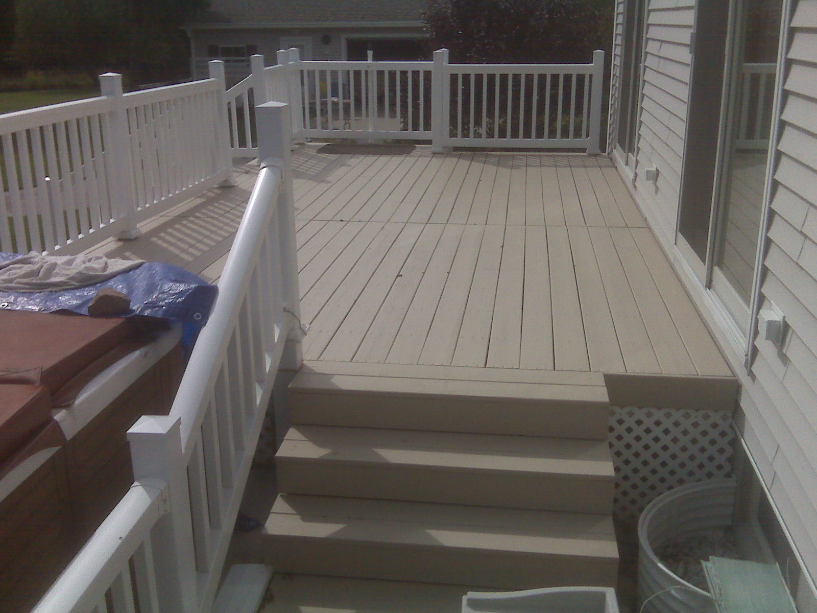

About two hours ago, I finished putting the second coat of stain on my big deck and stairs. I first primed about 40 square feet of bare wood and places where the 5 year old stain was thin, then applied two thick coats atop that, each one a week apart. The coverage the stain I chose amazed me, counting the prime coat on the bare spots as 20 square feet per coat, I covered a very closely measured 320 square feet each time. And the amount of stain I used for the entire project was less than A GALLON AND A HALF, TOTAL.
I have used this stain in the past, and cannot say enough to praise it. A little goes a long, long way, it levels easily, and dries so fast you can walk on it in an hour. A custom mixed gallon at Lowes costs about $35 with tax, and it is worth every penny, and then some.

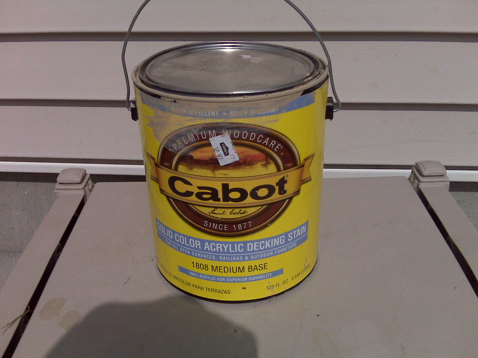

Label on the can of the stain I used says coverage is 150-250 square feet per gallon, I was amazed at how much coverage I actually got.

There were a lot of areas on the deck that the stain had been worn away from because of snow shoveling, etc. Meant I primed the bare spots with the stain, so the topcoats would level properly. Since the stain I used was acylic water based, it doesn't really soak into the wood like an oil base product would. Calling it "stain" is somewhat misleading.

Agree with you there...a solid color, as the picture of the can of "stain" I used, is basically paint. To me, real stain changes the color of bare wood, and can ONLY be applied to bare wood, or over itself.
