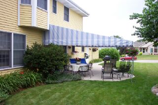

I've attached a picture of the awning that we had put up last year. It's 17' X 17", but it certainly could be larger. This first picture shows some of the frame work used to hold it. The framework is galvanized pipe, although I don't know what diameter. I can get that for you if it would help. The company that installed it takes it (the awning) down every fall in late November and then re-installs it in late May or so. The framework is permanent. That service is included in the price and stays with the awning, so if we sell the house, the new owners get the service. The fabric is a mid weight canvas that is water proof. If we wanted to, we could add weighted screen sides to it that attach with zippers. The whole shooting match cost $2,100.00 fully installed.

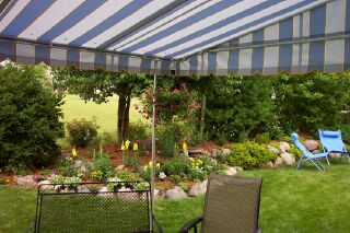

Here's another picture showing the awning from the outside.
If you would like some more pictures, let me know what you'd like to see and I'll take some. If you would like more info. about the material, etc., let me know and I'll see if I can get it for you. /forums/images/graemlins/smile.gif

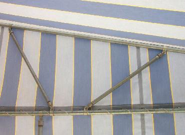

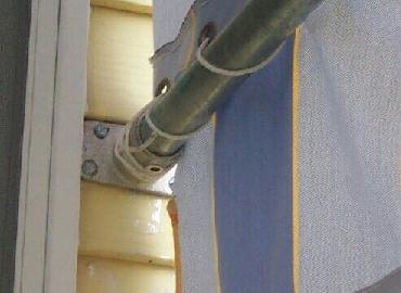

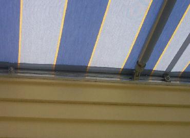

Oh what the heck. If you're going to try to build this thing yourself, you might want to see how a really good is put together. The following pictures will at least show you how our awning is basically put together. I can tell you one thing for sure. after seeing how this thing has withstood some pretty significant wind storms, I wouldn't even be thinking of building it out of anything BUT galvanized pipes! And all of the corner posts are sunk in concrete! With your planned awning being quite a bit larger, I'd think you'd want to consider that.
This first pic is of the attachment to the house. They lagged right into studs, and then the support poles are screwed into an adapter.

This picture shows the outboard corner connections. You can see a short piece of pipe that is clamped to main support pipe at the top. Around this short pipe is a nylon line that twists the entire length of the support pipe. You'll see a better picture of this in one of the upcoming pictures. That nylon line goes through each grommet and is what holds the awning to the support framework.

This picture shows the side supports. All these pipes screw into the adapters that are then clamped onto the main support pipes. You can also see the nylon line in this pic.

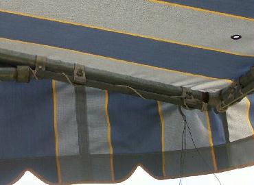

   / Deck shade options #10
This picture shows one of the support pipes coming out from the house to the the end support pipe that is parallel to the house. In our span of 17', there are 4 of these support pipes. Notice that it is encased in a "tube" of the canvas material to make it less noticeable. You can also see the nylon line that is wrapped around the smaller pipe that is clamped to the end support pipe. You may have also noticed a row of grommets in the awning. I'm not sure if they're just to let rainwater through, which really doesn't make a lot of sense, or if there is some more sinister reason for them. /forums/images/graemlins/smirk.gif
