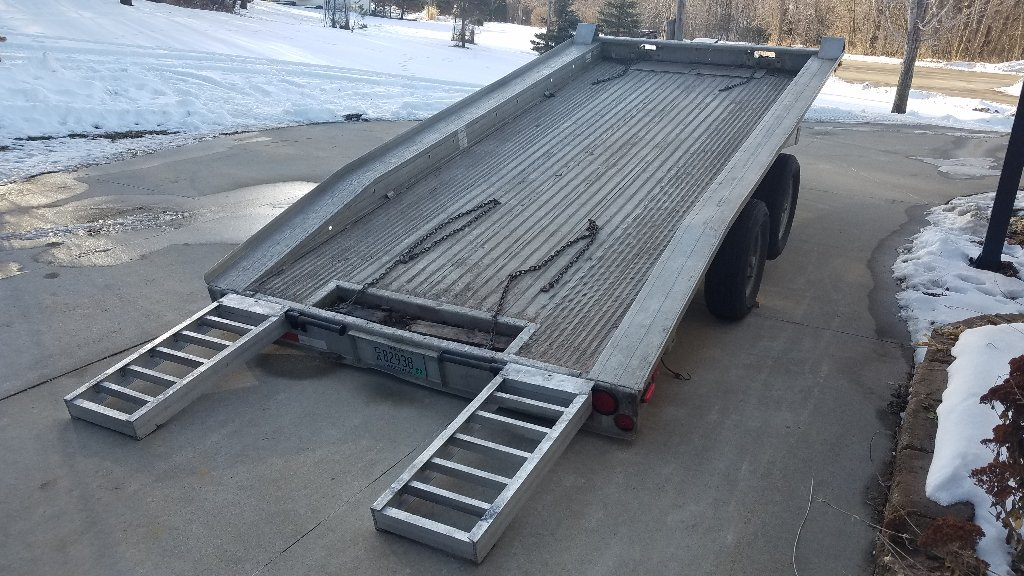

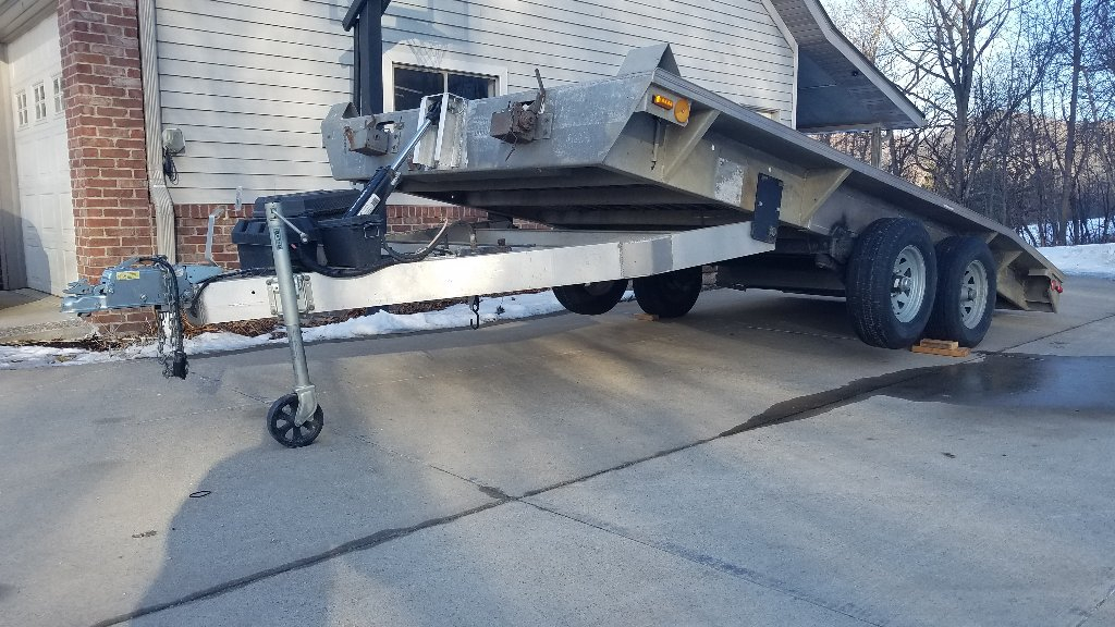

Here is reference to a the best of both that worked for me. Drop deck section is about 74" and overall width is 8'. Lower platform height gives lower loading height of about 26". I use some wooden bunks to set mower/snow plow on so I can use the full 8' width. Wider vehicles can be driven on the entire side rail. This was a used trailer that I upgraded with new axles & hitch a few years back. With the tilt-bed, I absolutely love it for UTV, tractor, skiddy etc.

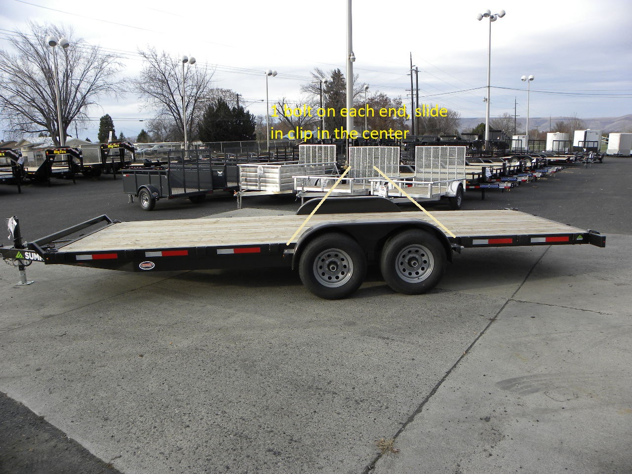

The trailer I have is an 18' car hauler with removeable fenders. Two bolts per fender and they come right off. The other option I've seen is fenders of a heavy diamond plate that allow a vehicle to be driven over them.
This is the same as mine, 18' long a full 7' between the fenders, 8'6" total width. The lines point to the two bolts that hold the fender on. I paid $3500 out the door in 2017, the one pictured is a 20' with the same GVW of 9900 and is listed at $5895 on the lot. Tare weight of my trailer is 2300#. The only thing I wish it had is some kind of jacks on the back that would keep the tongue (and pickup) down when loading something heavy. As it is now I use cheap Harbor Freight jack stands to accomplish that.
