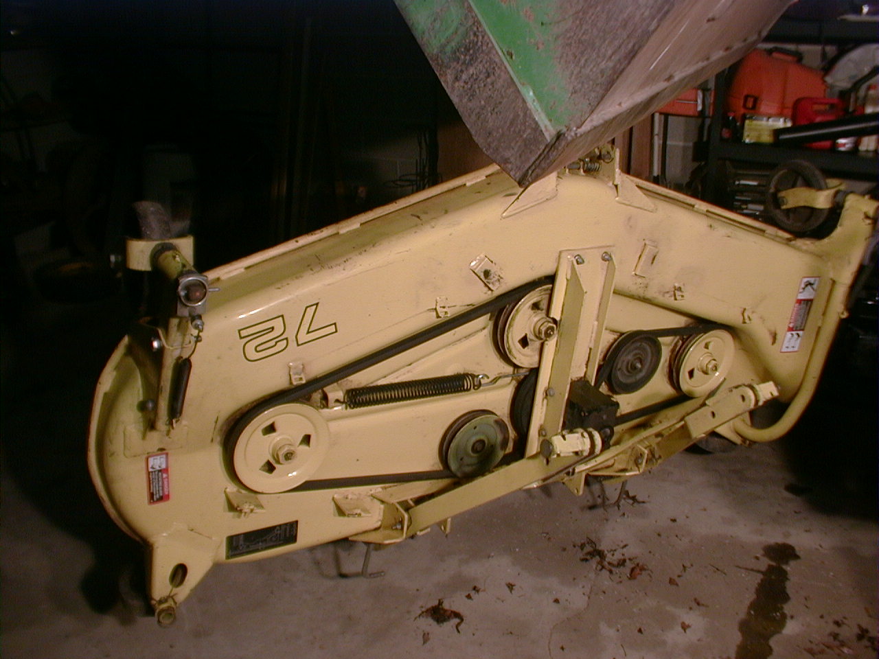

First time poster, longtime follower. I have a John Deere 955 with a 72 inch deck. Unfortunately, my gear box on the deck just failed. My guess is that it had a leak and I didn't notice, neither did the dealer who serviced it 2 weeks ago. I tried to find a replacement gear box but my part number AM106078 for my model M00296X575247 deck is unavailable. I did find a used 72 inch deck about 1.5 hrs from where I live but its from an 870 tractor and deck model # M00297X100997. I called 2 local JD dealers to see if the deck off the 870 would work on my 955. One said yes, the other said no. JDparts seems to indicate it is compatible.
Just wondering if anyone could give me a definitive answer. Any advice would be appreciated.
Thanks, Dan
   / Deck compatibility: John Deere 870 to 955? #2
Where are you located. I have a 72 mid-mount deck that I used on a 1070. I used it 1 season but it interfered with hay making so I now use an 84" rear mower for the fields or another 72" deck in my F-935.
That being said, I'm surprised that you would need a whole new gearbox. Why not just some new bearings and a gear-set if necessary ? As I recall, these gearboxes show up on ebay a lot. What helps is to find a seller parting out a whole machine and contact them to see if they have a gearbox, if that's what you want.
Also, the 1070 mid-pto is 2200 rpm as is the F935's. Is that your use ? or is it a 72" rear mounted deck running at 540 input pto rpm ?
I'm in Michigan if that's anywhere near you. Here is a shot of my deck. Covers are off to show the drive-line. PIC00025.JPG

BTW: Isn't a 955 really a 970 with a hydrostatic transmission ? And, a 1070 is a 970 with a 4 cylinder motor instead of a 3 cyl. The 72: deck fitment depends on the tires you have because the largest available tire set may not have enough F/A clearance when the fronts are steered. If you have a 72" mid-mount working with the tires you have, everything should work. Any new gearbox needs to have the right gear ratio.

OK, so the 1070, 970, 870 72" mid mount deck has 25/25 gear teeth part nos: AM143307 for both. Funny, the gearset for early 72" decks was 26/25 teeth (which are no longer available). The replacement gearset is 25/25 teeth Part nos. AM107718 for both. Not sure what the difference is, but maybe shaft diameter or age.
But: I'm seeing parts available to rebuild your gearbox. (yeah, seals, bearings, shafts and shims are available too, depending on how much wreckage took place.
