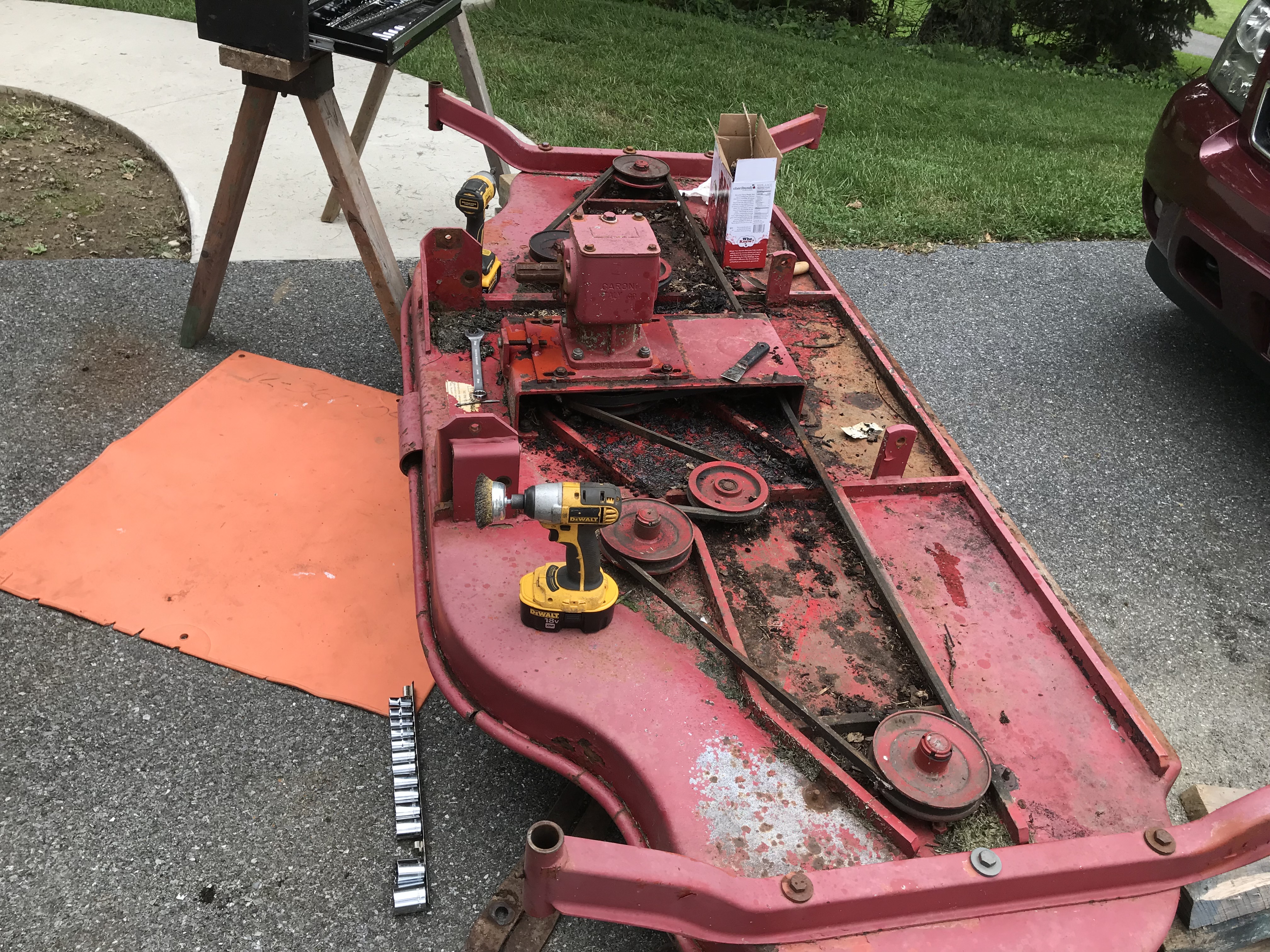

Learned that lesson myself. That's why I too a bunch of pictures before stripping the deck for rehab last year. It would have been bad enough if the work could have been done in one or two days. With all the pieces, it was nice to have a reference picture.
