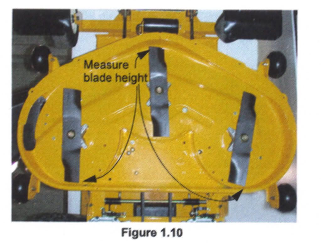

I found a picture of the bottom of the Z-force 44" deck in the service manual and I see that it has a baffle. The 50" deck has that area formed in it and the discharge area is larger.

Yeah that's my deck. I was curious if removing the baffles would give me a less fine cut, less recirculation. The coarser the cut grass the heavier it would be and maybe too heavy to cling to the bottom of the deck. The neighbors don't have baffles and the discharged grass is much coarser. It is much more obvious laying on top of the ground, especially the next day as it dies and turns dark brown. But at least they're not laying under their mowers after each cut scraping and cursing, like me. Thanks again for the reply. I'm fixing to go out and cut the yard, again! If you're anywhere near middle Tn. and hear somebody yelling in a little while you'll know who it is.

If you remove the baffle you might lose the suction required to lift the grass to get a clean cut and it might not be able to move the clippings to the discharge chute. I think it would just cause you more trouble. Ny father-in-law applies MopNGlow floor wax to the bottom of his John Deere deck every time he cleans it. I have seen the bottom after several cuttings and it is cleaner than mine.
