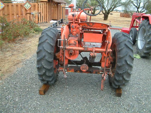

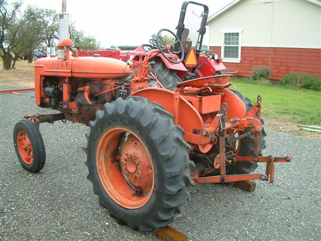

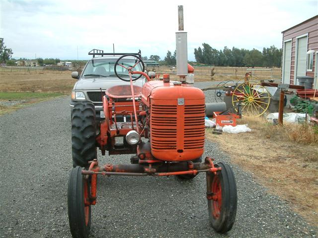

Since you didn't mention that you need/want a front end loader (FEL) and you're doing a few small food plots, you could get by with a smaller tractor than the MF135, 240 or Ford 3000. My 1951 Farmall Super A ($1300 including a rear scraper blade, 3pt hitch, 6-ft mid-mount sicklebar mower) could handle your jobs with no trouble. Parts for these old Farmalls are easily available on the Internet.
DSCF0126 (Small).JPGDSCF0127 (Small).JPGDSCF0128 (Small).JPGDSCF0129 (Small).JPGDSCF0130 (Small).JPG
