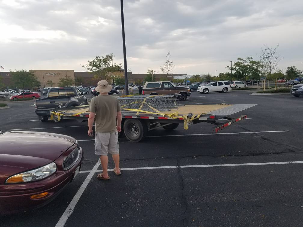

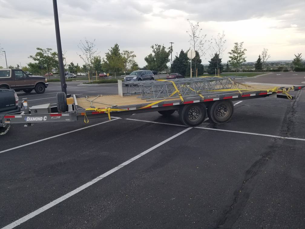

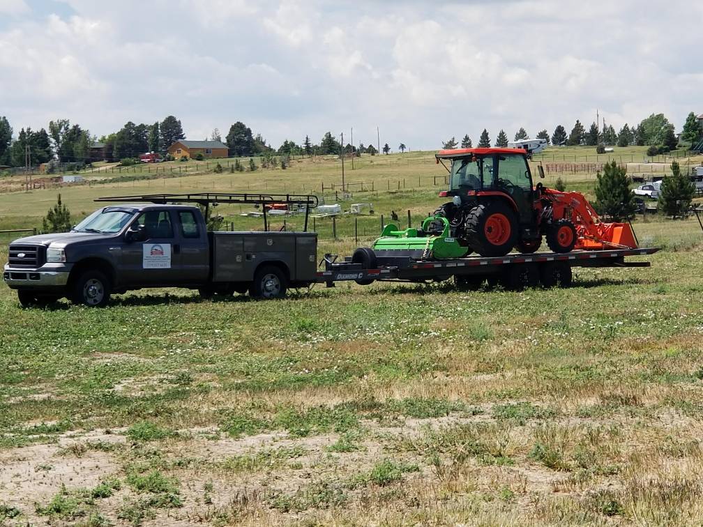

I really like my 22' Dismond C power tilt deckover. Steeper to load a tractor on than my old tiny gravity tilt but so much easier to load stuff over the side.
I have 5k of tractor & 2k of impliment on generally. Add that to 4k of trailer & it leaves plenty of safety margin even if I add another impliment. I paid double for the trailer that I paid for the old beater high mileage F250. I'd feel better a out pulling more than my current load on a truck with a tighter steering box, but it tows well as is.
The trailer tows beautifully behind my Tacoma. A 4k empty trailer behind a truck with a tow rating of 6.5k means i only use it for very light loads. I'll use the Taco over the beater F250 if things fit for any longer hauls though. Both trucks are going to be liquidated & replaced by a newer 3/4 ton in the next few years. 20170909_182455-1.jpg20170909_182506.jpg20180618_122125.jpg

That is exactly the style trailer I'm talking about. What length? and when loaded with tractor do you feel you need to slow down on back roads because of turns and bouncing?
