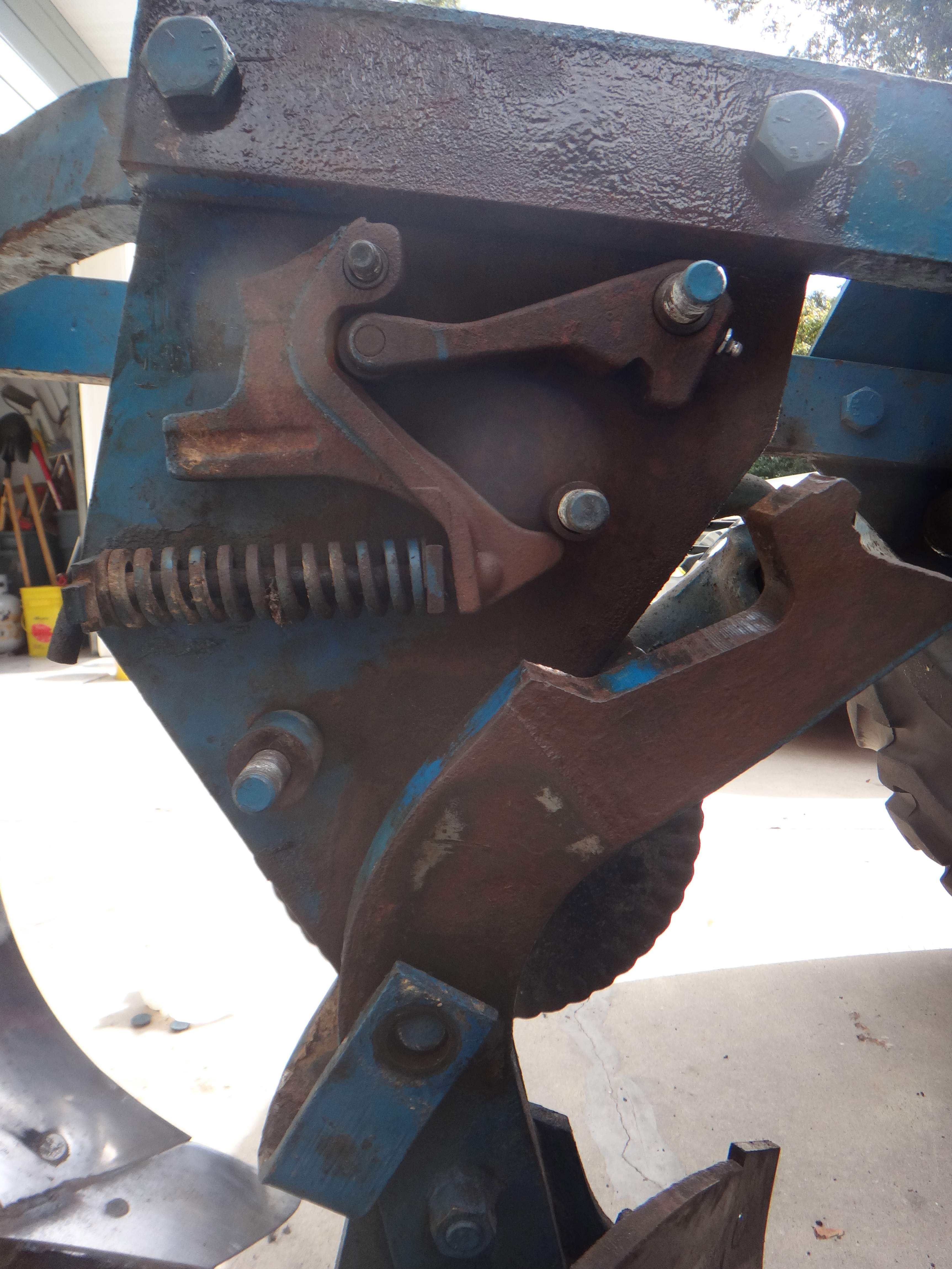

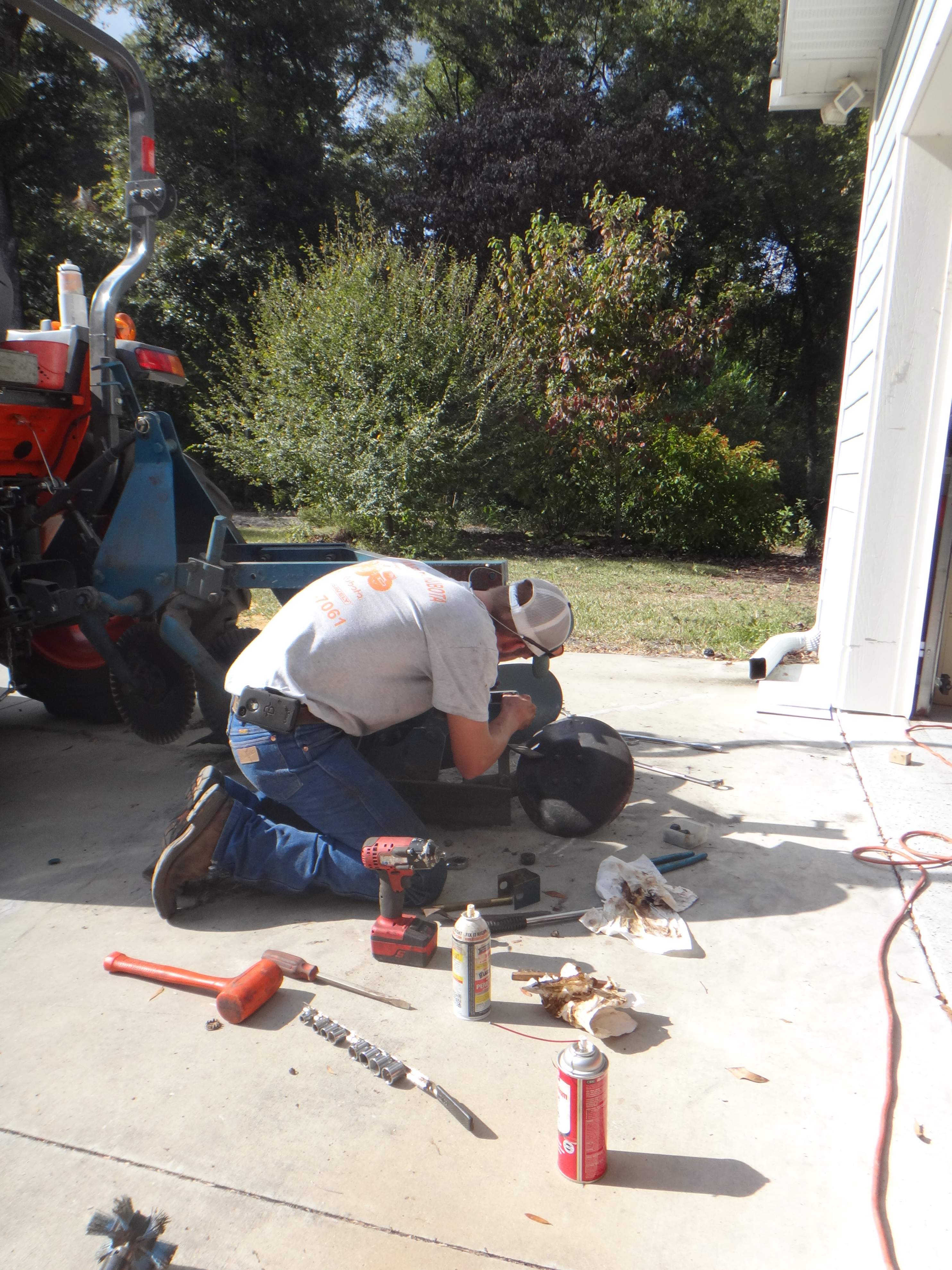

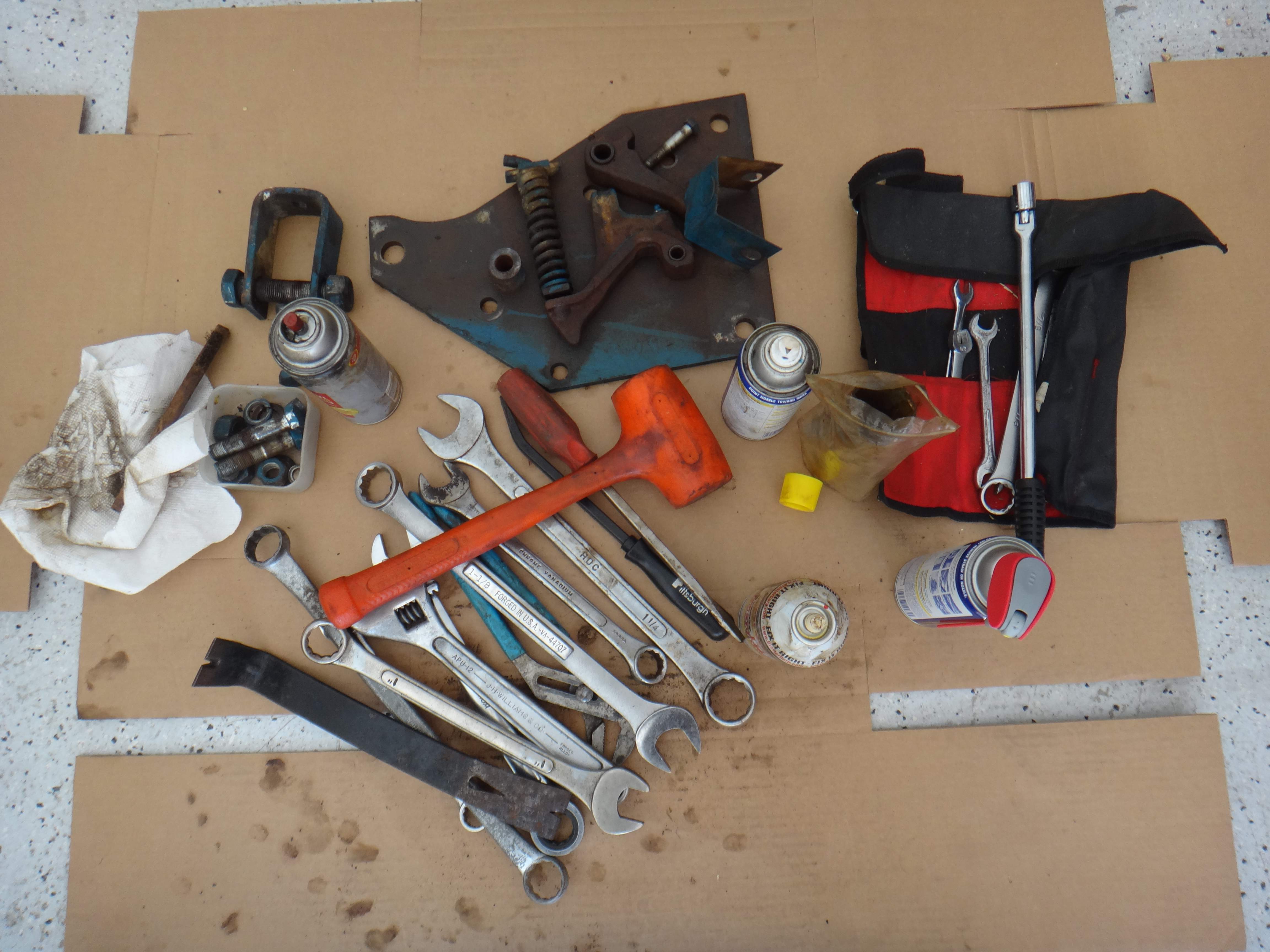

Old trip plows generally have to be opened up, cleaned and lubricated before the trip mechanism will reset after tripping.
If you have Draft Control as well as Postion Control as part of your Three Point Hitch hydraulic system, the plow and tractor operator are reasonably well protected from underground obstructions. When adjusted properly, Draft Control will lift the plow automatically when it encounters an underground obstruction.

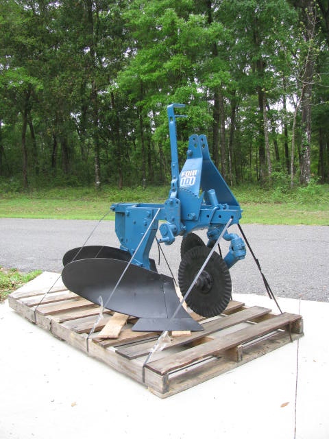

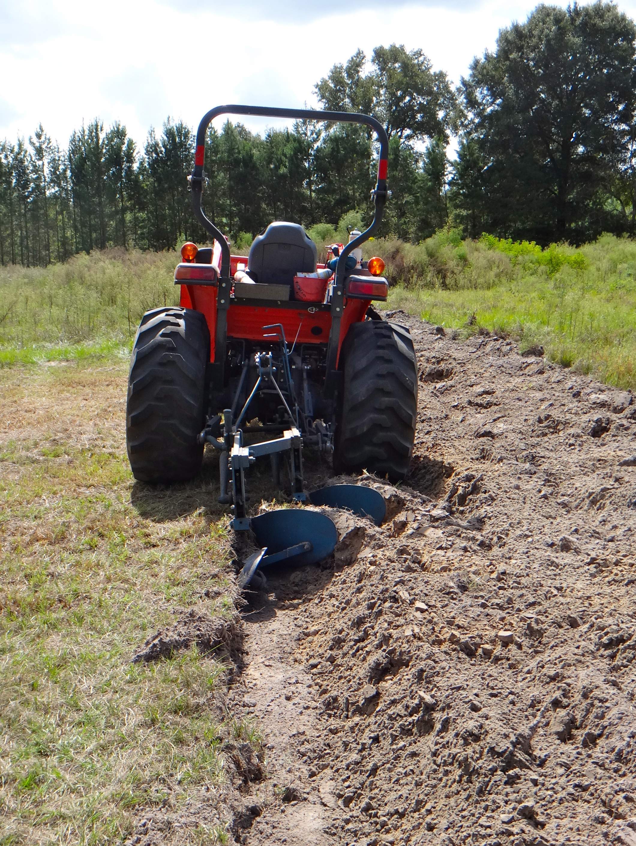

PICTURES: Ford Series 101 Trip Plow, 2-12", probably made by Oliver for Ford. Cleaned and lubricated once, has worked perfectly since, with annual greasing.
