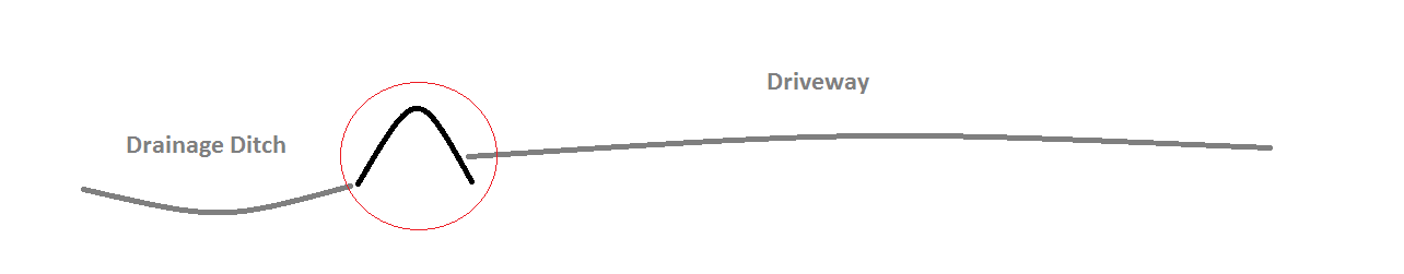

What would it cost to lay a concrete curb type of thing to keep the runoff in the ditch and off the gravel drive?
Maybe some other material. RR Ties?
Only if I could prepare the ditch by widening or depending it. It's just a ragged thing now, highly variable depending on proximity of bedrock or other large rocks. There's also a long segment I need to dig out that filled up with gravel from past washouts, and which I can only approach from the driveway side of the ditch (so the tractor (no backhoe) can't scoop the material back into the driveway). There's also possible problems with clueless snow plows damaging such a curb. (I haven't taken up winter maintenance of the driveway yet, maybe someday, it's so hard to hire people who actually care about the quality of the job they do).
No, we had a whole long reply thread somewhere on the forums here about ways to improve the ditch without enlarging it (and cement was also discussed). Now I'm just wondering what it might cost for me to have the tools to really deepen/widen the ditch, In addition to the stone/bedrock problems, is lined with mature trees at its banks in some places, as the driveway goes through the forest. Fortuntely there aren't many trees that are both within a foot of the ditch where the ditch is also most prone to overflow or wash out the gravel.
The driveway might also benefit by having one or more more culverts at the places peak wash occurs. It has several now, but I can think of one place where installing a new pipe under the driveway would be a potential win. Once again, a digging problem likely complicated by bedrock.
