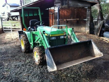

Thank you for the comments regarding the retaining wall. I have been concerned about the points you raised and the possibility of it ultimately leaning or falling over. I have posted pictures (if I've done it properly) as part of this post. You can see more in my album Project 1 and pictures of my tractor showing the progress of the project.
The tractor is parked on the crown of the slope so water draining towards the barn/shed and either breaks in front of the tractor or behind the tractor. Behind the tractor it drops about 2.5 ft to the gate and the left (open) side of the shed. During extreme rain we have running water flowing around the shed (once every 2 to 3 yrs). In the past I have had to trenched by hand to prevent water inundating the open shed area on left behind the tractor(goat stalls and hay storage).
The other picture shows a tight shot of the primary excavation. Stakes with pink twine marking back side of the walls . The walls will form an open L with the base of the L about 6 feet and the vertical of the L about 8 feet. I plan to auger a post hole 2.5 feet deep next to the gate post and place a Railroad tie upright on a gravel base and then pour concrete. At that point the soil behind the wall is 24 inches above the working grade. (3 ties high). To the left about 6 feet I'm going to install a second RR tie as a corner post ? if you can see the string lines they cross at this corner). At this point it is 36 inches above working grade (4 or 5 ties). I have some 2 inch heavy angle Iron I was planning lagging to the upright posts/RR ties. Before I drop the approx 5.5 ft horizontal RR ties in behind the angle iron I was going to place a bed of gravel 3 to 4 inches deep beneath the first RR tie to allow water to perk from behind the wall. I was also going to line the back side of the RR ties with 6 mil plastic. Then I was going to back fill with gravel. Although I was also debating about lining the bank with plastic and backfilling with gravel between the plastic and up to the RR ties. Not sure which would be more effective long term.
I Plan on using the left corner post for the first leg of the wall to support four 8 foot RR ties to form a wall to the left (off angle from the gate and first leg of the wall to form the vertical in the open L) . You may notice the Doug Fir tree in one of the pictures This tree is determining the angle and distance for this second portion of the wall. I plan to end this wall with another vertical RR tie and possibly 2X angle iron. I may also run a third portion of the wail on up the yard and tie into to steps (to be installed on a later project) onto the lawn area. Or start a stacked rock wall, which was my original Idea for a wall as I have 4.5 acres of rocks here. I figured the rail road ties would be a faster and easier on my back and fingers rather than move 100 plus rocks.
I am going to have a tree professional come and look over the trees around the house and get a opinion about leaving that Doug Fir. They can grow to 4 plus feet in diameter. This ultimately will push over the wall. My wife does not want to cut anything down (even the widow makers:laughing:).
I appreciate your comments, suggestions, and questions:confused2:
