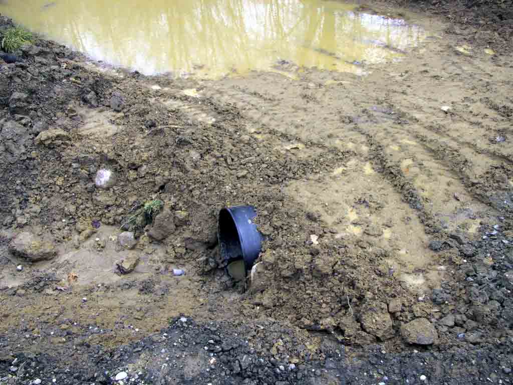

Like this ? (attached)
The area in the picture is the tie-in from the new driveway to the old driveway near the house. It's near the bottom of a 250' slope - so all that water is draining down towards this section of drive. I had to remove 12"+ of topsoil to get down to the exisiting clay.
I then backfilled it with clay from the polebarn pad (part of the way there in the picture) I drained the puddle you see in the picture and added some more clay and compacted it.
We then laid geotextile and put down 10" or so bankrun gravel and coated it with a couple of inches of crusher run. This section of driveway is now marginally just above the surrounding grade ...... and it is almost like concrete. Initially it was very spongy - until the water had a chance to drain. Our trash hauler now drives over it every week with no problems with a fairly large compactor truck (dual rear wheels)
The point is, clay is a fine material for building a road on - you just have to get road/driveway above the surrounding grade and provide adequate drainage.
