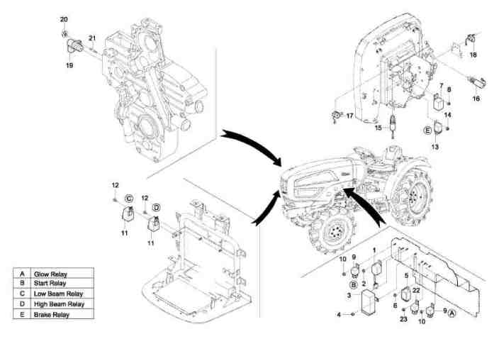

Guys and girls keep in mind if you need parts break downs I can email them to you, but please don't ask for the complete parts book through email.
I don't mind a couple of pages.
   / DEALERS: Simple Question
Ahhh... Nice.
If this is representative of what's in the shop manual and parts manual, then it will be much better than flying blind. Not a bad investment (about $100) to have the details on your $15K investment.
Thanks for the picture Rick.
I almost called you this past weekend as I know you're open on sundays but didn't want to become a nuissance. I'm giving my dealer a chance first -- I think the key will be for me to deal w/ the owner or the mechanic (Mike and Frank). The sales guy Tom never seems to answer my questions and then I get all frustrated and vent here on TBN! He's a CK30 owner and a good guy, just doesn't seem to approach things the way the other guys do.
Frank is the one who solved my HST vent problem and went through the trouble of pulling the tank and a bunch of other stuff to get at the vent properly for no charge even though Kioti wouldn't warranty the labor. He knows the machines really well.
Thanks again. If/when I get to the bottom of the flasher problem, I'll certainly post as much detail on what's up w/ it.
