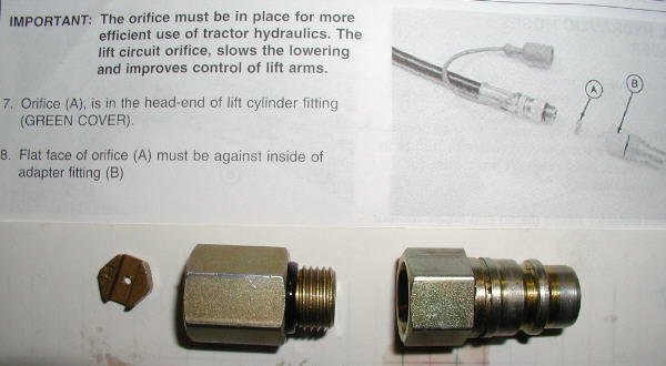

I have a 4100, my friend just bought a 4110, both from the same local dealer. My friend noticed something wrong with his, with the restrictor in the wrong hydraulic line, instead of being in the boom header line it was in the bucket header line. He kept asking me to check mine and finally i did last nite. Mine is wrong too, I am pretty sure. Going to take it off this weekend to examine and verify/correct. I can't believe this could happen, let alone twice. Oh, well, I guess dealers are human too. /forums/images/graemlins/confused.gif
   / dealer setup 410 loader with restrictor in wrong l #2
Stupid question here....what would I be looking for if I wanted to check mine. All the hoses and connectors appear to be the same. /forums/images/graemlins/confused.gif
   / dealer setup 410 loader with restrictor in wrong l #3
The setup manual on 410 and 420 loaders show the orifice installed on the # 4 line (Green) between the male coupler and hose end.

One of the lines, at the male end, will have an extra fitting in it. I will photo and post tommorrow.

Here's the photo I promised. I changed my restrictor over today, it was pretty easy. Loader works a little smoother. /forums/images/graemlins/grin.gif
