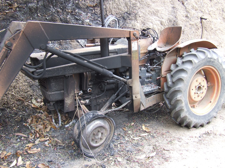

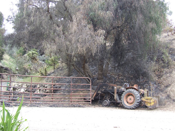

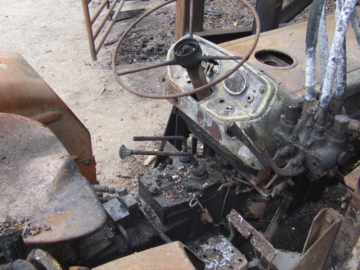

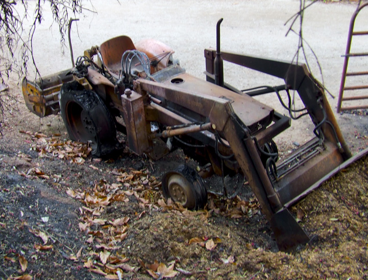

I lost my L245DT in a recent wildfire (California) and I need to replace it. It had a FEL and TnT Gannon . It served me well and I've got to find a replacement.
