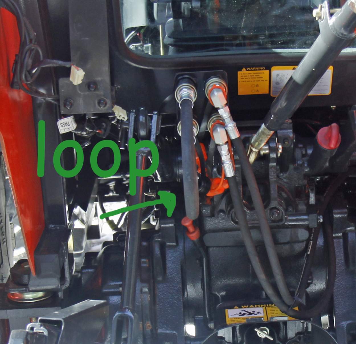

Just as a side note.. If you have levers that can lock in a detente, you should install a loop of hose when not in use. By running a deadheaded hydraulic pump you can destroy the pump. It doesn't take long to do that either. Glad the loade is back working again.
