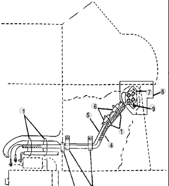

There is a dead spot on the starter of my 1050. I have had the starter rebuilt twice in the past few years, and the last time the guy said the problem is low voltage. The battery and alternator are in good condition. The tractor never fails to start after umpteen tries, and the last time we attached jumper cables which gave a magical boost. It has been suggested that the problem may be a bad ground, or a bad connection somewhere, and that sounds logical. I can methodically clean and tighten all the wires, but is there a particular wire or particular circuit which should be my first target?

With a helper sitting in seat to depress clutch short across top terminal & S terminal on solenoid. If tractor starter engages then I suggest to add a relay that will send higher voltage to S terminal. JD introduced a kit(photo below) but you could fabricate the wiring. Relay only from JD or auto store is about $25
