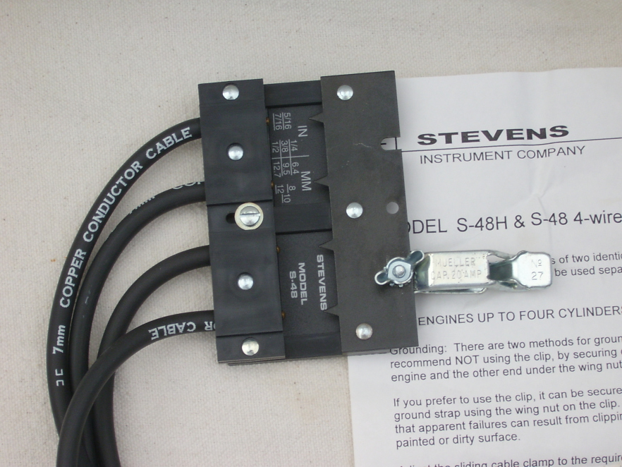

/ dead no spark at plugs #6
I like this type!!
