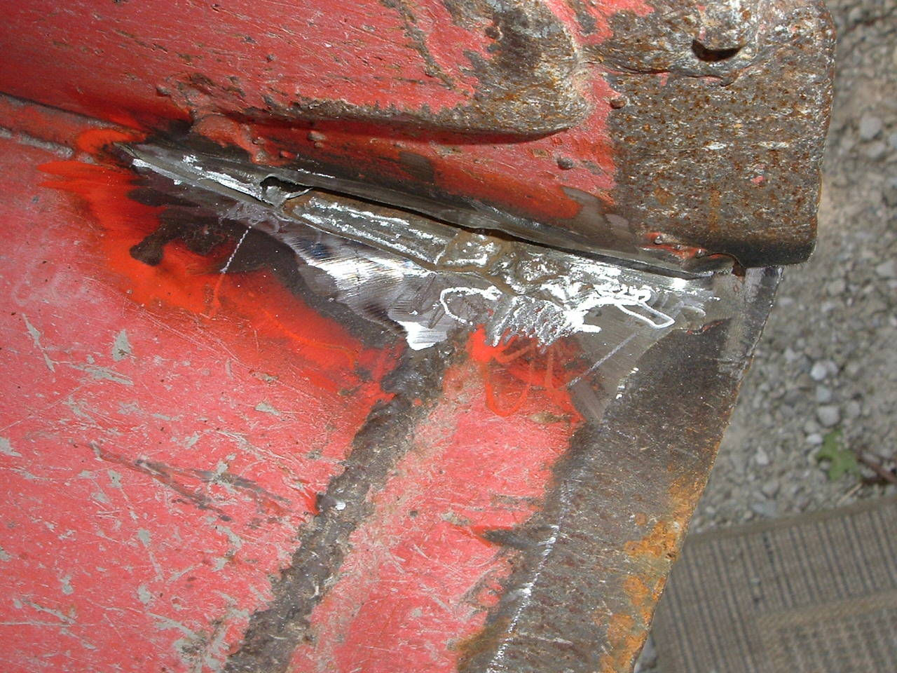

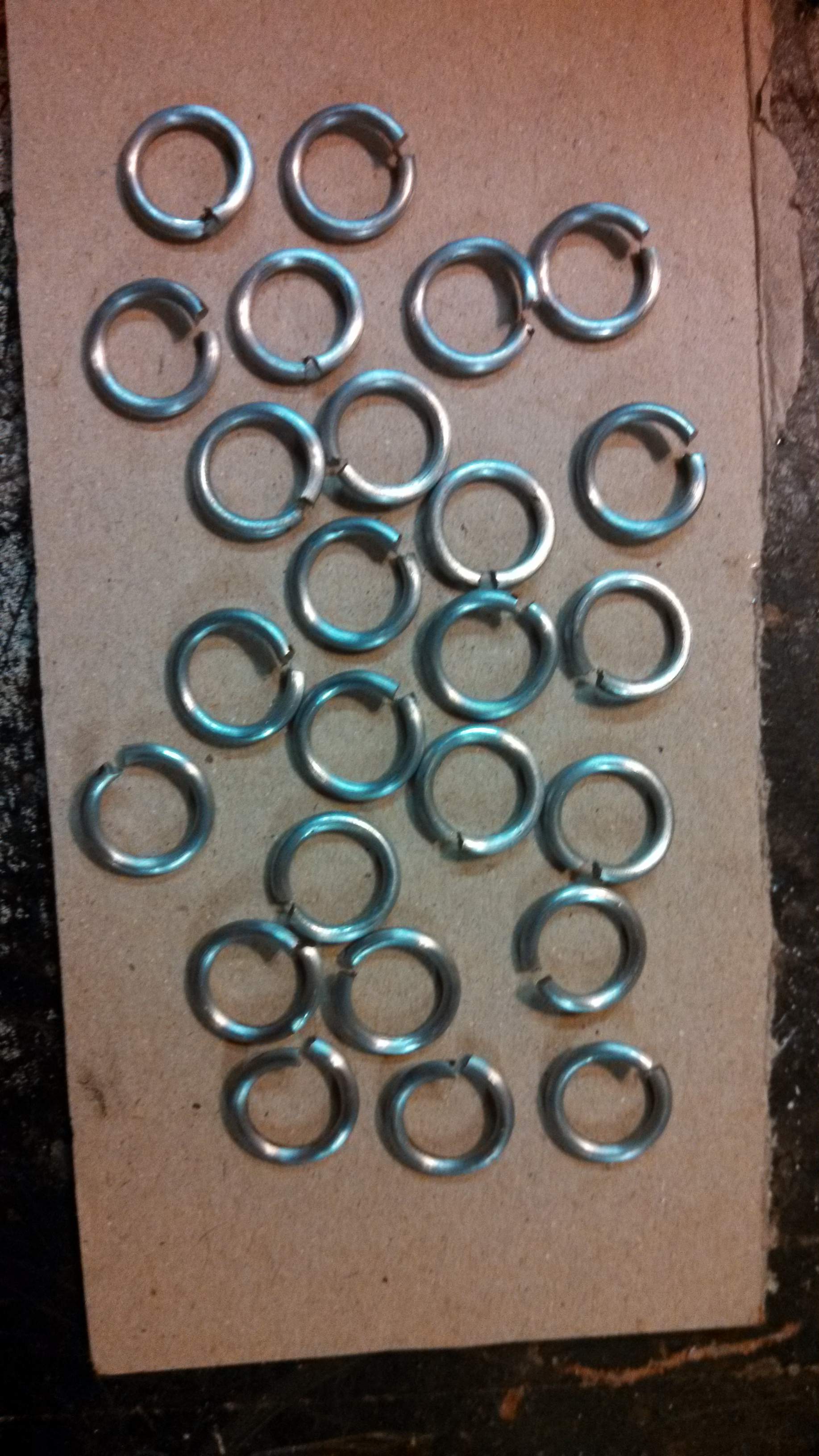

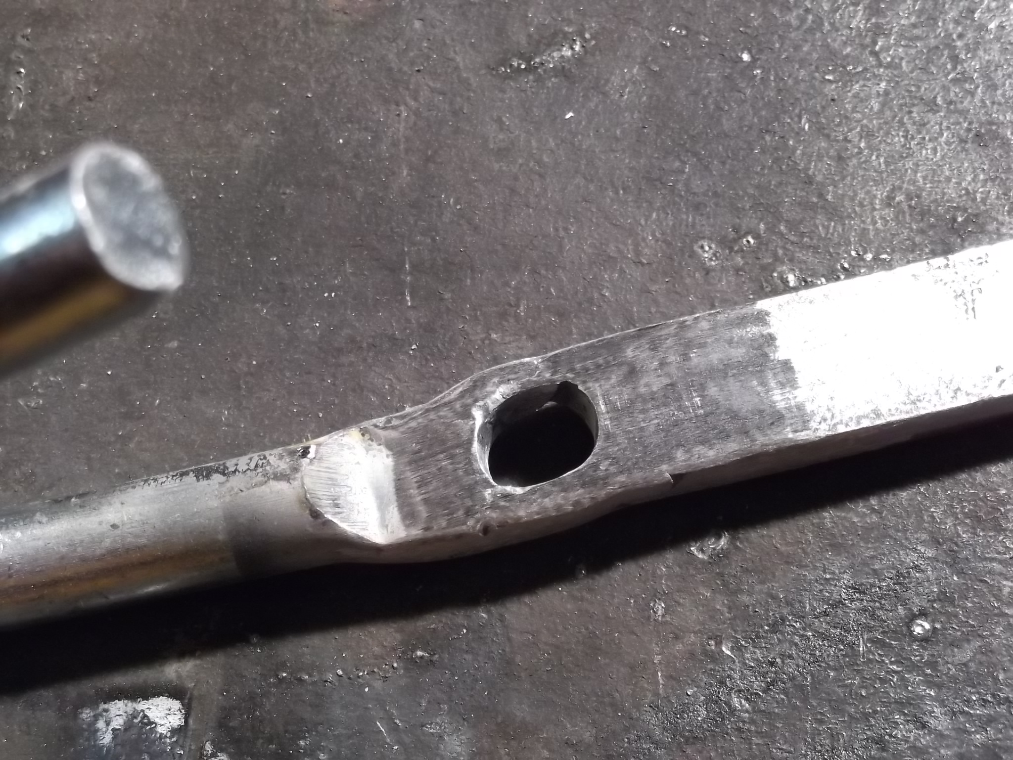

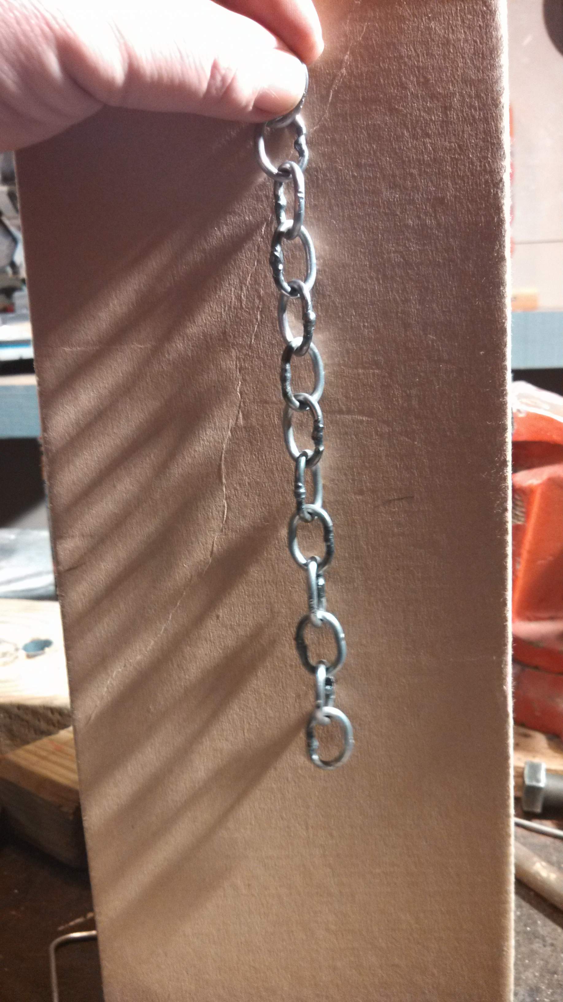

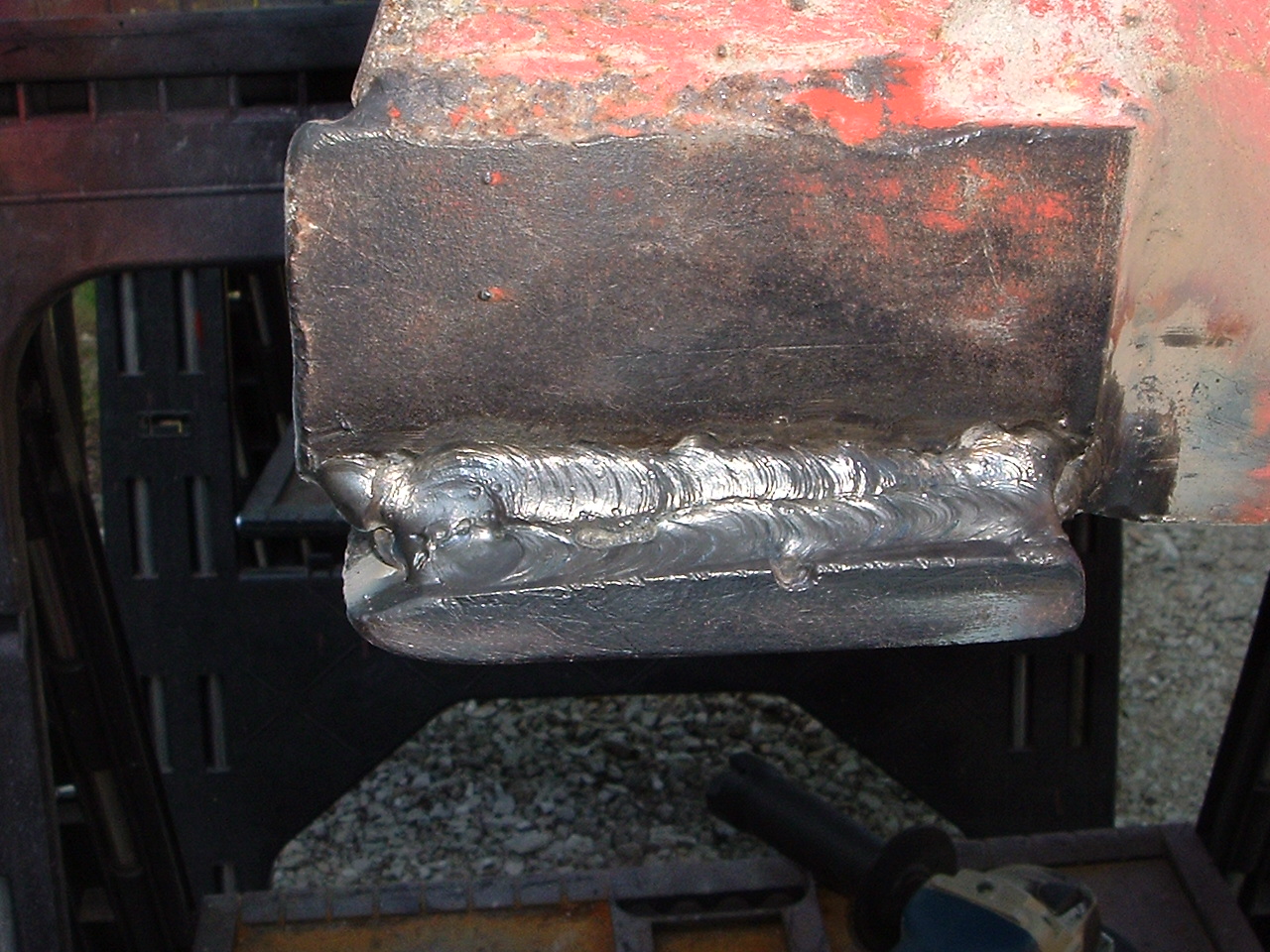

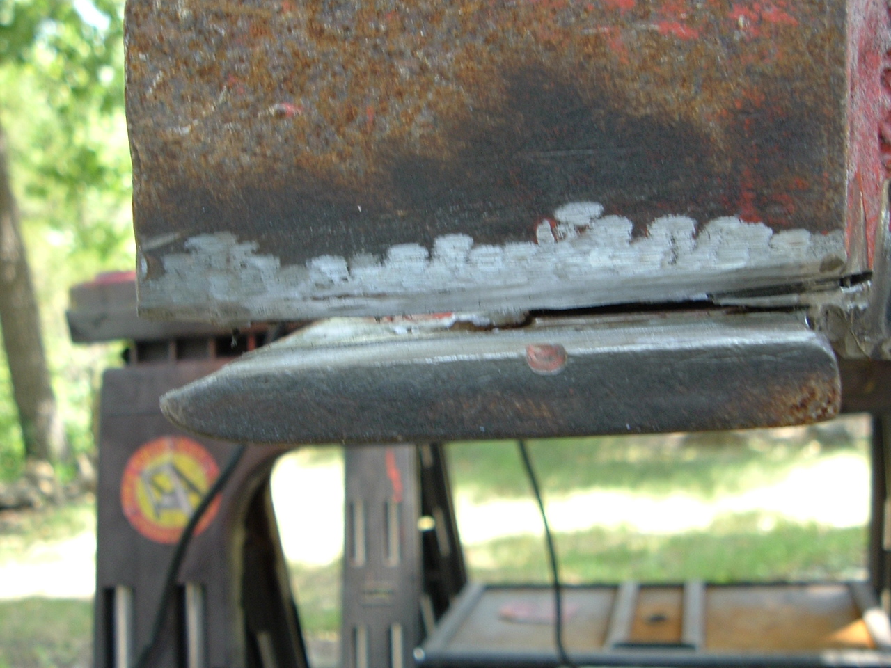

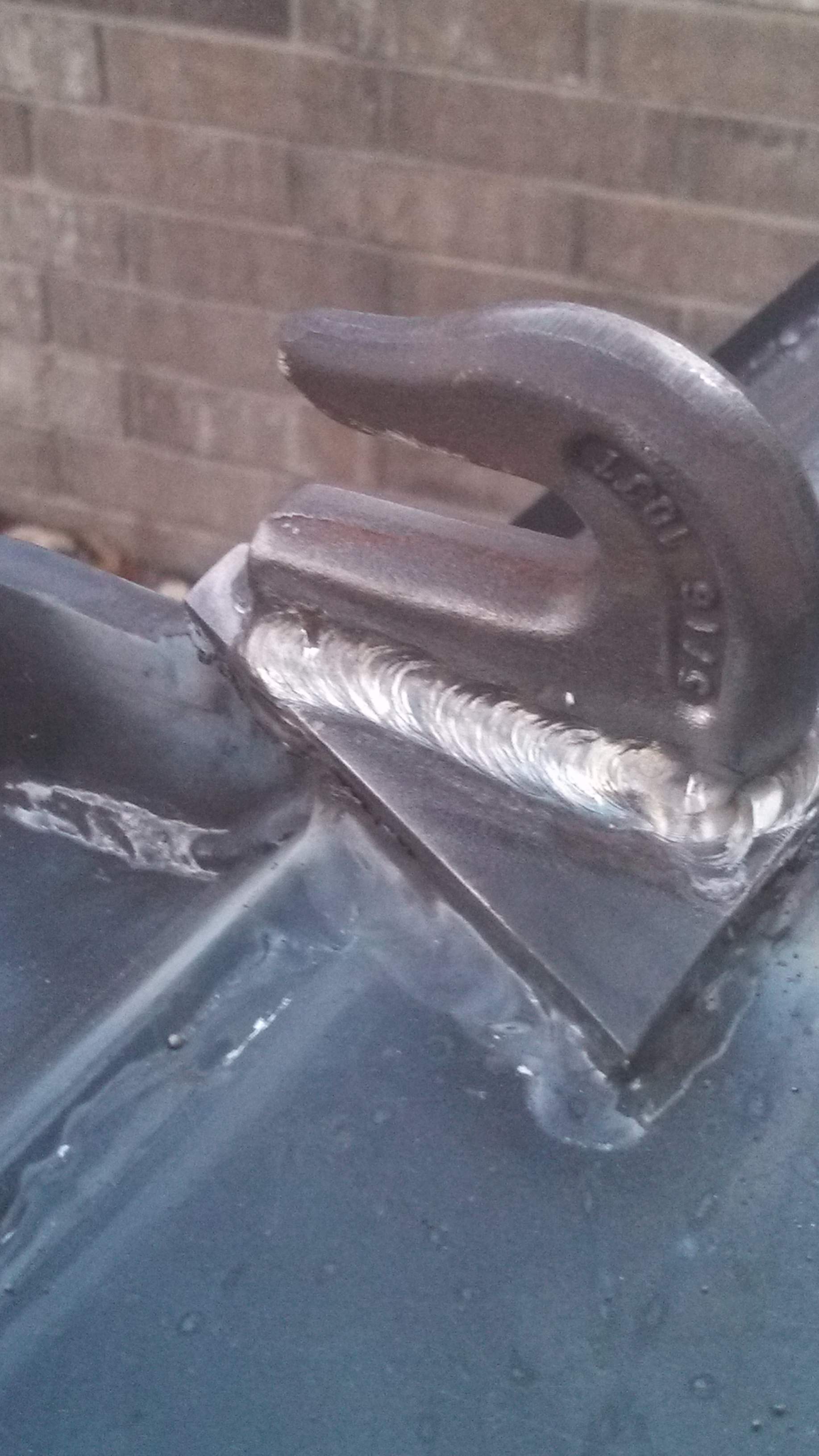

Here are some photos below of what my little 160 amp welder can do. If you wan to weld 1/8 inch material, I can't see why a 160 amp welder would not work for you. Below are stick and TIG projects done with the little PA160 Everlast
IMG_20121117_165336_859.jpgIMG_20131023_145811_920.jpgIMG_20131018_104229_173.jpgIMG_20131018_115507_563.jpgtig and ground.jpgIMG_20121117_165303_772.jpgDSCF0524.JPGDSCF0525.JPG6outside weld.jpg4outside prep.JPG5inside prep.jpgPicture 006.jpgPicture 007.jpgPicture 011.jpg
