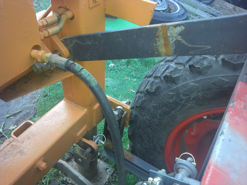

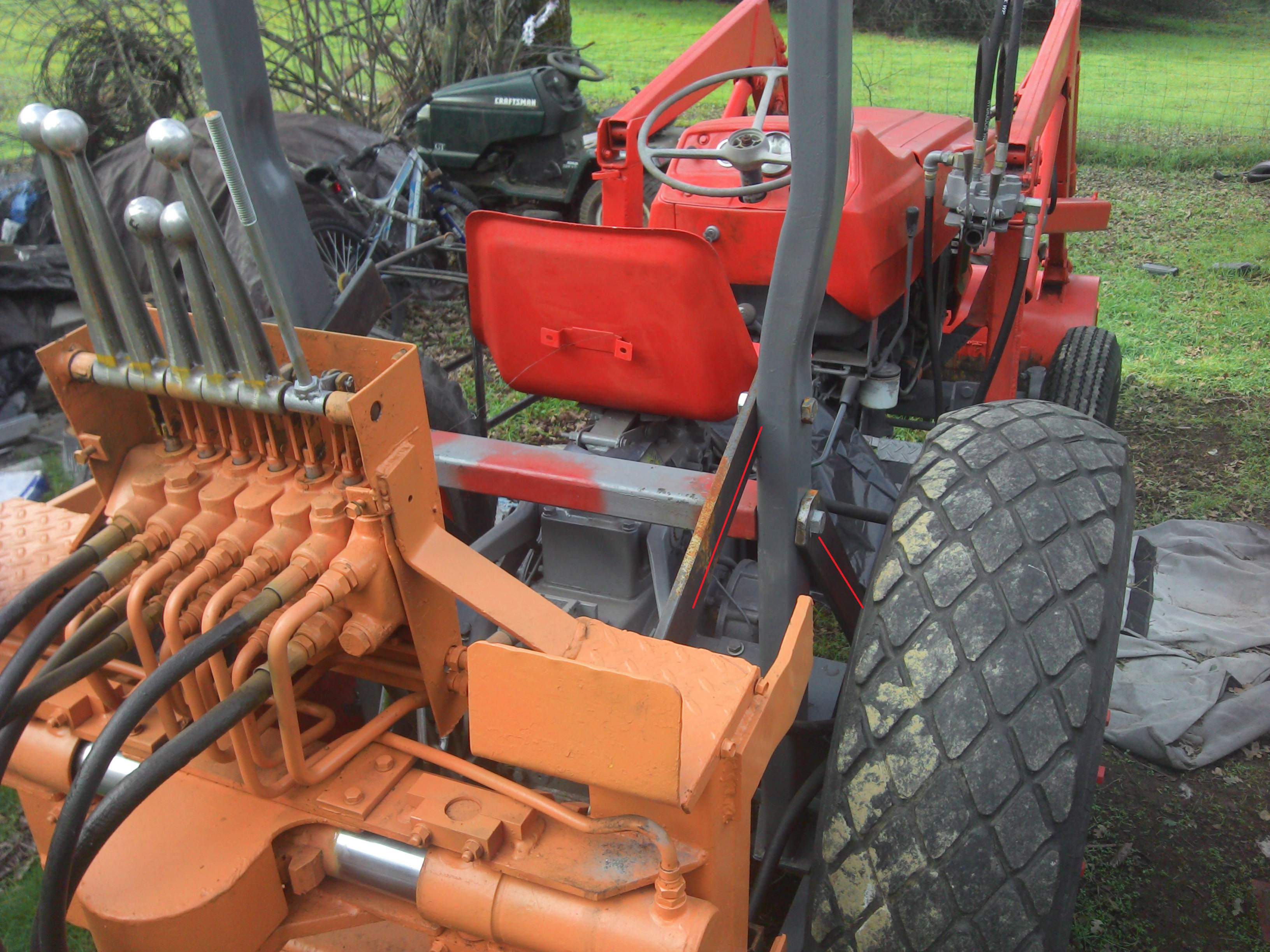

Bought a Davis or Case D100 4pt Backhoe off Craigslist for $800. It needed minor hydraulic repairs, but at the time I didn't know how much repair work would be needed. Later found it was just minor control valve leaks and the left/right ram had a leak. The minor repairs took some time but was very cheap and all I needed to do was to design and build a subframe to attach it to the Kubota L285.
For the hydraulics I had to repair the left/right ram which had a bad nick from sitting for years. It's a split ram design with a huge gear in the middle. I repaired the ram rod by soldering the nick and then carefully sanding (removing little to no chrome). I researched industrial epoxies, but the cost was prohibitive and I could not buy small quantities. This repair will last longer than most of the other rams and will protect the new seals. Needed to use a propane torch to get the ram hot enough. I replaced the o-ring and backing ring with a single C-cup seal (NOK 70mm ID, 80mm OD, 8mm thick or N86XX, IDI 70 80 8). This is an unloaded seal (meaning it has no spring liner). These can be obtained at most hydraulic repair places. The C-cup expands when pressurized and does a great job even on the repaired side. The wiper seal is National 310841 2.75" ID, 3.125" OD, 3/16" thick. I was able to read the numbers off the old wiper seal and it was an easy match.
For the control valve, I replaced the top seals and bottom o-ring of each control piston. The top seal is P125-.625 (5/8X7/8X1/8 inches loaded c-cup). The oring at the bottom is a 114. If doing this repair yourself make sure you buy at least 12 of each (2x) because you will destroy some trying to install- they are just tough to get into position.
In all the whole cost of the backhoe attachment is $1000 including the steel remnants. I also paid about $1500 for the tractor from the government because it needed some of the hydraulic lines replaced. They were quoted $100/line for 12 lines. I replaced the lines for about $100 with off the shelf parts from tractor supply.
So the whole deal is about $2500.
Stay tuned for details of the subframe.
[EDIT] Ram before soldering, will post pic after soldering in next update
Backhoe attached

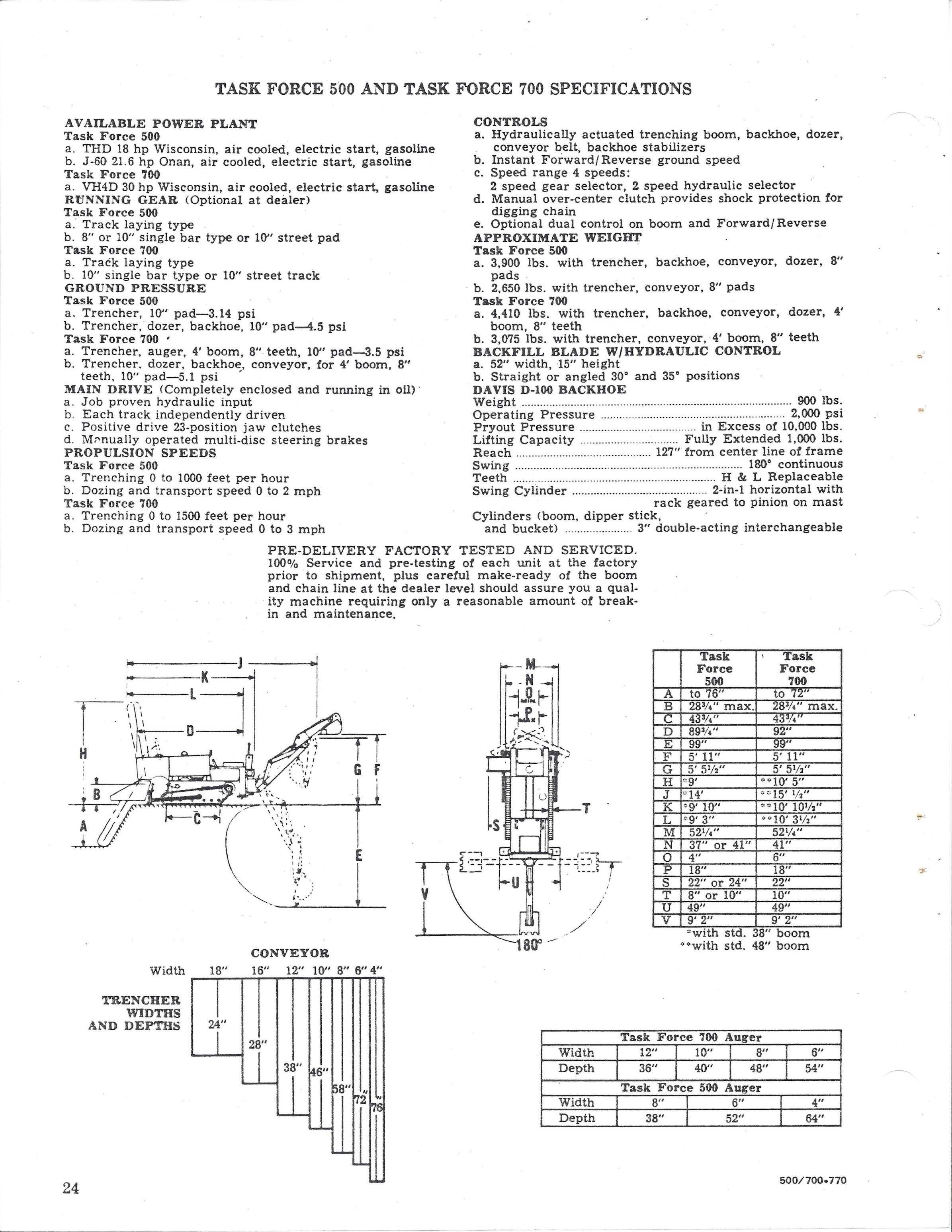

According to trencher manual, the hoe weighs 900lbs, plus I weighed it with out bucket, and my Chatillion scale showed 850lbs.
This has some good sized cylinders for a small backhoe, the bucket breakout shows 10k lbs according to trencher manual..
At 2000 PSI hydraulic pressure.. Should have a lot of digging power..

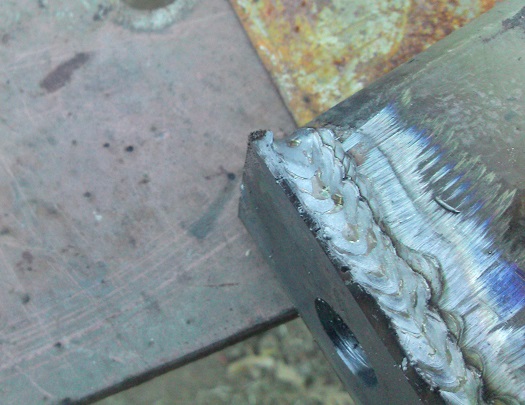

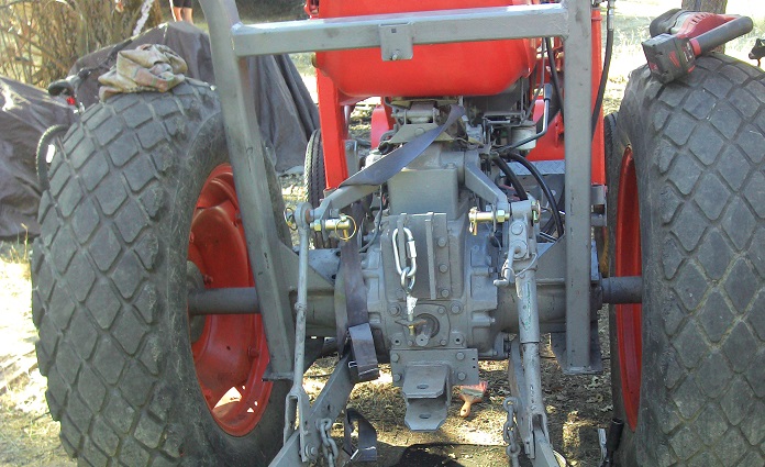

The ROPS cross member was too high, so I moved it down and integrated it into the design to be used as a place to put the seat and attach the struts. Then it can be moved back up to its original position to enable full upward swing of the 3pt when removed.

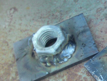

Welded 3/4" nuts onto the cap of the cross member
Welded the end caps to the cross member
After griding the edges of the end cap, the cross member is installed.
The bolt sticking out is used for the strut which connects to the upper attach points of the 4 pnt.
More to come...

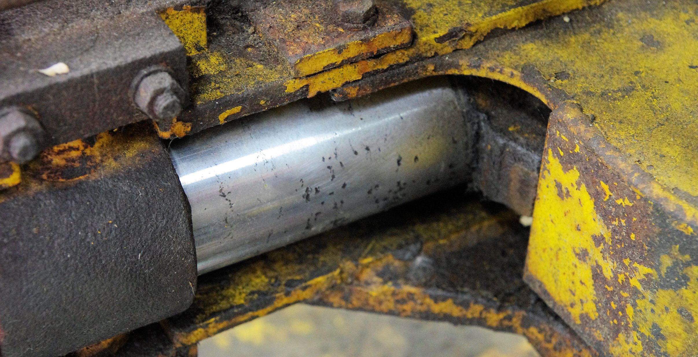

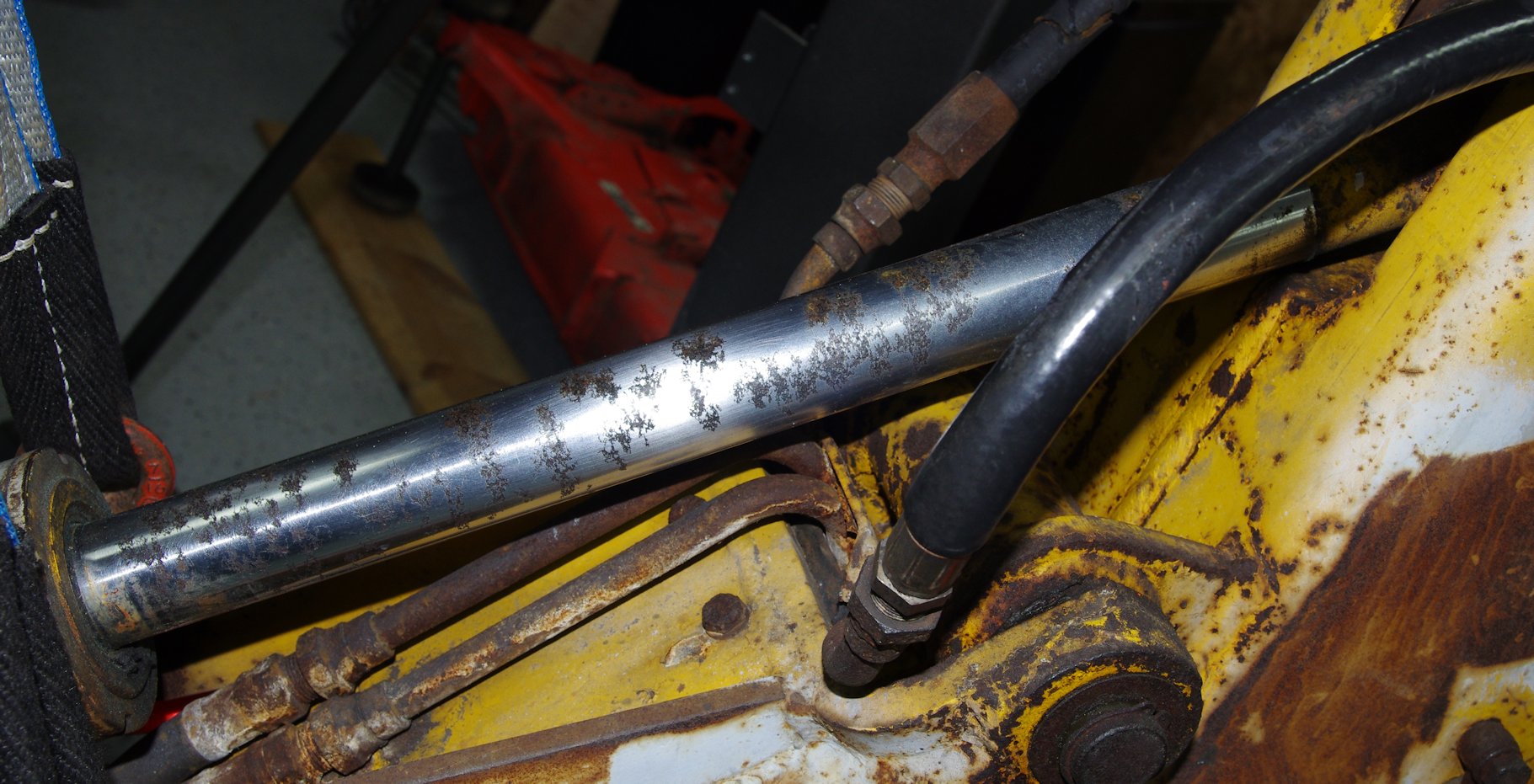

I have attached photos of my cylinders.. You can see how bad the boom one is, and pits on the swing arm cylinder..
Also picture of scale showing weight of D100, and scan of specs from manual.

Looks like the weather in upstate NY has not been kind to the rams. Pitting is what will cause the leaks, mine are near their end of life, but other than the swing arm ram which has been repaired, there is no actual pitting and everything is just superficial.
On yours it's hard to tell from the pictures as to the extent of pitting as I go by sense of feel anyway. But I suspect they're fairly rough and you'd be soon replacing the seals again.

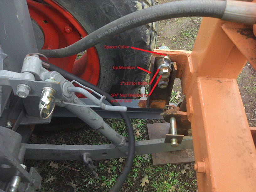

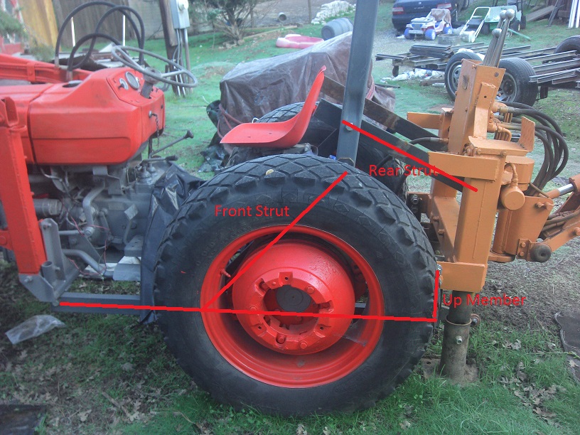

Thanks for your interest. The design is very robust and it lacks a few finishing touches such as paint and a finishing the length cuts on rear struts. I designed it very close to the rear wheels and designed it to co-exist with the 3pt (without removing the subframe). I also wanted to make it fast and easy to install without sacrificing the rigidity.

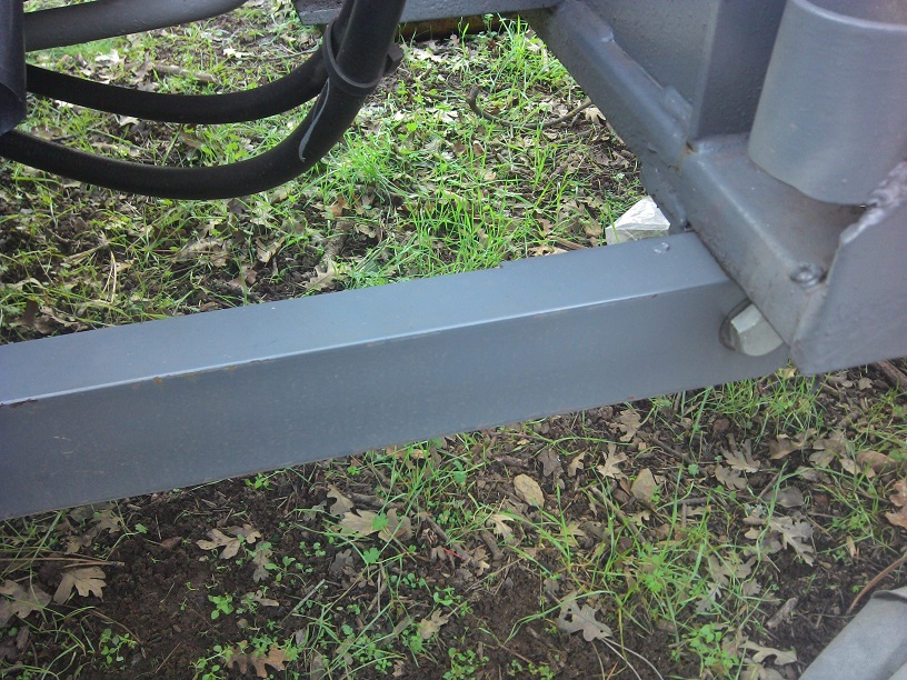

The design concept is simple. It wraps around the axle and is not merely attached to the bottom of the axle. The wrap around design transfers the load to the subframe between the tractor axles in the subframe. The tilting action of the hoe forces the rear strut to pull on the front strut transferring the load to the middle of the tractor. This could also be done without the ROPS by just connecting the front and rear struts to each other, but the ROPS was there and I used it for convenience.
Alternate view of struts. 1/2" thick 3" wide.

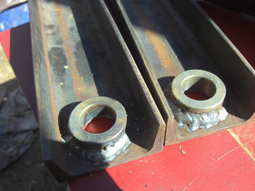

Up Members with first collar (later will be cut to accept a 1" bolt during initial alignment)
Up Member welded to subframe
Subframe is bolted to the bottom of the axle along with the ROPS, then a clamp is used to hold the subframe to the ROPS (belt and suspenders approach)
Bolted up at the bottom showing the up member. Note that during installation only the top bolt of the bottom attach point is installed and it slips into the collar of the up member. Also note that 3/4" nuts are welded to the head of the 1" bolts so only 1 socket (and 1 wrench to hold) is needed to do the installation.
Rear strut connected to the upper attach point of the 4pt. Also uses 3/4" nut welded to head of 1" bolt
Subframe connected to front end loader crossmember
Thanks for looking,
Tim
