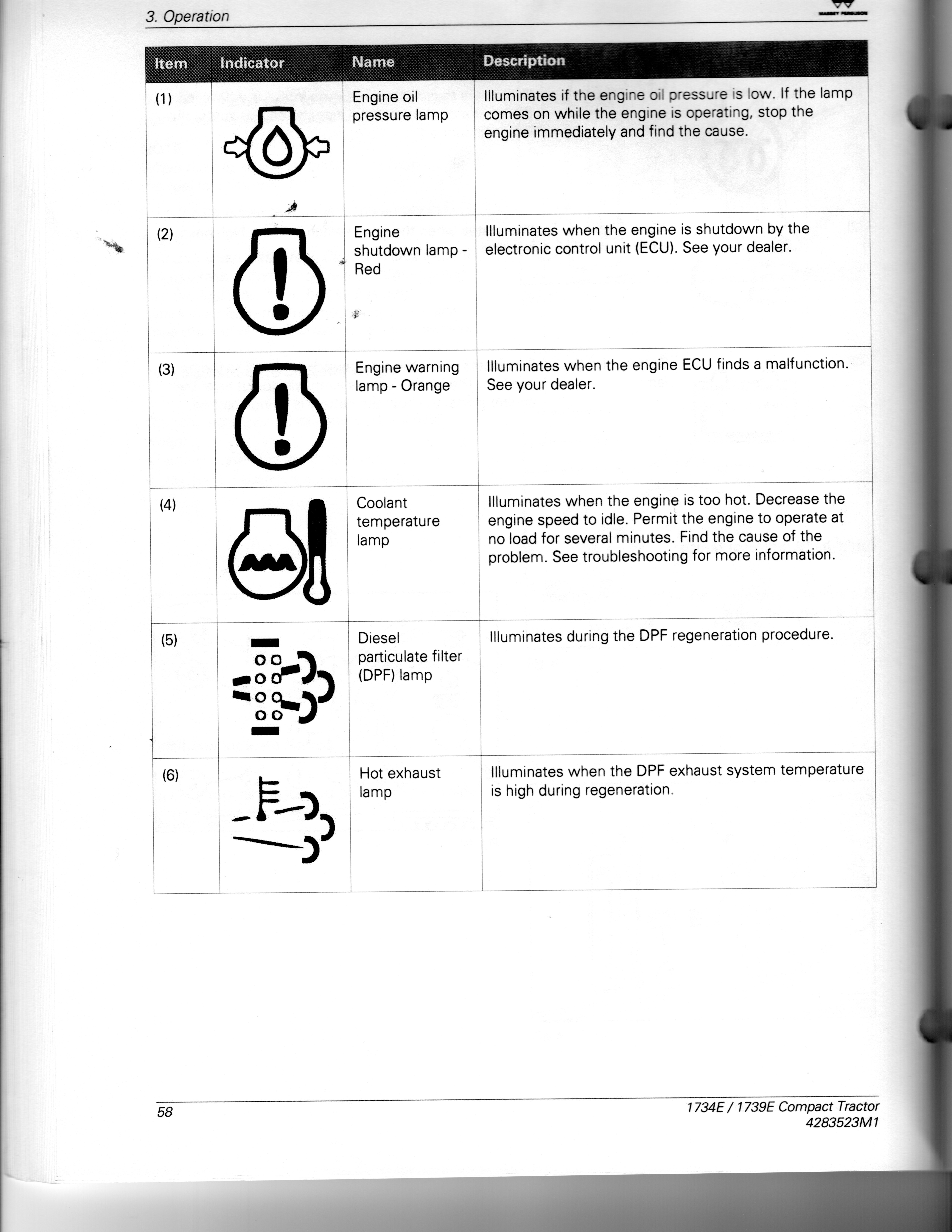

Hello guys, yesterday I got my first tractor from a dealer in Western PA. It showed up with a whole 3.1hrs on it and there is 2 warning lights currently on. I have tried looking through the owners manual as much as I could because it wasn't put in the toolbox, in a bag instead. It is ruined and the dealer and AGCO refuse to give us a new manual even though it was the dealers fault. If any of you have a 1700 series machine and would be willing to post the diagram of lights on page 59 so I can figure those lights out, I would appreciate it very much. Thanks guys!

I have the owners manual plus a page out of the service manual from the dealer. I will get it copied and send it to you via pm later today. As I recall the owners manual is not very expensive but the service manuals are a completely different story.
