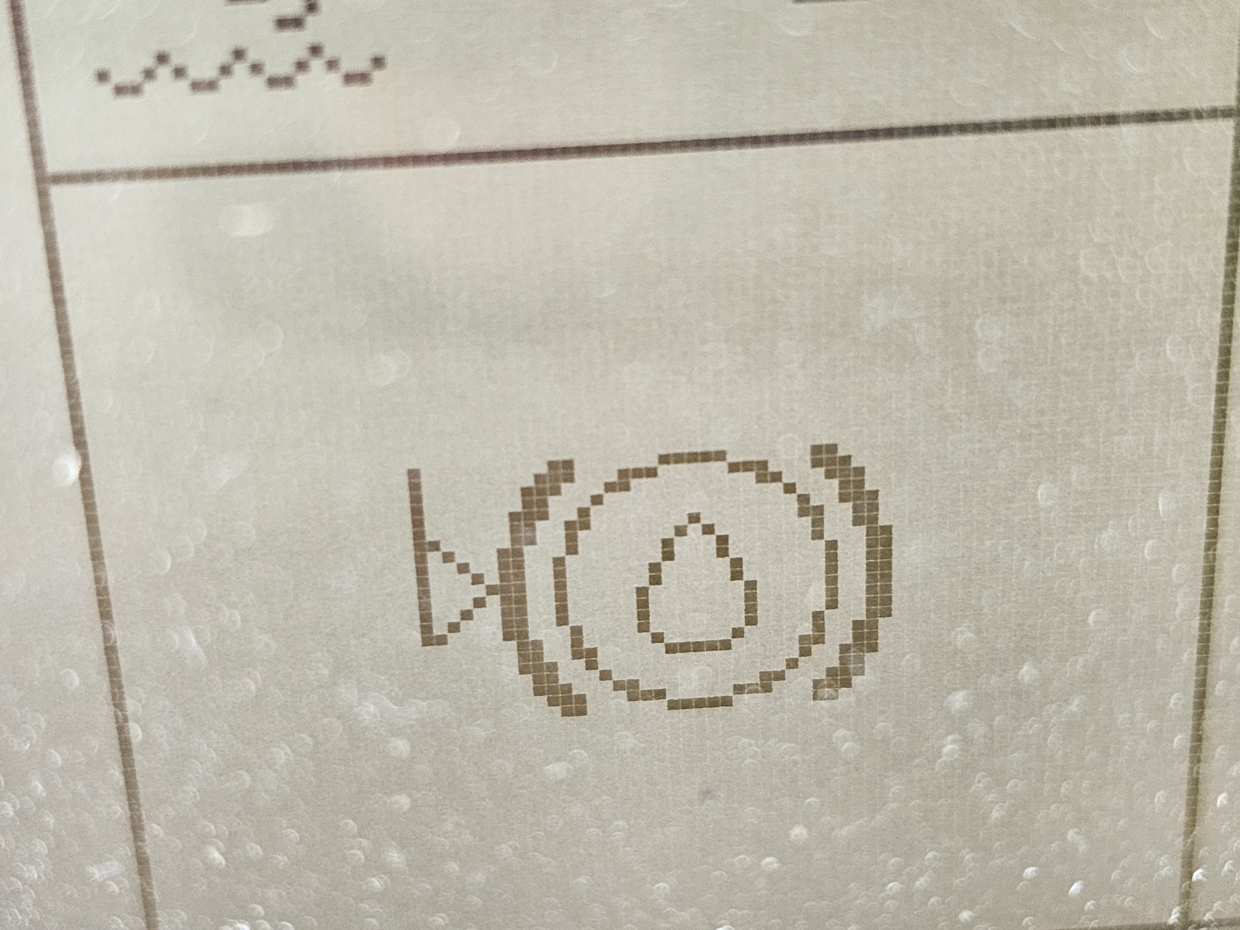

New Holland Workmaster 105
Anyone know what this symbol is.
   / Dash symbol #2
NH doesn't seem to publish the Workmaster 105 manual on their site, but looking at the manuals they have there for the other Workmaster, the closest I could find was hydraulic oil pressure warning light.
The droplet symbol is always going to be a fluid, and usually oil. I'm not sure what the inverted flag on the left side of the symbol is supposed to be. Hopefully it's not your oil pressure warning, but you'd think that'd be red and accompanied with some other more obvious indicators.
I'd start checking all dipsticks. :)
   / Dash symbol #3
Oh, and if you register on their site, you can probably download the WM 105 manual. I didn't want to bother, I don't have an NH tractor.
   / Dash symbol #5
That makes sense.
<-- has never had a tractor large enough to have hydraulic brakes! :oops:
   / Dash symbol
Thank y'all for the help. Ill start checking dipsticks.
