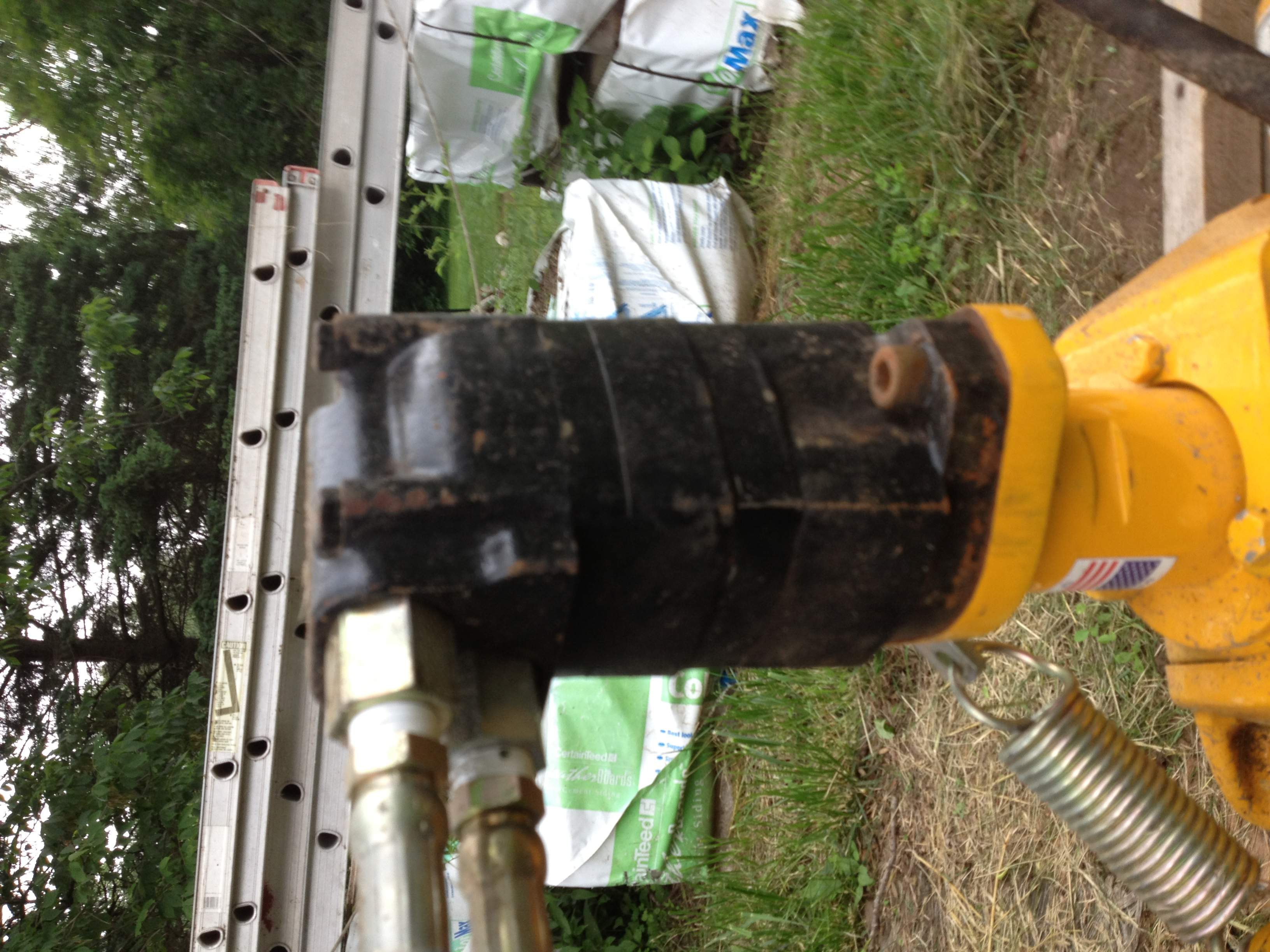

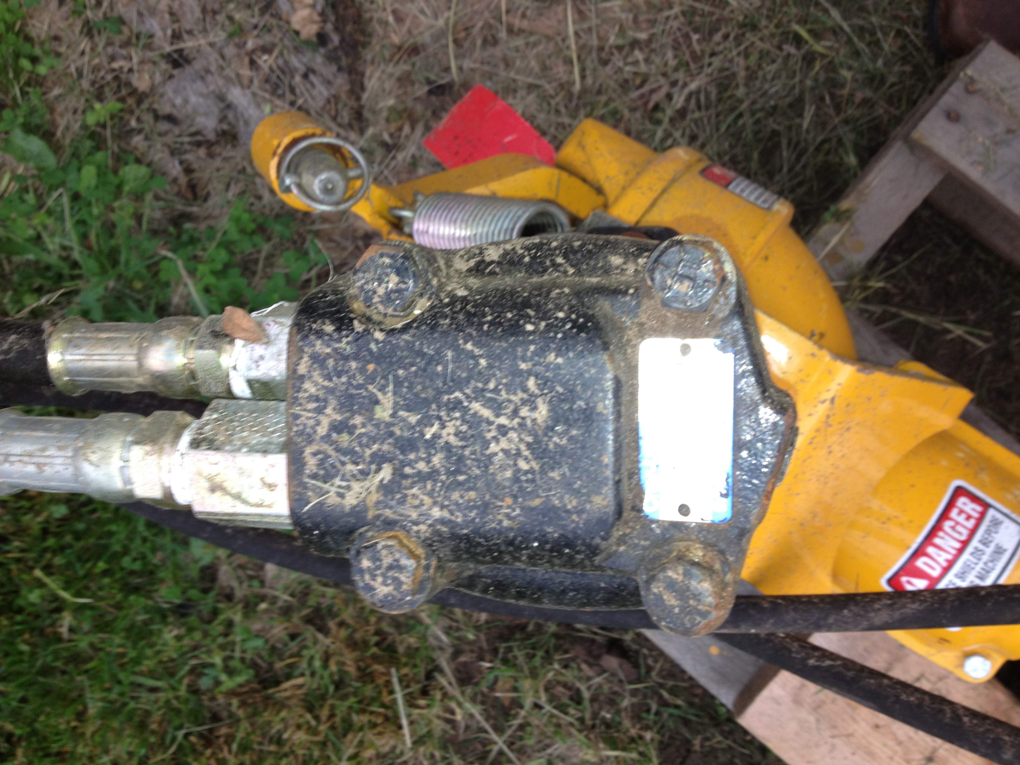

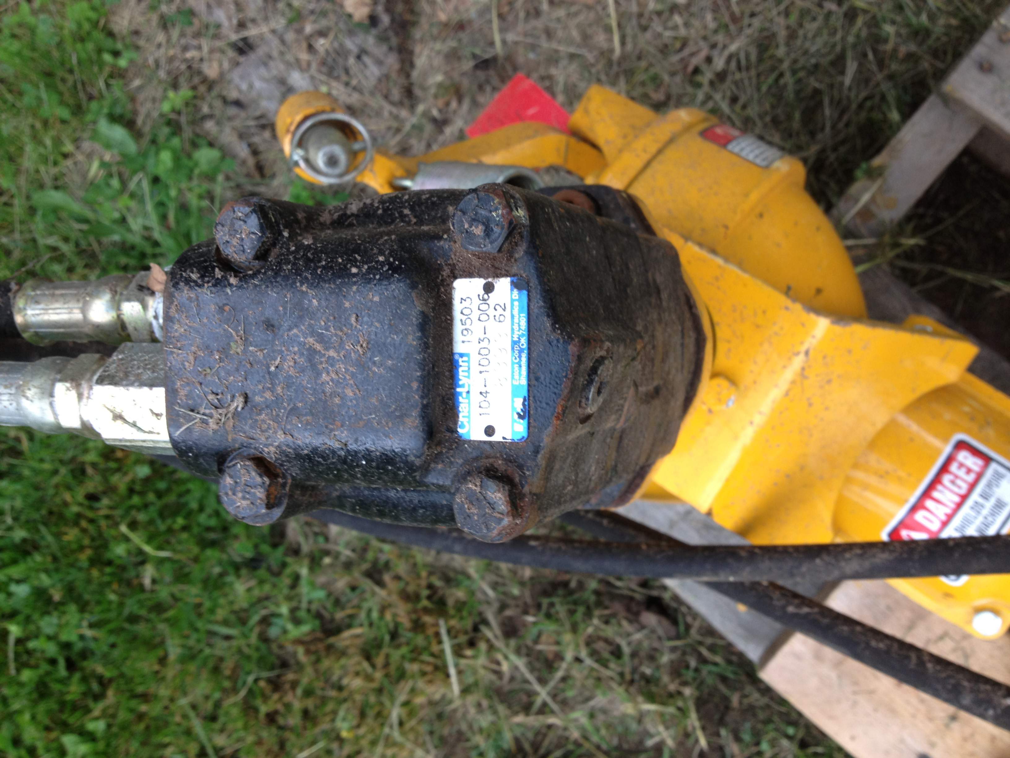

Fisherridge, Attached are a couple of photos of the motor. As I understand it, if you swap down, you will get more speed but less torque. If this is what you want, might you be interested in a swap? my unit has deilled in 16 fence posts since it was brand new but my soil is rocky and the torque is of interest to me.

Sorry, this is the one without the flash.
