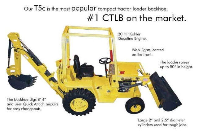

need tie rods for a t5c

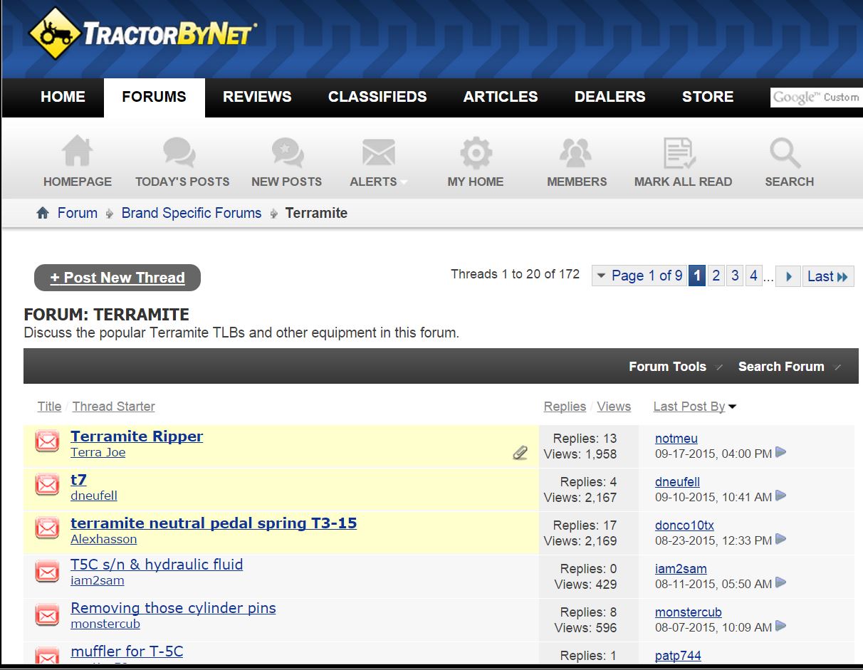

If this is what you have, there is a forum here for Terramite, click this link: http://www.tractorbynet.com/forums/terramite/

Okay... Here is a correction to my post above. After speaking with Paul at Terramite, the NAPA tie rod number I reference above is for 1996 and newer T5C's. My machine is a 1993 model. The NAPA tie rod number is 269-2116. This number fits 1962 Ford Falcons (all models). This is helpful if you want to shop one of the automotive sites for a better price (e.g. Rock Auto). This is the tie rod with the funny bend in it that appears to look incorrect when installed. But, Paul says it is the correct tie rod for earlier models of the T5C. Hope this helps.
