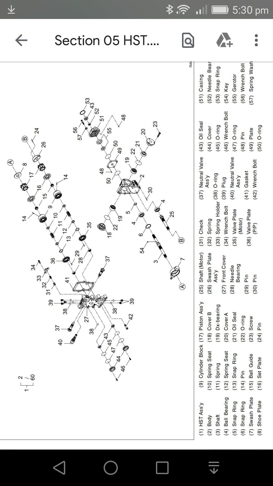

Hi Folks,
I've got a mystery.
There is a leak out the bottom between the bell housing and HST gearbox. There is a void where the 4WD shaft comes out the gearbox. I have changed the gasket and seals everywhere in that void and it still leaks somewhere.
Any help would be great. Thanks.
   / Daedong CK35 Leak
#2
Update. In the Front Plate (27) There are two grub screws. They were lose.
I dusted some talcum powder over the plate, put the tractor together and ran it. The powder showed where the leak came from.
I never would have guessed.
