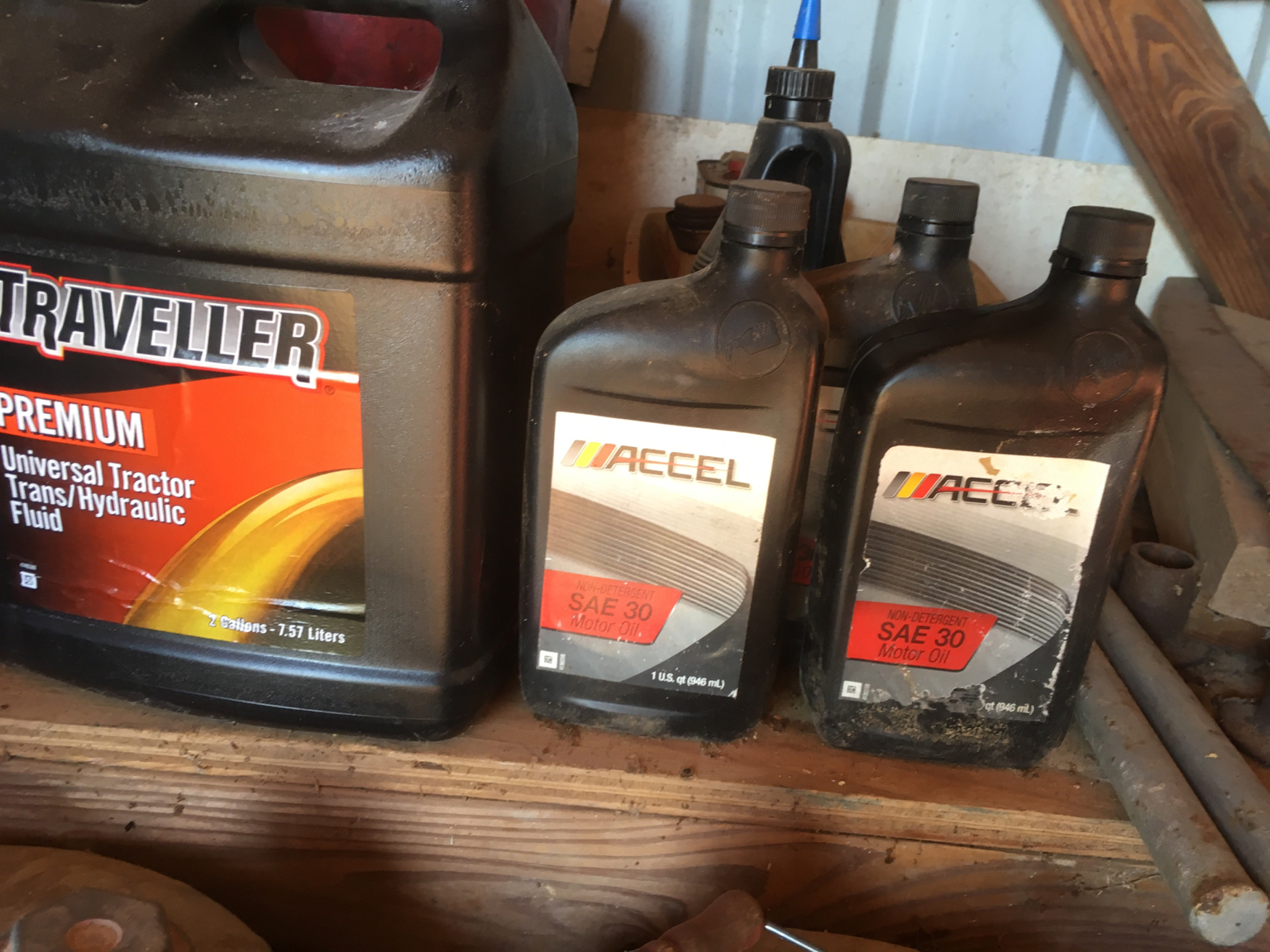

   / Dad’s Ford 3610 he couldn’t tell me #5
That looks like it. Look on the back under Ford. It should list 134a, b, c
I will, thanks.
